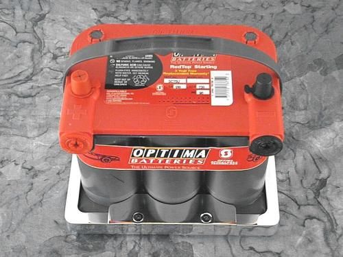

And an aluminum battery hold down:
http://i34.photobucket.com/albums/d1...d_7525_500.jpg

Who makes the battery hold down that you are going with?
Rybar 01-24-2013 04:40 PM
Thanks guys,
Tony, I got it from this ebay store: http://stores.ebay.com/Boese-Engineering

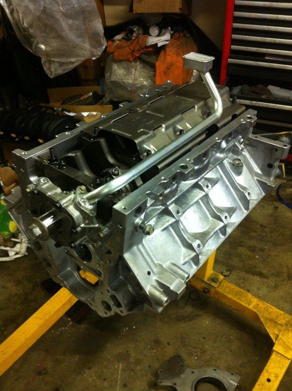

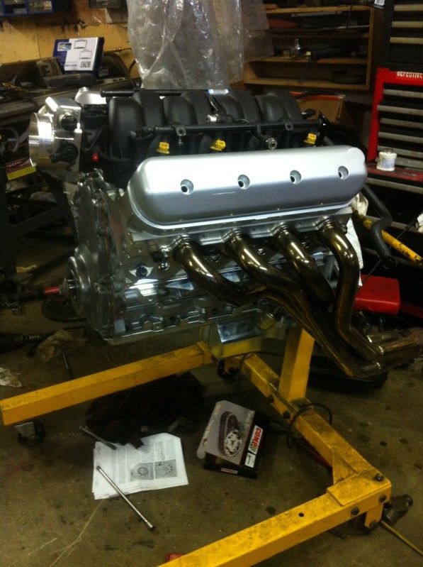

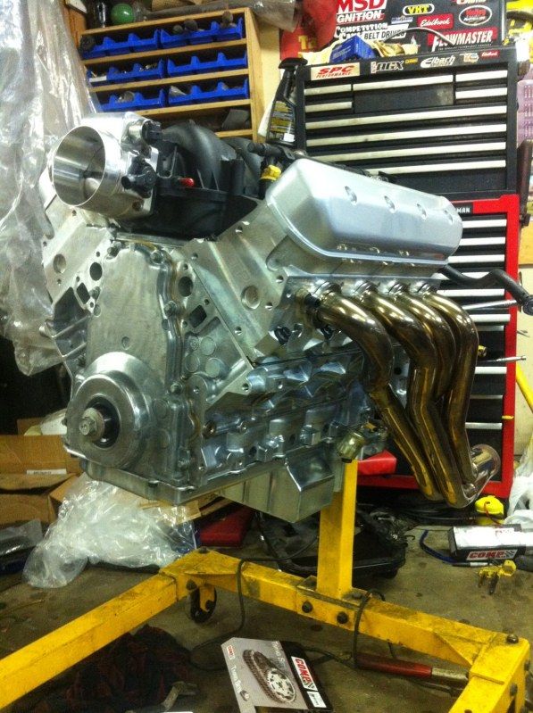

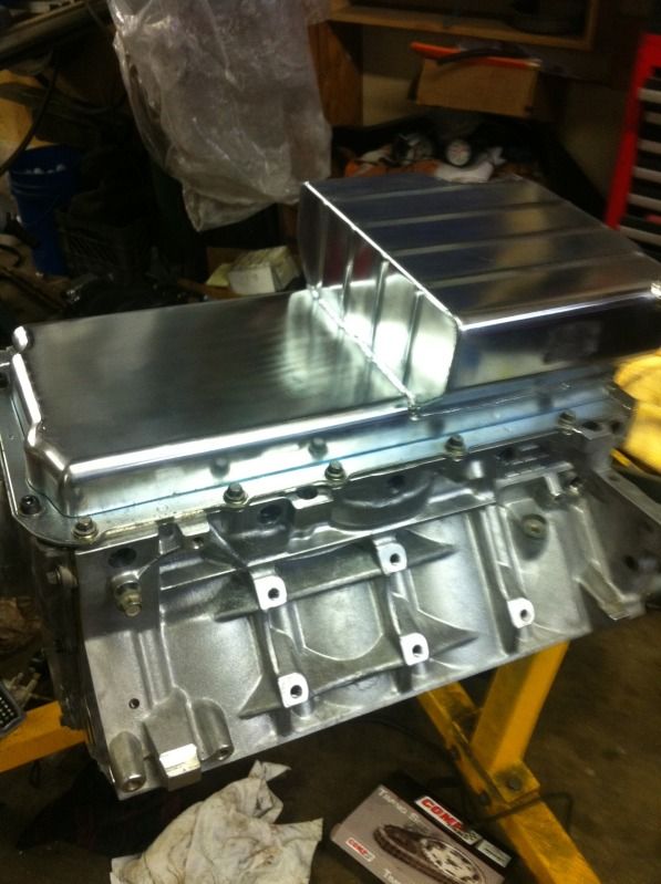

Here's some shots of the new HKE 383 bottom end getting my old ET 215 heads, Fast 90/90 top end, Autokraft oil pan going on as well as the new Katech valve covers.
http://i34.photobucket.com/albums/d1...bottomside.jpg
http://i34.photobucket.com/albums/d1...0383/383-2.jpg
http://i34.photobucket.com/albums/d1...83/engine1.jpg
http://i34.photobucket.com/albums/d1...83/engine2.jpg

Yep, looks good Ryan. :thumbsup: What rotating assembly are you gonna use?
Rybar 01-28-2013 08:45 PM
Thanks guys, Marcus, here are details of the HKE 383 shortblock which I purchased assembled:
Brand New LS1 Alum Block.
11.8:1 cr with 60cc Heads
LS6 383 Callies C-Series LS1 4.000 Crankshaft 24 tooth
Scat 4340 LS1 I-Beam 6.125 (.015 offset) Part # 2-ICR6125-7/16
Wiseco K464F3903 LS1 3cc Pistons 3.905 Bore 391g each
1/16,1/16,3.0 mm Rings 1.115 Comp. Height
Wiseco GFX Piston Rings
ACL 5M7298H Main Bearings for LSX - Race Bearings
ACL CB 663 H Rod Bearings for 2.100 SBC Chamfered Race Bearings Coated
234-5608 ARP Main Studs for LS1
And the rest of the motors details:
ETP 215 heads, 60 cc chambers, dual valve springs
EPS 235/242 .638/.615 113 LSA spec'd by Patrick G
GM MLS .054 Head Gaskets
Trend 8.07" .125 wall thickness pushrods
Harland Sharp rebuilt stock rockers
Comp OE 850-16 lifters
Tony Mamo Ported Fast 90 Intake
NW 90mm TB
36# Accel injectors
ARP head bolts, cam, oil pan, crank and flywheel bolts
Stainless Works 1-3/4" polished LT headers for stock steering
TSP ported LS6 oil pump
Comp adjustable timing chain
ASP underdrive pulley kit (crank & alt)
stock MAF
3.5" custom cold air intake
Autokraft Swap Oil Pan
AC Delete
Katech valve covers

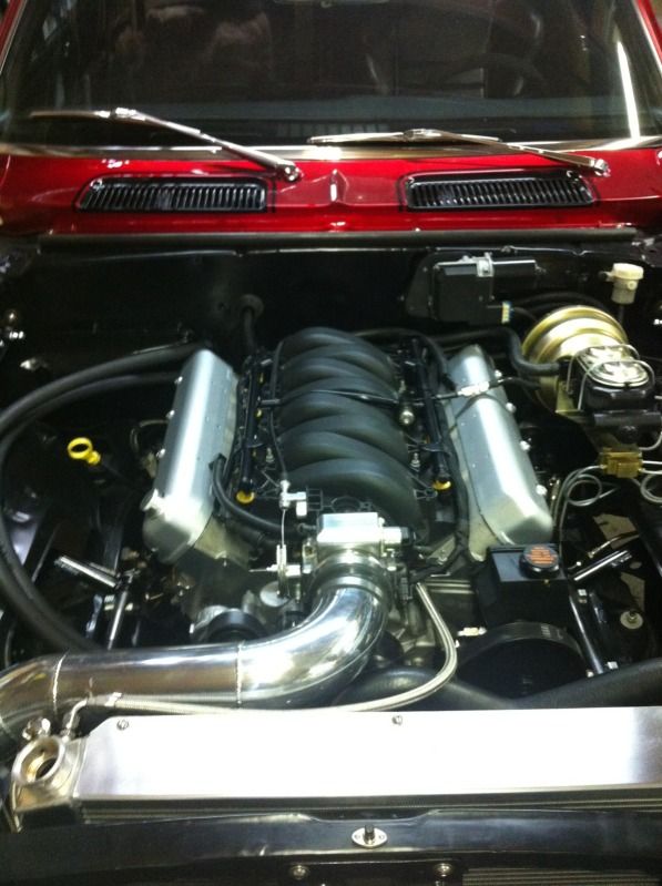

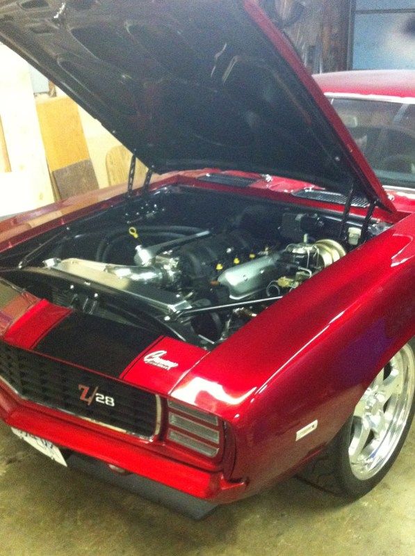

Rybar 03-07-2013 03:02 PM
Couple pics as it's almost ready to go:
Kind of had a long laundry list of crap to fix and do. Also, to any people building one of these cars using or planning to use the stock heater. Please ditch the idea now and throw it in the garbage. It's a POS system that is bulky and doesn't work very well. I so wish I smoothed the firewall and installed a Vintage air unit.
http://i34.photobucket.com/albums/d1...psf1204520.jpg
http://i34.photobucket.com/albums/d1...psb7e1c2c3.jpg
