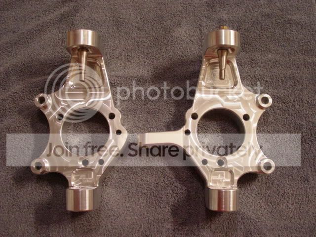

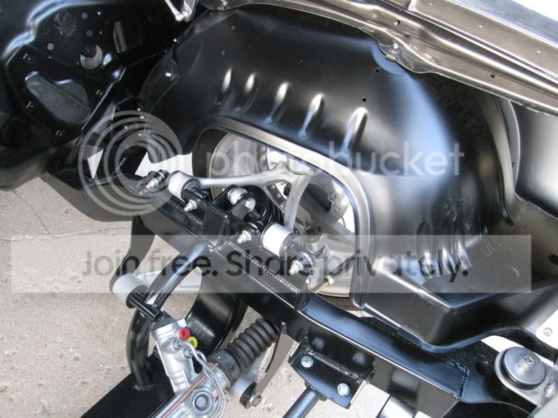

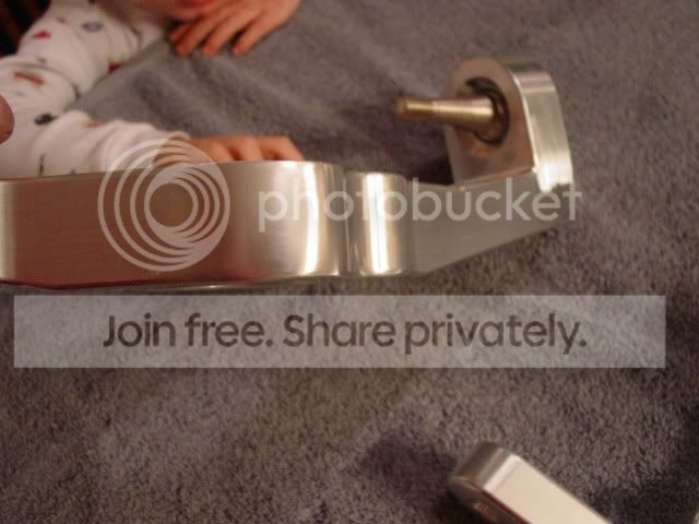

Obviously blasting and powder coating was done. But the real fun was when those high dolar billet spindles showed up and I started cutting on them:_paranoid Now I will admit....this was much easier to do since I didnt pay for them, but was still tough! Anyone that hasnt had there hands on these and are on the fence.... They are nice!! Anyway, I spent several hours cutting the steering arms off and multiple steps to get the cut areas highly polished as you see them. I also had to enlarge some mounting holes for the new steering arms I had fabed up.
Since the spindle is a 1" drop, the original steering arms obviously wouldnt work anymore. The steerings arms are billet steel that I had to have done at two facilities. I had them cad designed...then the profile cut on a waterjet. The other dimension was then cut on a mill. The waterjet was much cheaper in comparison and cut down on some of the costs the machine shop wanted to charge me to mill the whole thing. The machine shop also made a tapered reamer to do the hole for the tie rod end. Result.... The tie rods are in the EXACT same spot as AME had them and they look great! I can have more of these made if needed, probably cheaper as well. (now that all the hard work is done at Rons expense :hail: ) I can also have them made for the stock height C6 spindle if needed.
The pfadt bushings were a real treat to install... I had never installed bushings in C6 arms before. I have some tricks for that now if needed. I did use a press. I do like these bushings and they will eliminate a ton of flex!
The Howe lower ball joints are really sweet.... They are rebuildable and a sweet piece! They dont come with dust boots, we had to get some from energy suspension. Had to also install some washers to get the castle nut to engage the cotter key hole properly. The upper ball joints are REALLY sweet! No grease, no slope.... they are NICE!
I had to weld in new brackets for the new HD sway bar Ron ordered. The mounting location was not the same as the one that came with the frame. This sway bar is also a sweet addition to the chassis.... I like the adjustability!!
It took some time and thought but was well worth it! I really enjoyed doing this subframe! Thanks to Ron for trusting me to take charge on this:thumbsup:

And that, fellas, is how it's done. Did I trust Trav to cut on those pretty spindles? You bet. Did it scare the crap outta me? Absolutely! And don't think I wasn't a pain in the ** about it. Thank you Trav for putting up w my 'engineering chage orders' and project management skills...:lol:
There is one thing though. Trav said he did all the work and they sure came out pretty --
http://i885.photobucket.com/albums/a...pindles003.jpg
...but I have evidence that he did NOT do the work, at least not by himself --
http://i885.photobucket.com/albums/a...pindles005.jpg
