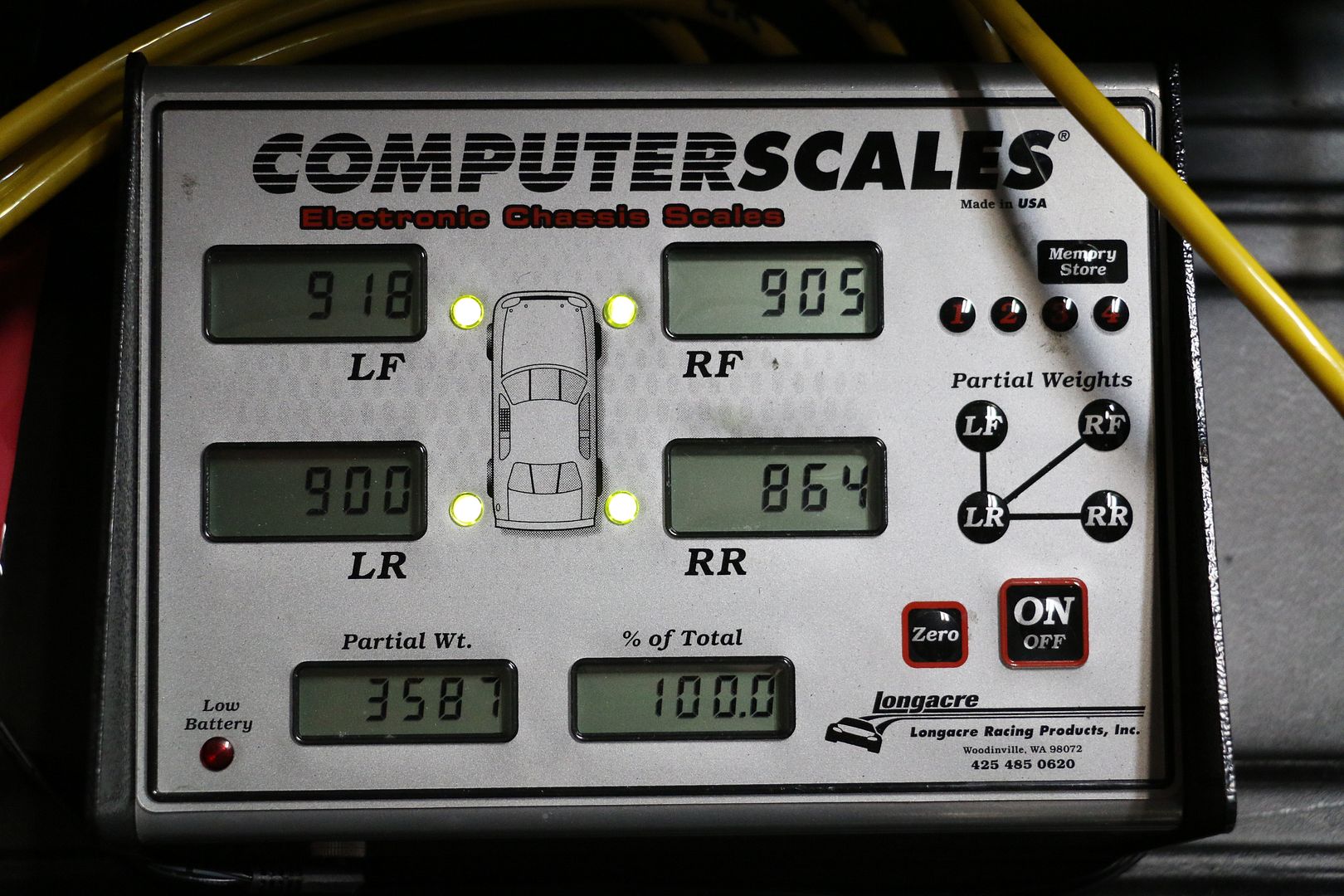

I got the car back recently from TCI. While at their shop they made some changes to the Camaro Subframe and Torque arm setup to bring up to their current specs. I'm now able to stuff my R888 275 front tire with 6* of caster and -1* of camber with full turning radius!
With the updates to the suspension done it was time to focus on tuning the suspension for track day fun! The first step was upgrading to the Ridetech triple adjustable coil over shocks on all four corners. The car was then corner weighted and final ride height set, which you can see in this pic.
http://carphotos.cardomain.com/image...3/19063232.jpg
The front ended up in about the same place and the rear was raised slightly. The Ridetech shocks plus ride height adjustments completely transformed the car. With my old coil overs even at soft setting the car was still very stiff feeling for regular street driving and rough pavement transitions or bumps in the pavement were very unpleasant. Now even with the shocks tuned for baseline track setting the car is awesome on the street.
I left the spec sheet at home but I will post up my corner weights when I get a chance.

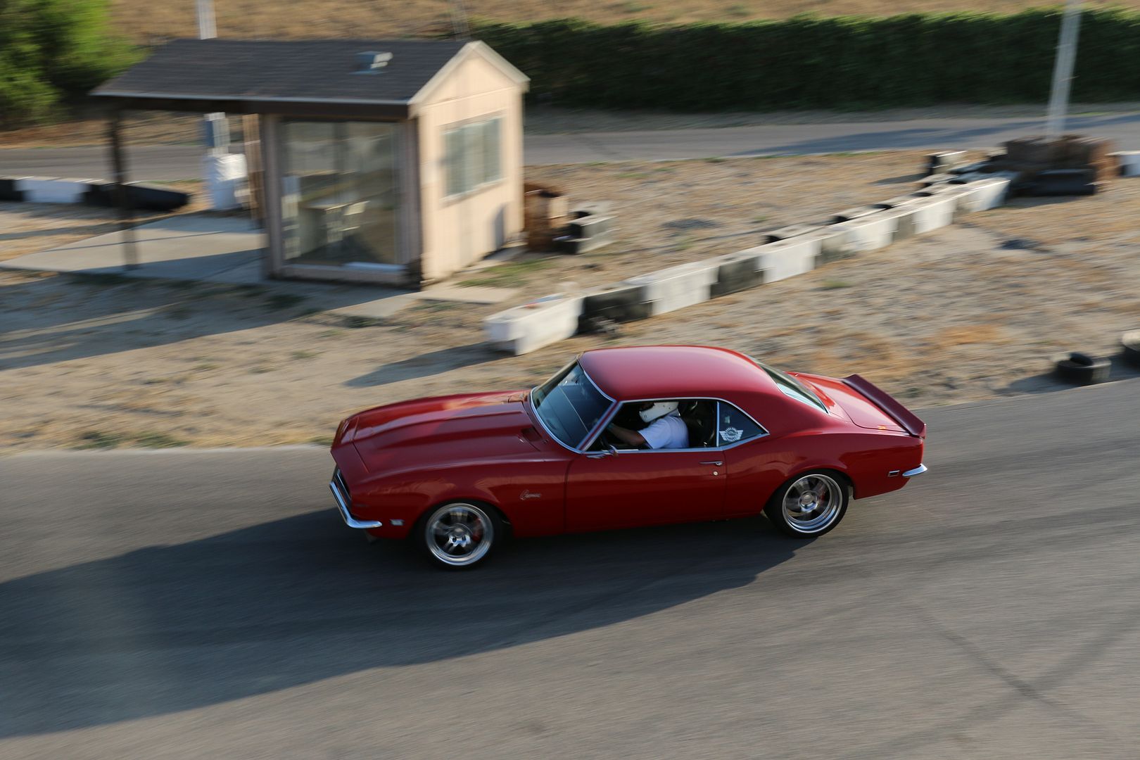

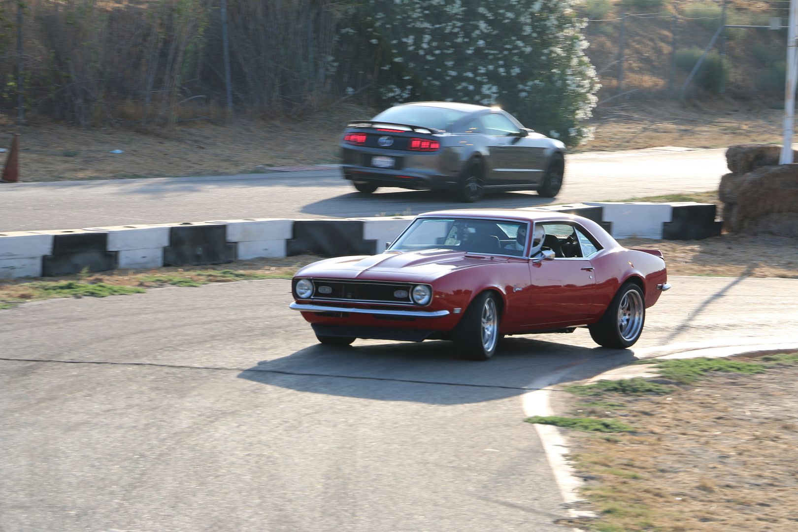

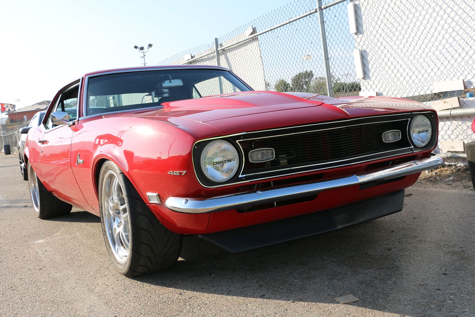

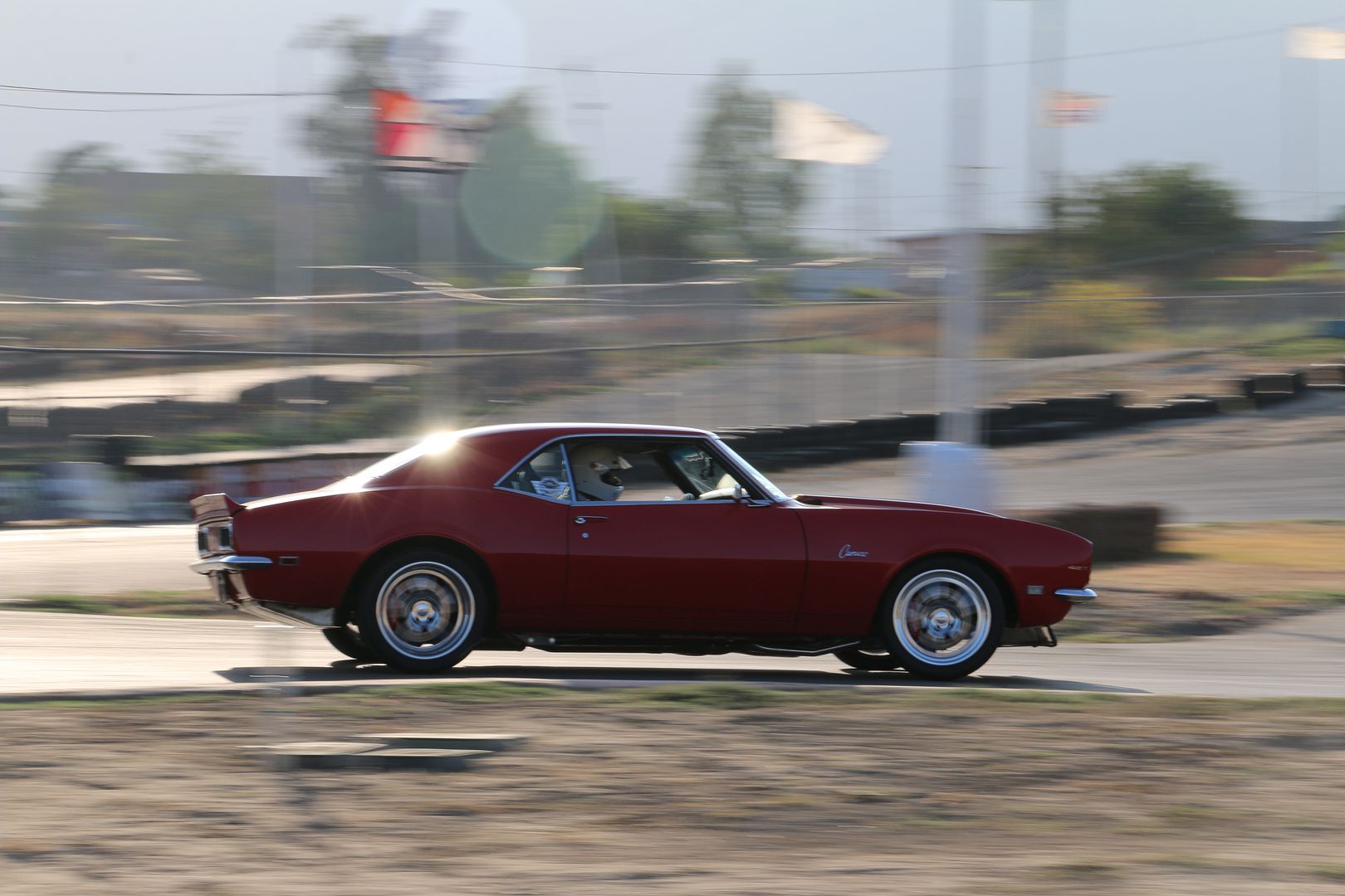

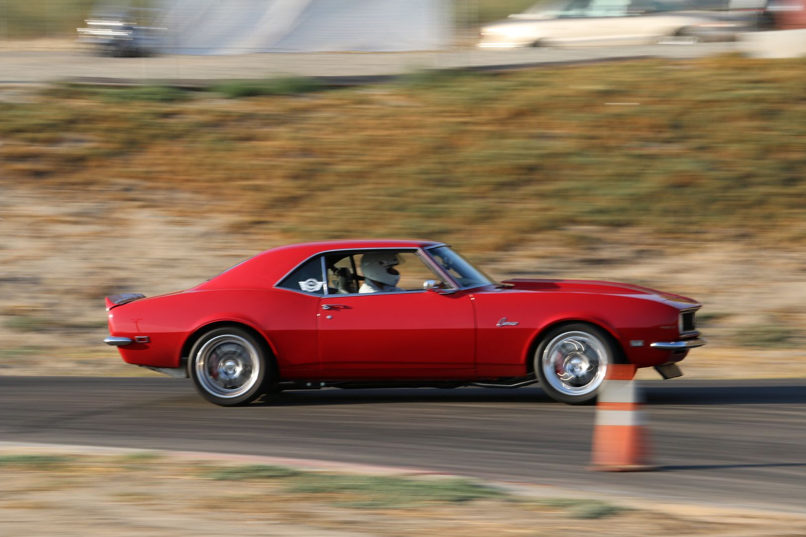

slow4dr 07-16-2014 12:32 PM
It was great seeing the Camaro out there last night Chad! I see the dialogue is already opened up with Sal so hopefully we can go back out next Tuesday.
http://i981.photobucket.com/albums/a...psde45fe4f.jpg
http://i981.photobucket.com/albums/a...ps9c78d863.jpg
http://i981.photobucket.com/albums/a...ps4e4b420d.jpg
http://i981.photobucket.com/albums/a...psea816134.jpg
http://i981.photobucket.com/albums/a...ps25d8e5db.jpg
http://i981.photobucket.com/albums/a...ps8d6e7911.jpg
http://i981.photobucket.com/albums/a...ps346293d9.jpg
http://i981.photobucket.com/albums/a...ps89995531.jpg
http://i981.photobucket.com/albums/a...ps565b3a35.jpg
http://i981.photobucket.com/albums/a...ps3a511974.jpg
-J

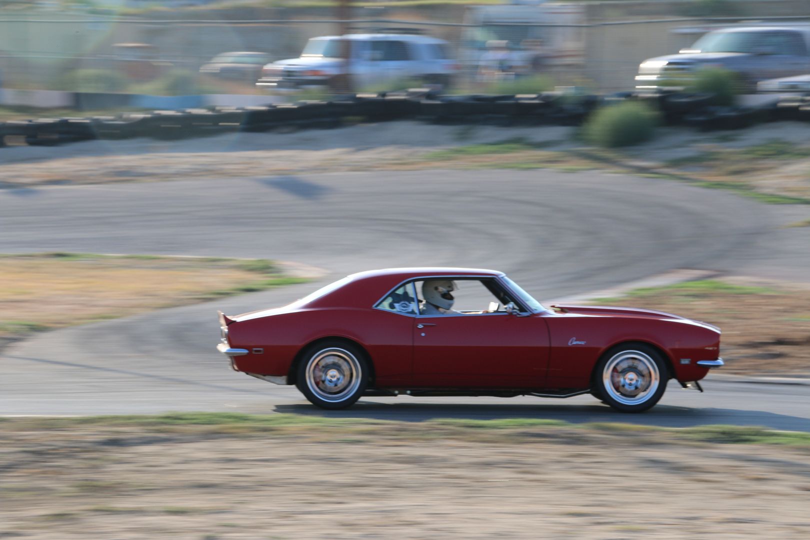

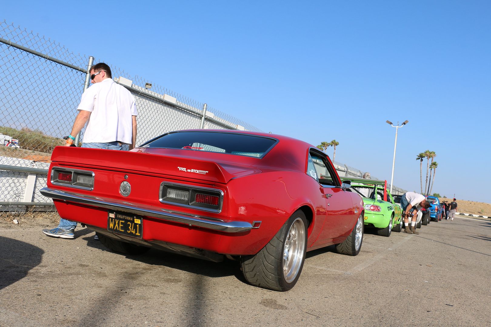

Chad-1stGen 08-29-2014 09:49 AM
Here are a couple of fun teaser pics from a trip out to Streets of Willow Springs earlier this week for the Super Chevy Handling Challenge.
https://fbcdn-sphotos-a-a.akamaihd.n...50207456_n.jpg
http://photos-e.ak.instagram.com/hph...37493839_n.jpg
http://scontent-b-sea.cdninstagram.c...48805835_n.jpg
I like the middle pic with both Streets and Big Willow in the background :)
