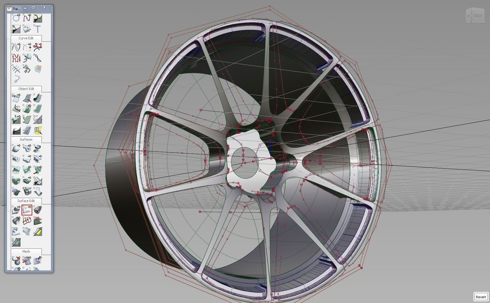

Regarding Dan's attention to detail, he is replicating the Forgeline in CAD! I thought the prelims were already incredible!
http://i1231.photobucket.com/albums/...psabf67782.jpg
Should have the final by tomorrow!

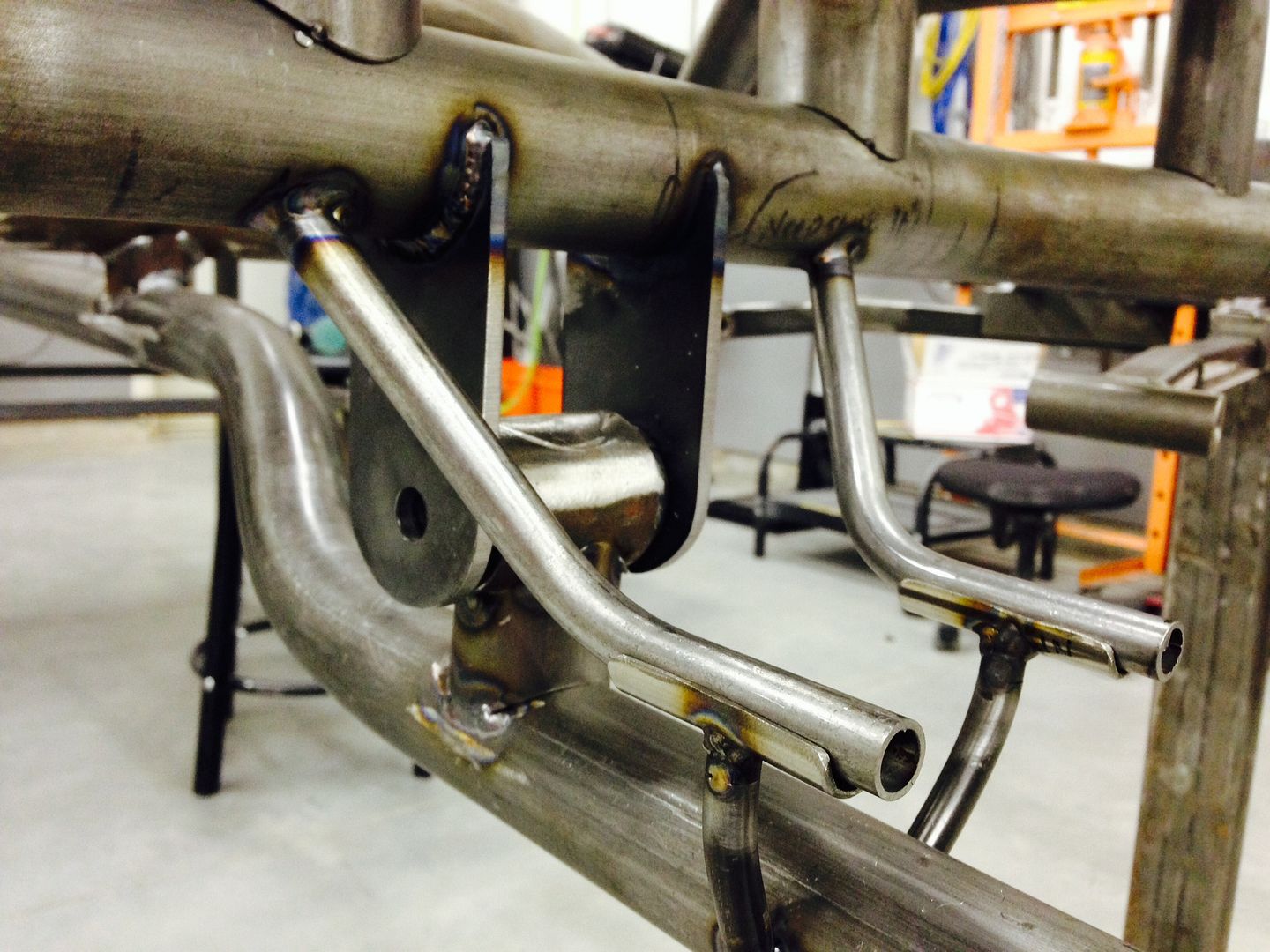

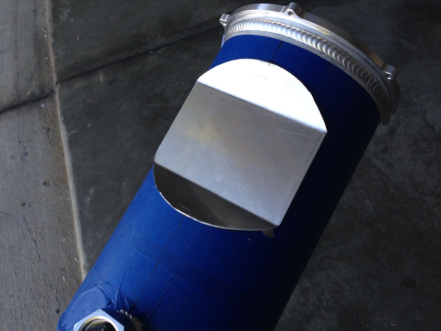

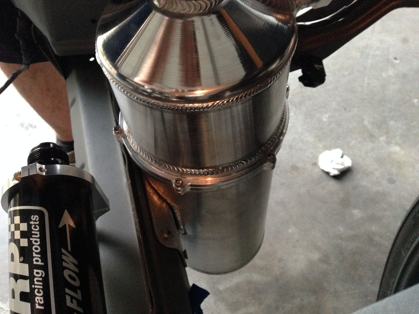

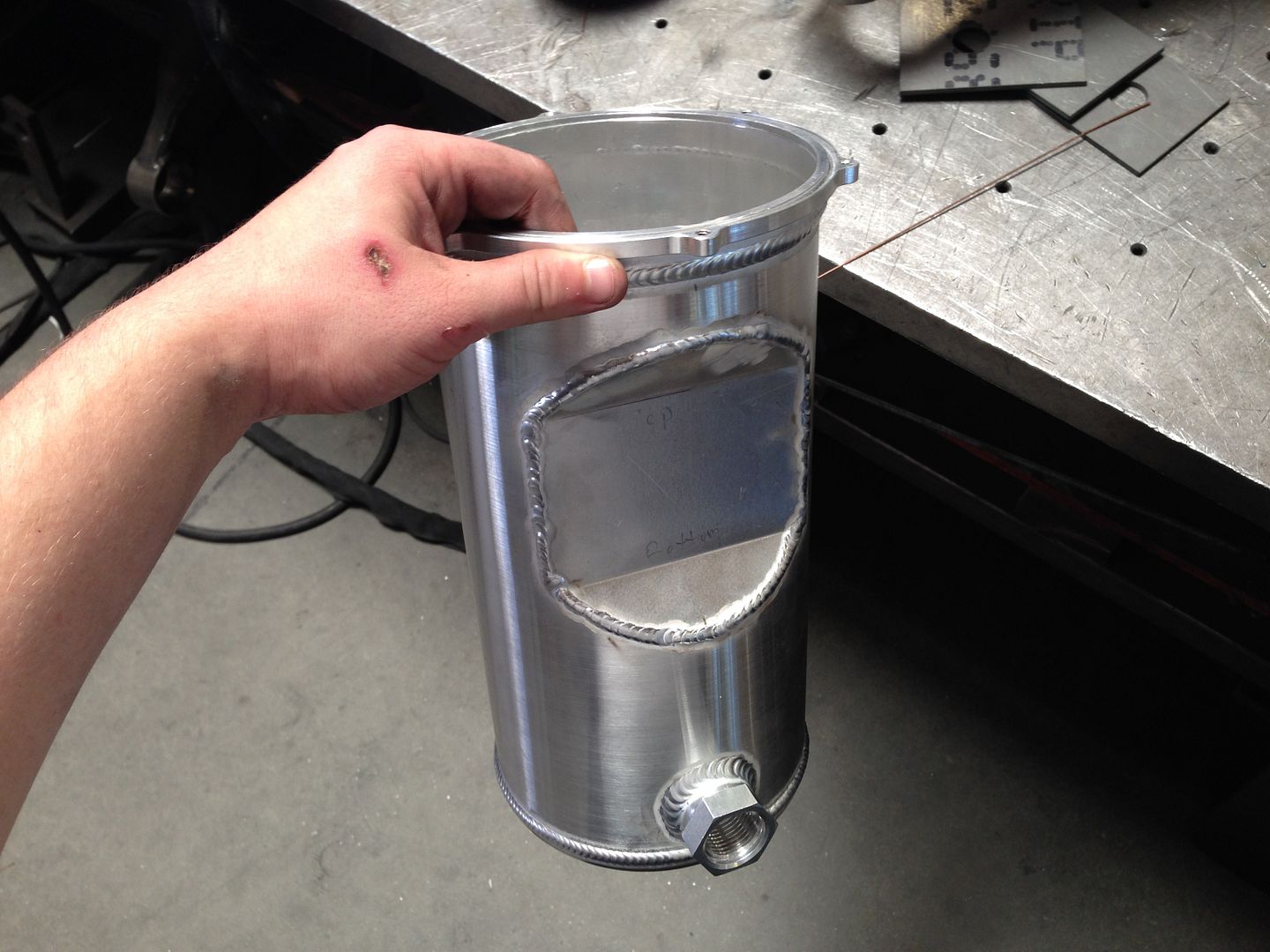

Dry sump plumbing time. The tank will need to notched into the frame rail for clearance. Breather is going on the other by the opposite to the brake booster to balance out both sides. All tanks (dry sump, breather, brake booster, PS, catch can and over flow) are getting anodize gray for continuity. Peterson used 5356 welding rod for the sump and breather tanks as normal welding rods will anodize in a different color and look funky.
http://i1231.photobucket.com/albums/...ps42f3b460.jpg
Al Moreno 06-14-2014 06:07 PM
Justin is cruising

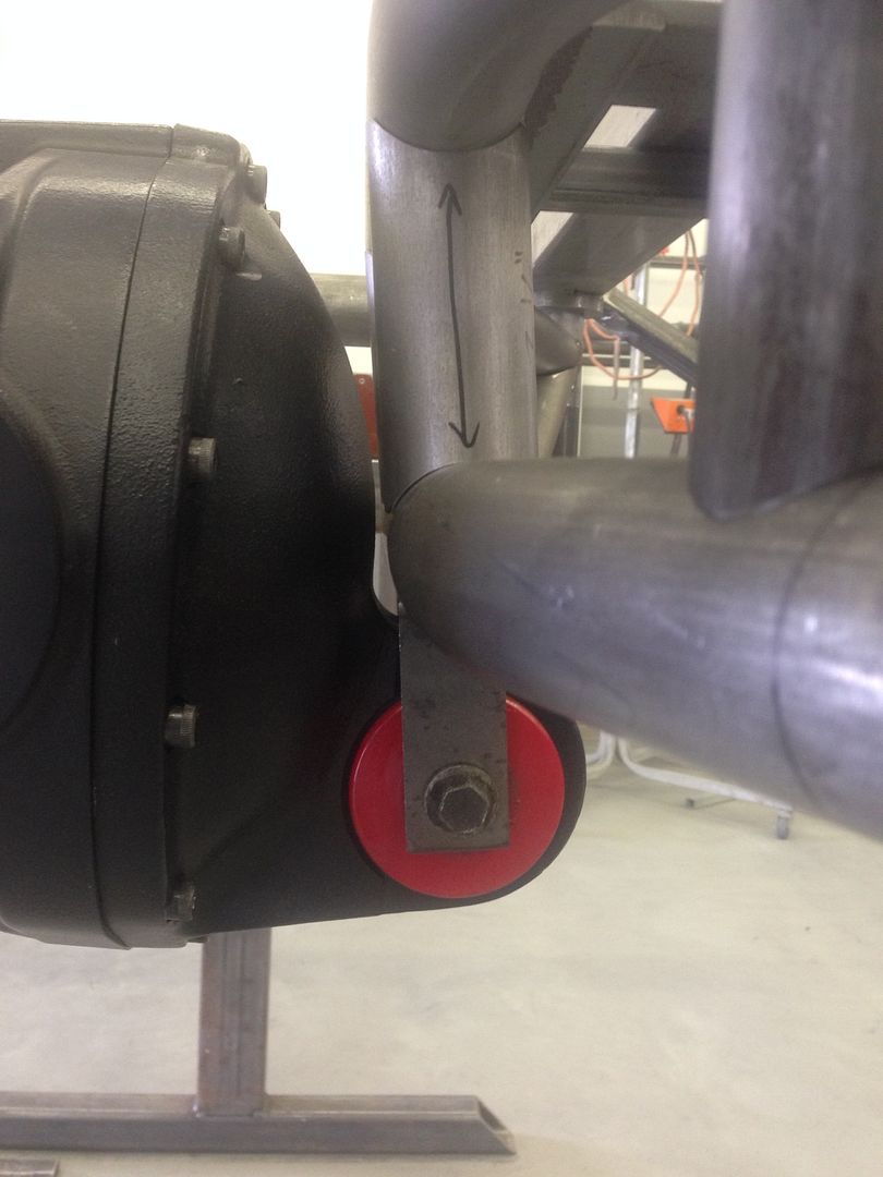

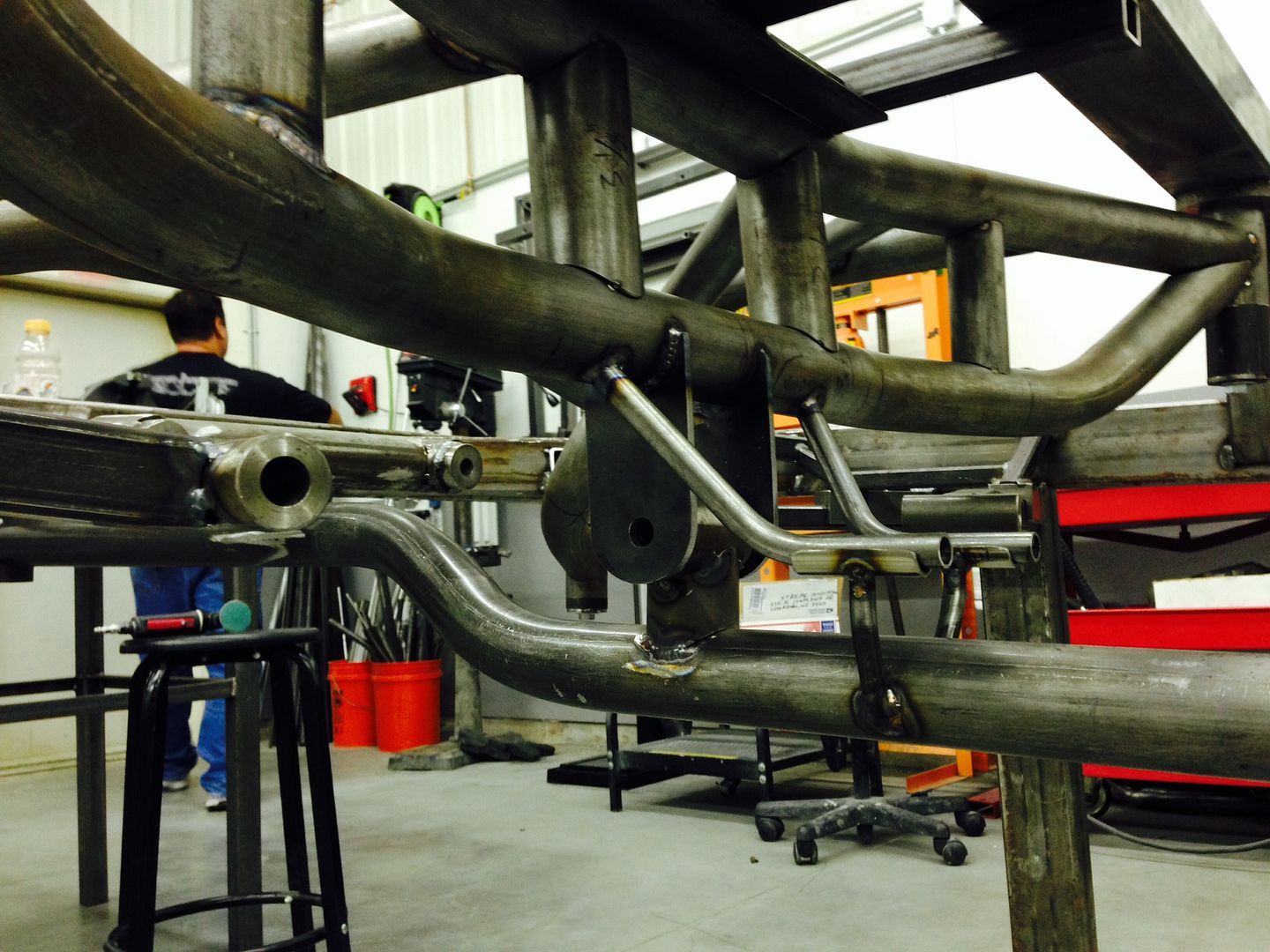

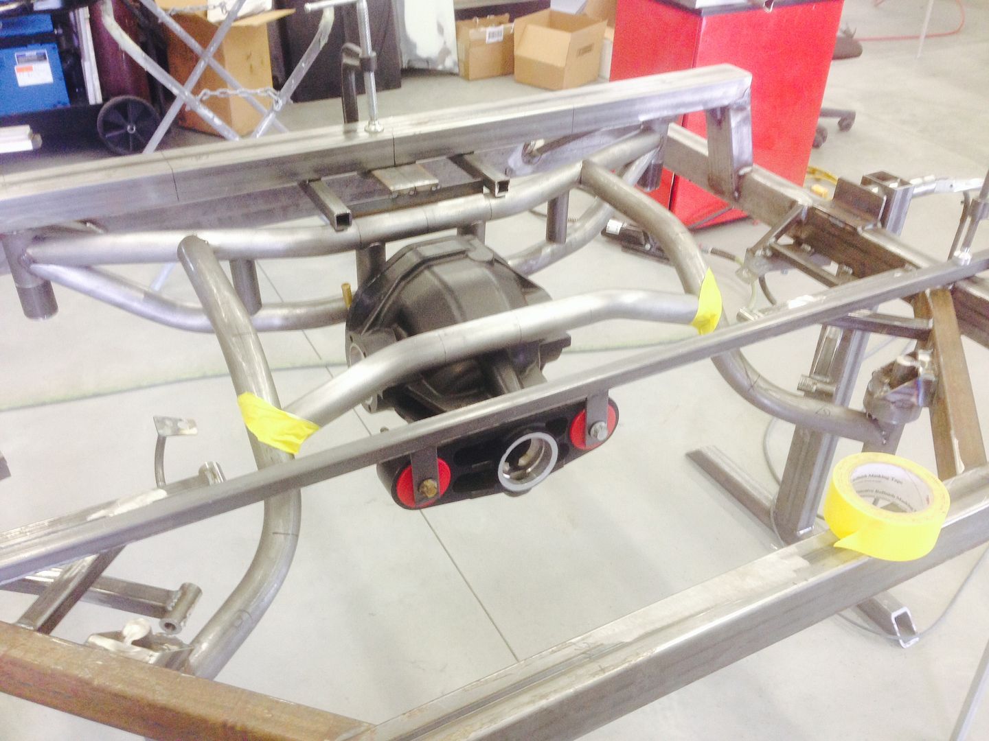

More progress on the rear cradle. The diff will have different mount point options to raise it.
Here is the before
http://i1231.photobucket.com/albums/...ps46c6d9eb.jpg
http://i1231.photobucket.com/albums/...ps3faf1b24.jpg
All the notches have super tight tolerances. Not an easy task.
http://i1231.photobucket.com/albums/...ps58e32fa2.jpg

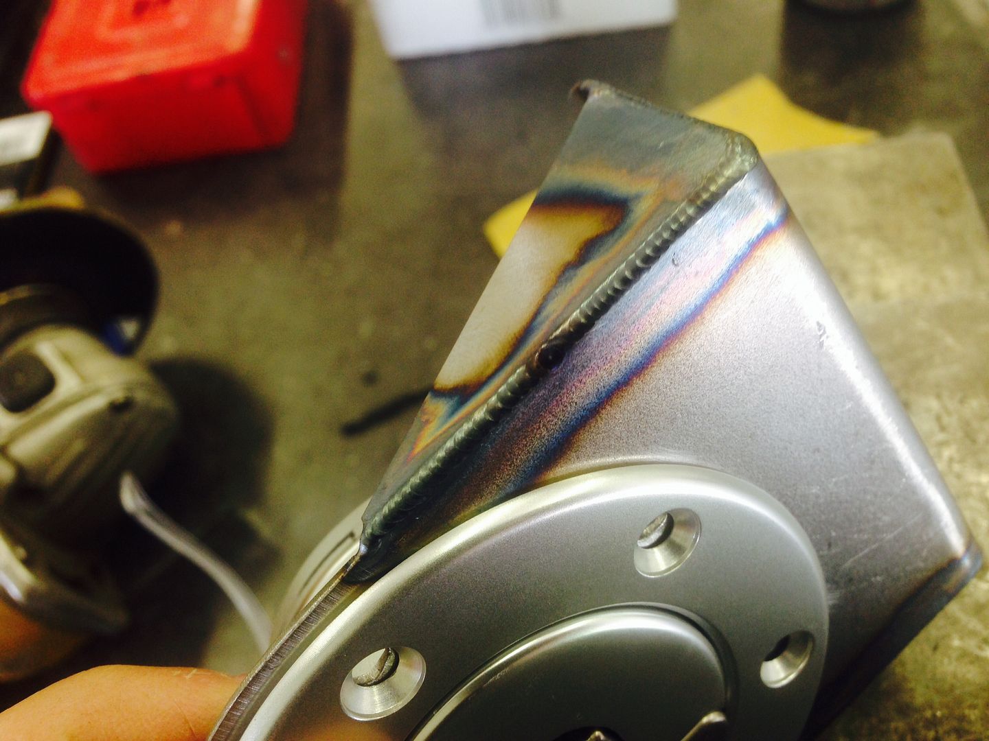

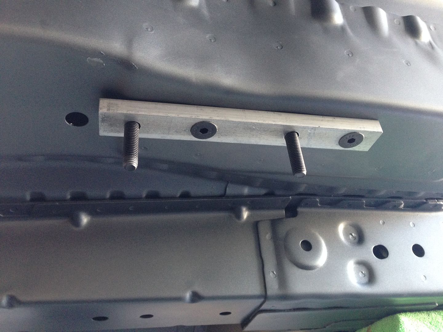

Fab up the bracket to relocated the gas filler cap in the trunk. The welds were done without any welding rod.
http://i1231.photobucket.com/albums/...ps4459d6b4.jpg
It will have a huge XRP super nickel -20 AN on the fitting with braided black hose routed to the tank. Should look cool.

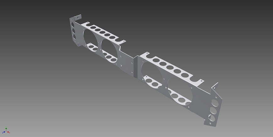

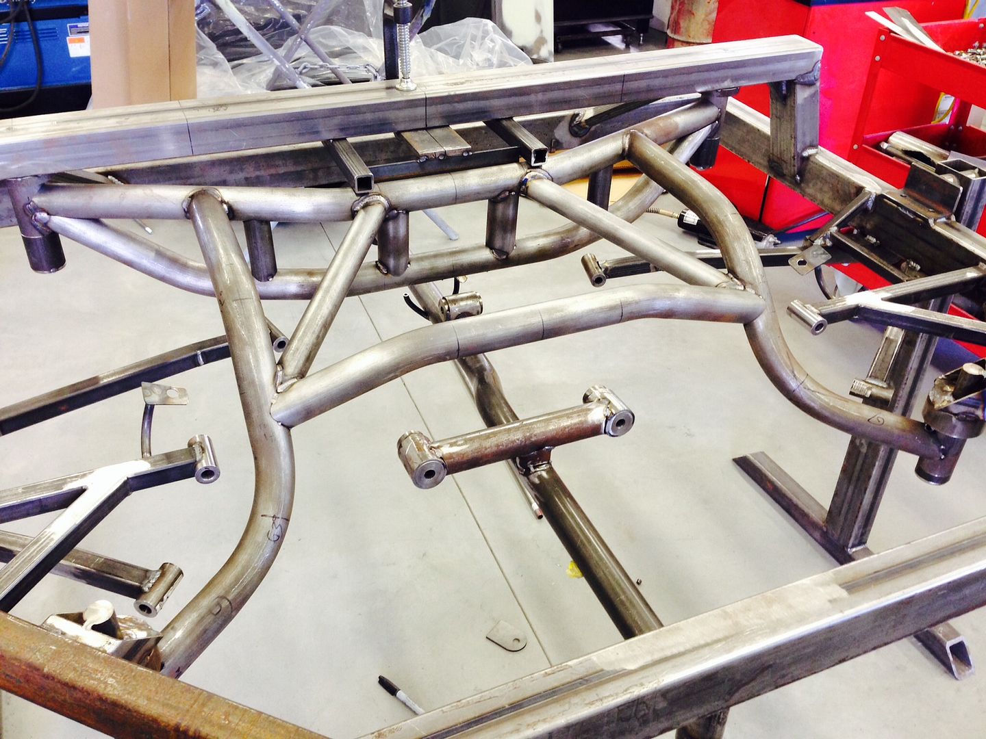

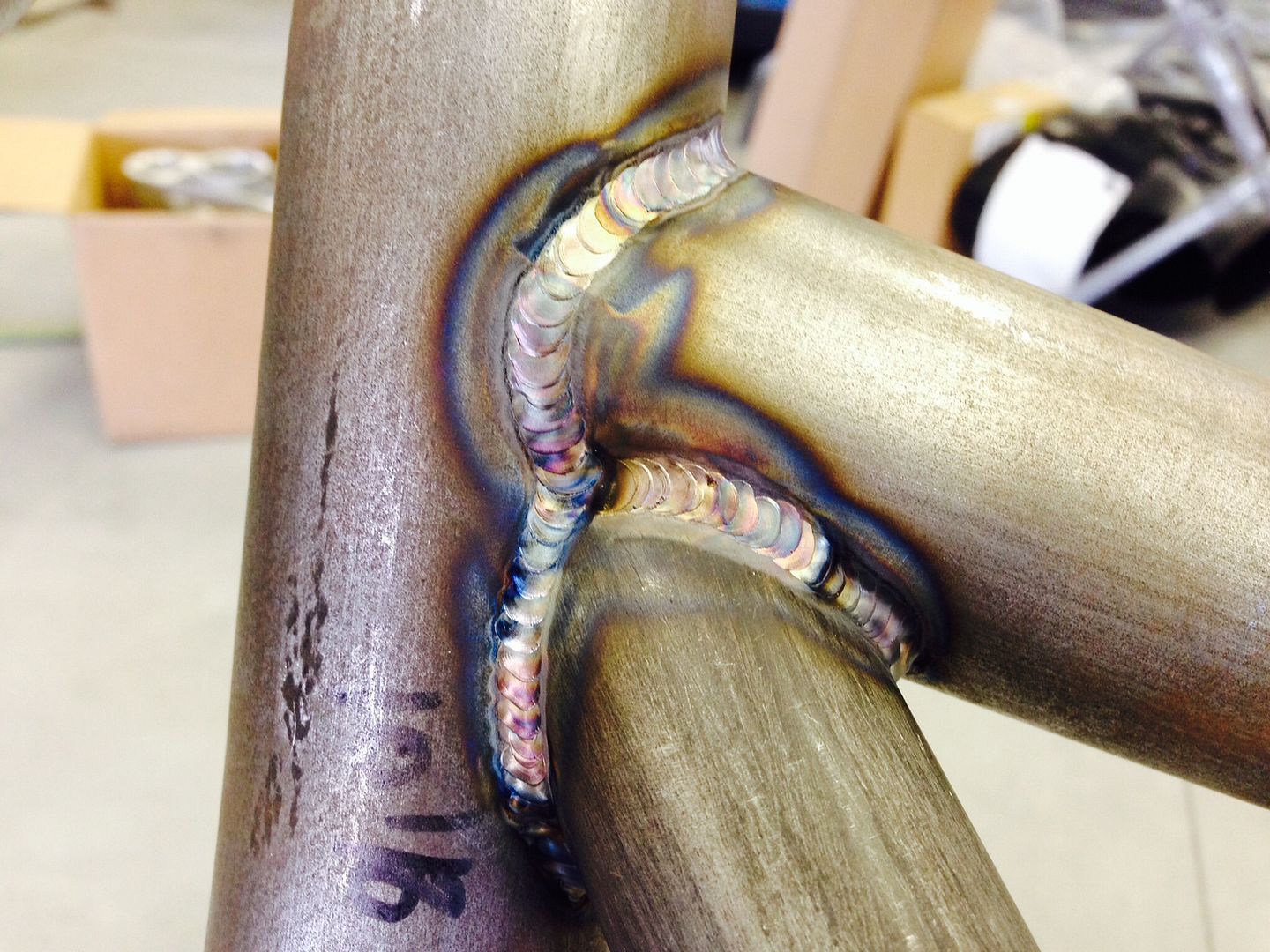

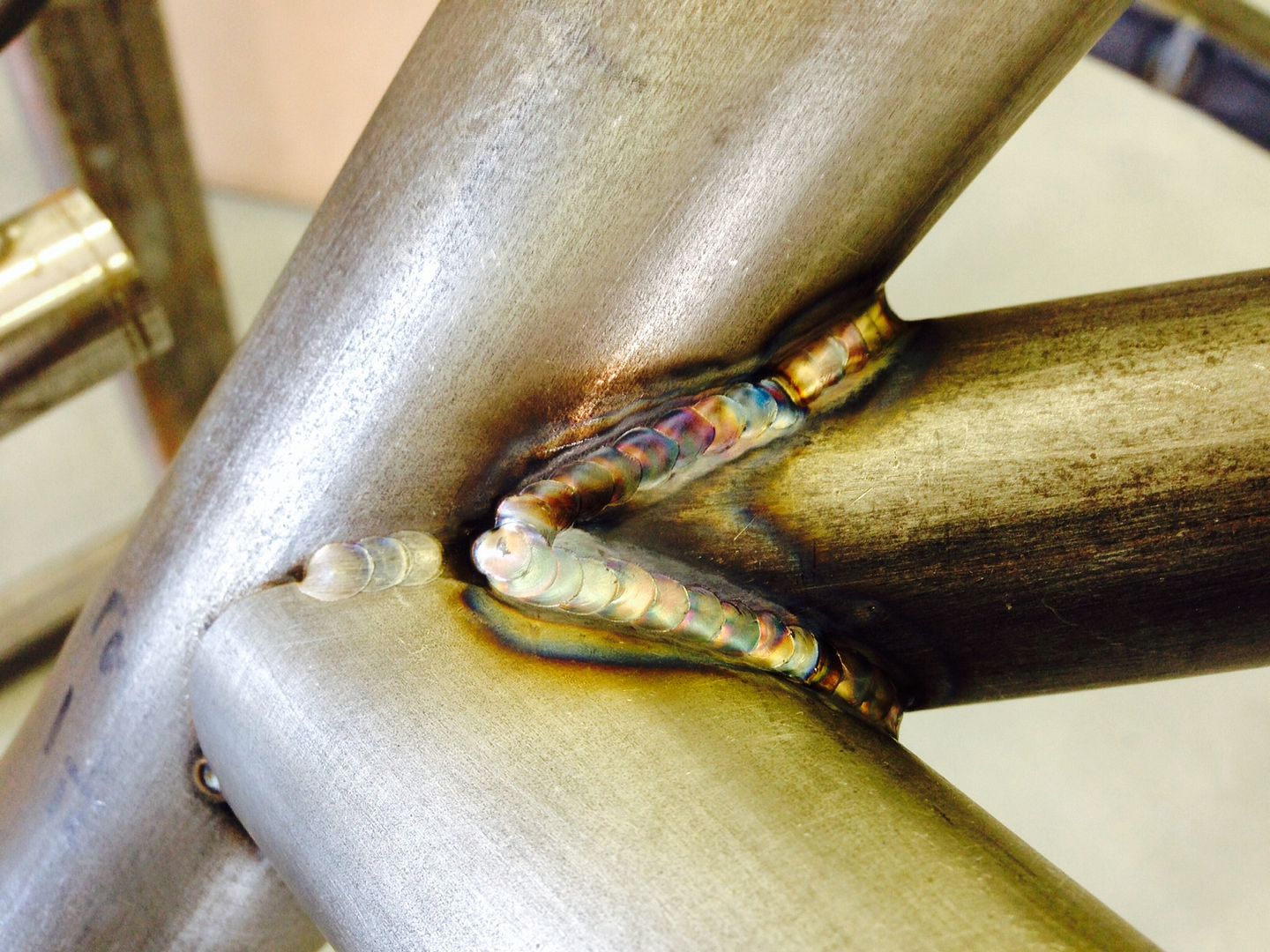

Lets call this tubular Thursday..... The basic cradle is done.
http://i1231.photobucket.com/albums/...ps593a2b66.jpg
Now they are welding it up.
http://i1231.photobucket.com/albums/...psa7d7c2e0.jpg
http://i1231.photobucket.com/albums/...psa66e8a65.jpg

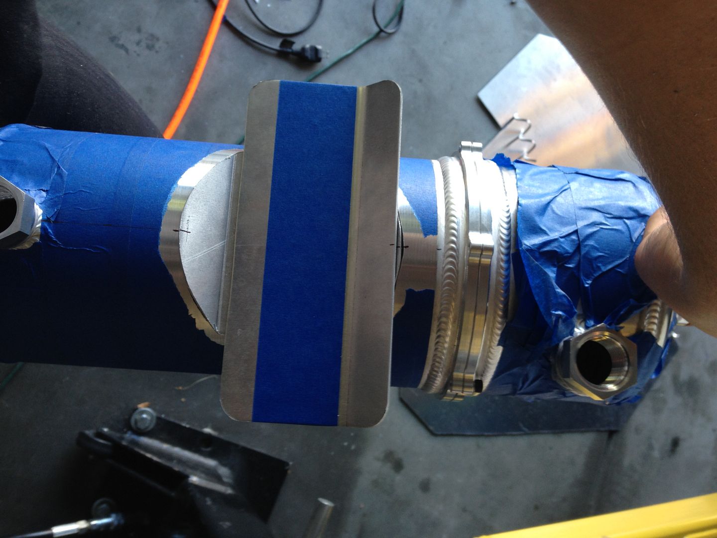

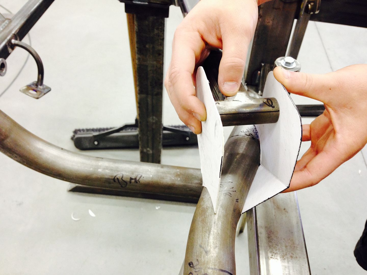

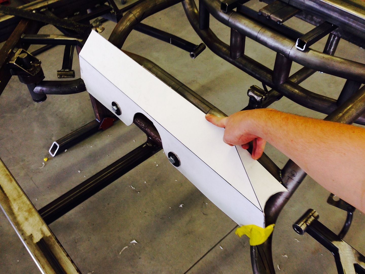

All the card board template are made to mount the arms. This one will be have triangle cuts to lighten it up.
http://i1231.photobucket.com/albums/...ps39790446.jpg
http://i1231.photobucket.com/albums/...psdd6f562e.jpg
Unfortunately its going to take two weeks to get the plates water jet so Justin wont be able to be able to complete the cradle in the three weeks he allotted to be in Wisconsin.

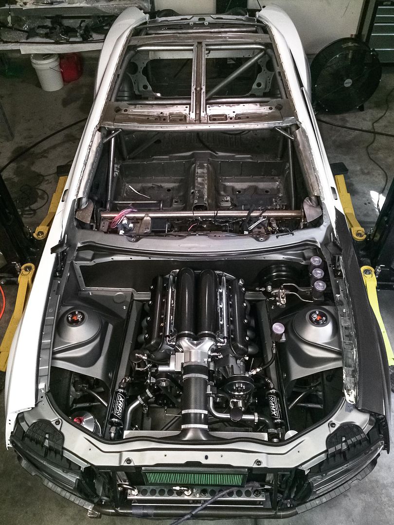

Random updates:

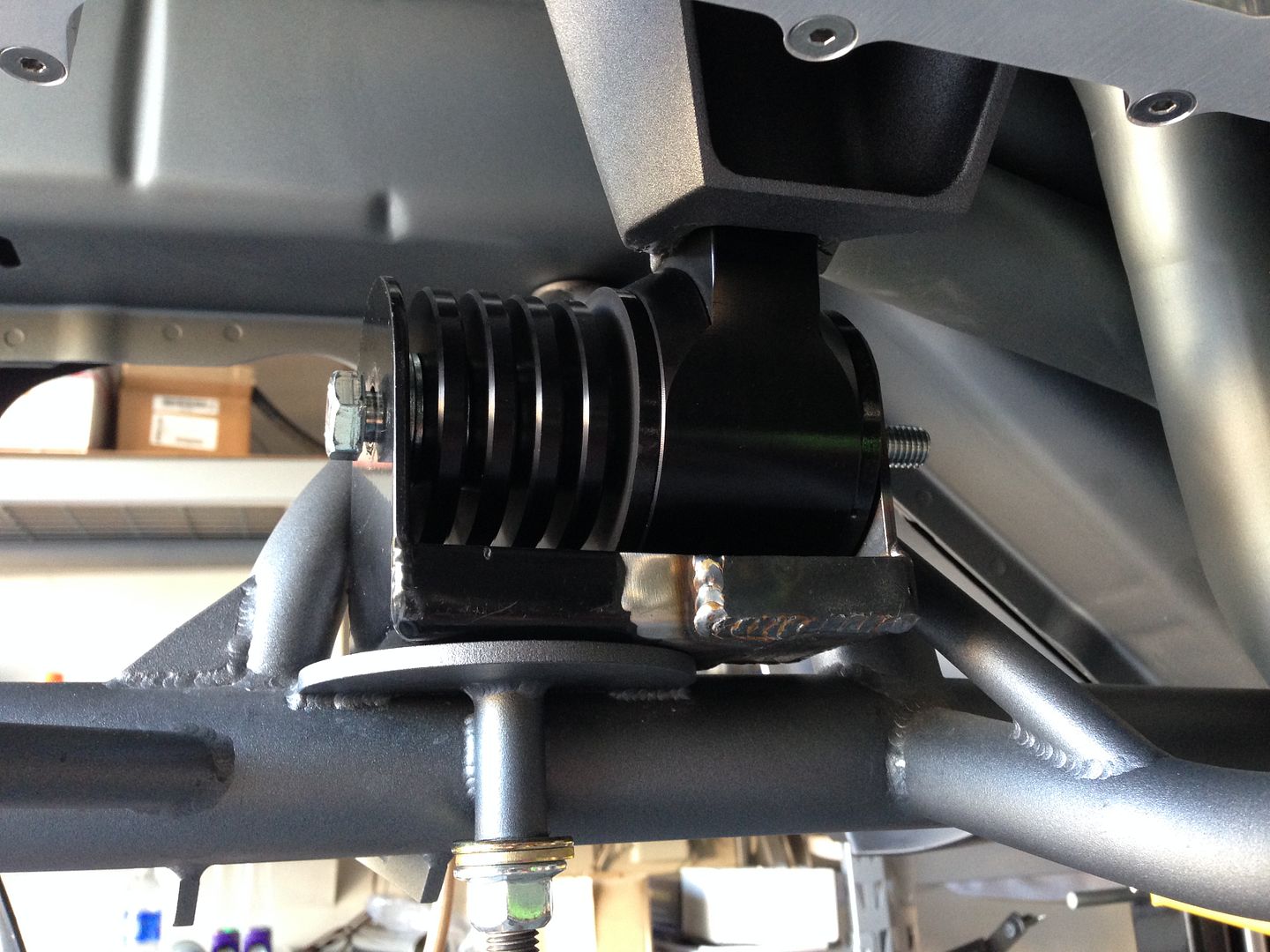

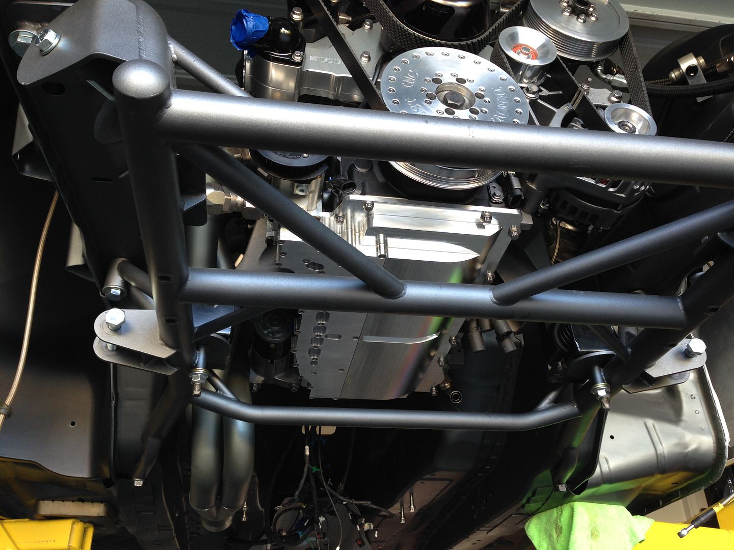

Justin modified the DSE motor mounts to allow for a 2" set back and 1/2" drop.
http://i1231.photobucket.com/albums/...ps86fb493f.jpg
Dailey's dry sump is in.
http://i1231.photobucket.com/albums/...psa157937b.jpg

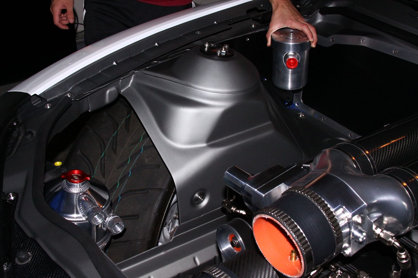

The dry sump tank was being mounted on the front right wheel well. Space was a a premium as the tire was hitting the tank when clocked inward. To gain 1" of clearance between the tank and tire required notching the tank, eliminating the mounting bracket and direct mounting it the frame rail.
http://i1231.photobucket.com/albums/...ps3e3dd71f.jpg
http://i1231.photobucket.com/albums/...psd9beb64b.jpg
http://i1231.photobucket.com/albums/...ps795cf215.jpg
http://i1231.photobucket.com/albums/...ps6cc9f1b4.jpg

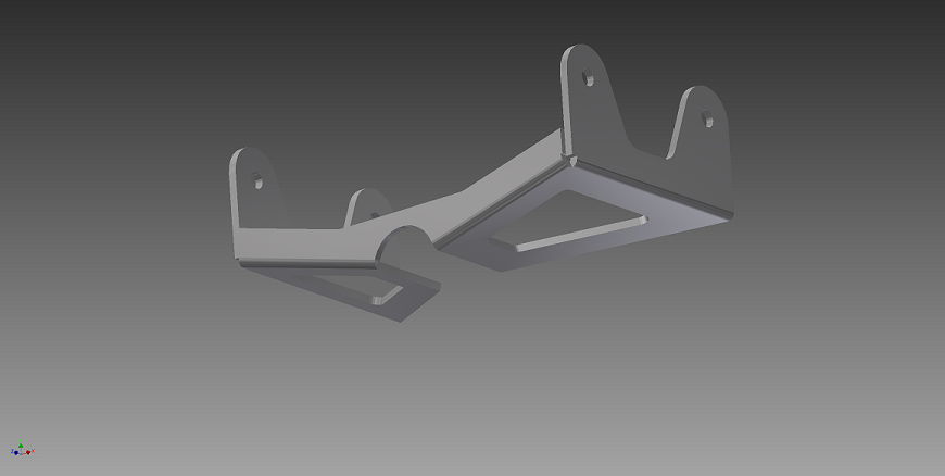

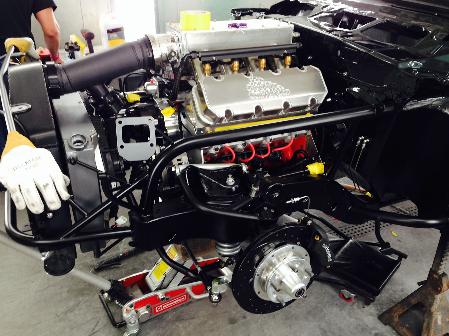

The trans mount needed to move back 2" and 1/2" back also. The was done by simple creating a 1/2" thick spacer that also relocated the mounting points.
http://i1231.photobucket.com/albums/...psd0d6edf8.jpg

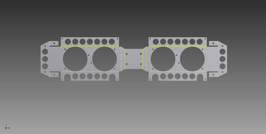

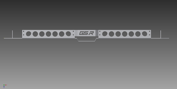

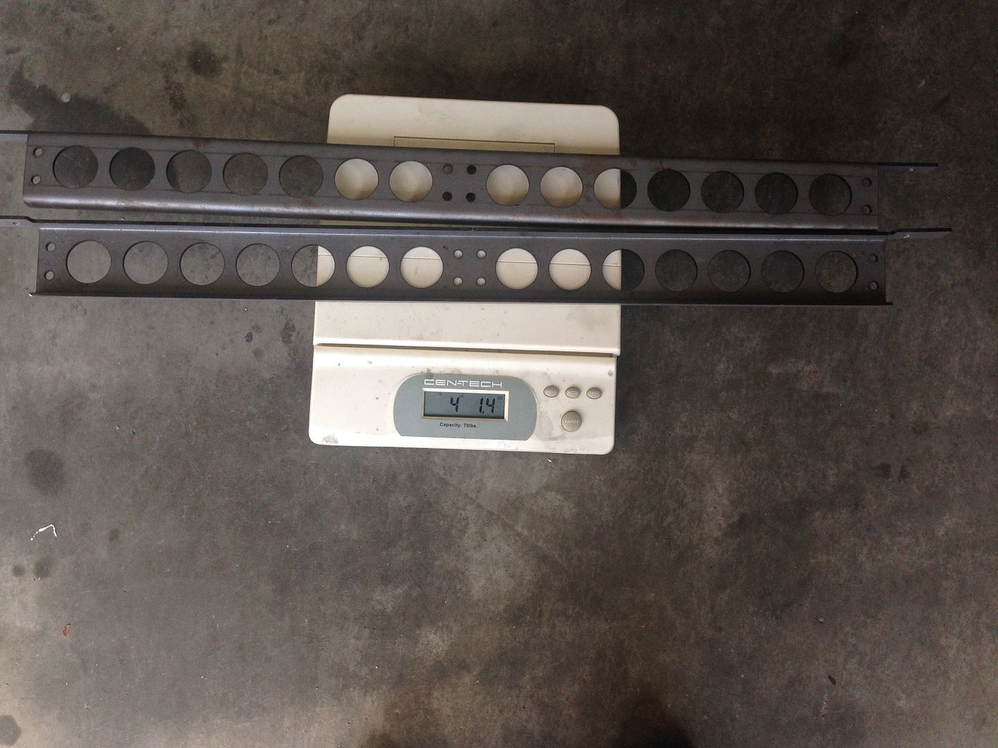

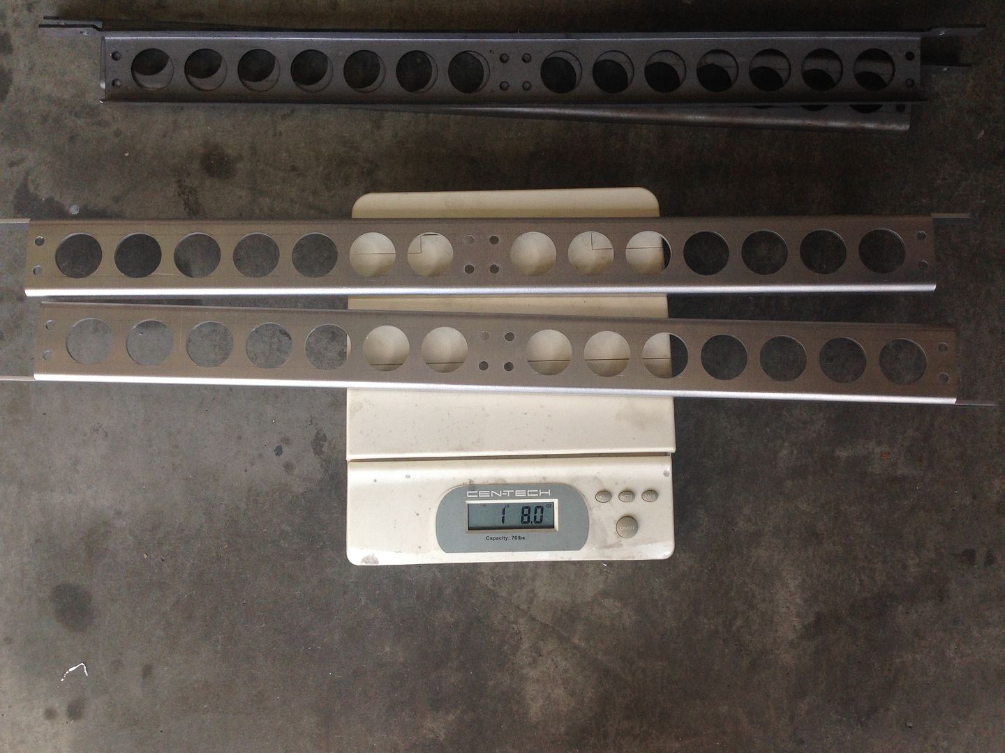

In the quest to shed as much weight as possible, our buddies at Derale are helping us out by remaking the steel brackets for the front coolers out of aluminum.
http://i1231.photobucket.com/albums/...psd7fe98e1.jpg
Every ounces helps.
http://i1231.photobucket.com/albums/...ps42e3047e.jpg

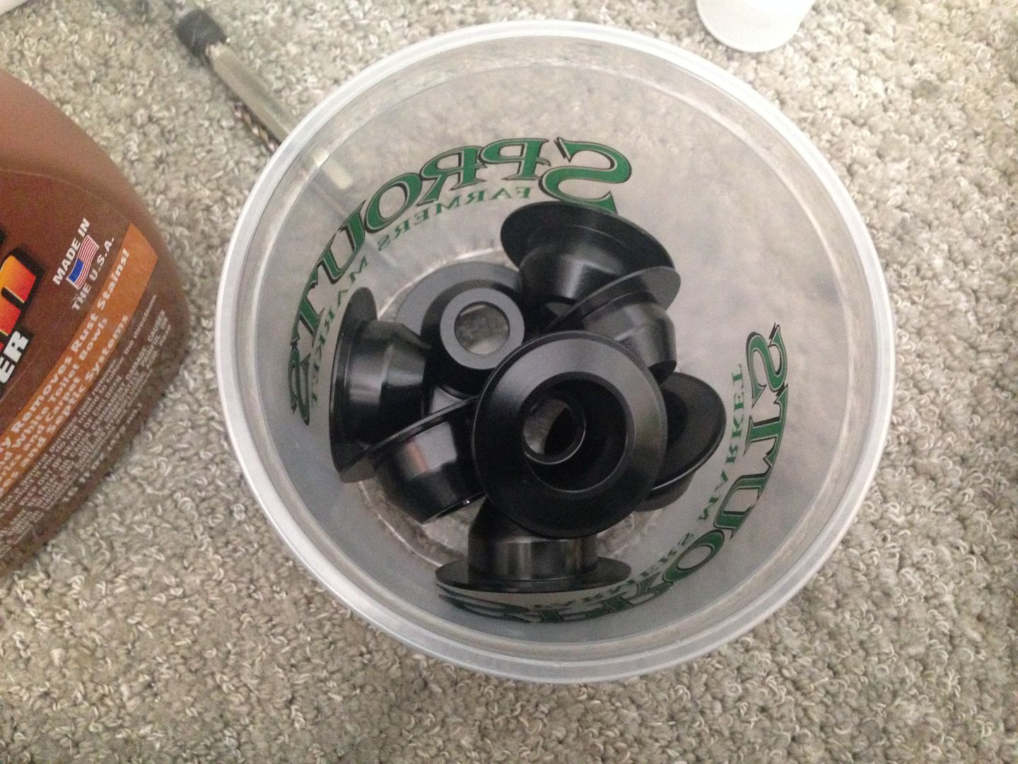

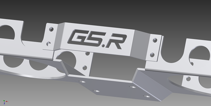

Katech is making a new set of valve covers for G5.R that won't have the bolts for their coil bracket as there's no need. They're also removing the filler caps since it's now dry sump, and lastly, they are also relocating the PCV NPT female fittings to the back of the valve covers, making for a really clean look. They sent us a set of the black anodized billet caps that go around each bolt so that we can strip and finish them to our liking. Part of the reason we didn't want the caps to be black is because the ones on the current carbon valve cover have now turn purple and look like crap.
Here they are before the anodizing remover was poured in. Anybody interested in the product, let me know and I will post the info. It was really good stuff.
http://i1231.photobucket.com/albums/...ps253540ed.jpg
The two in the bottom have gone through the stripping process. The two on the top have been brush and hand polished with Mothers metal polish. That's really good stuff.
http://i1231.photobucket.com/albums/...ps8863322b.jpg

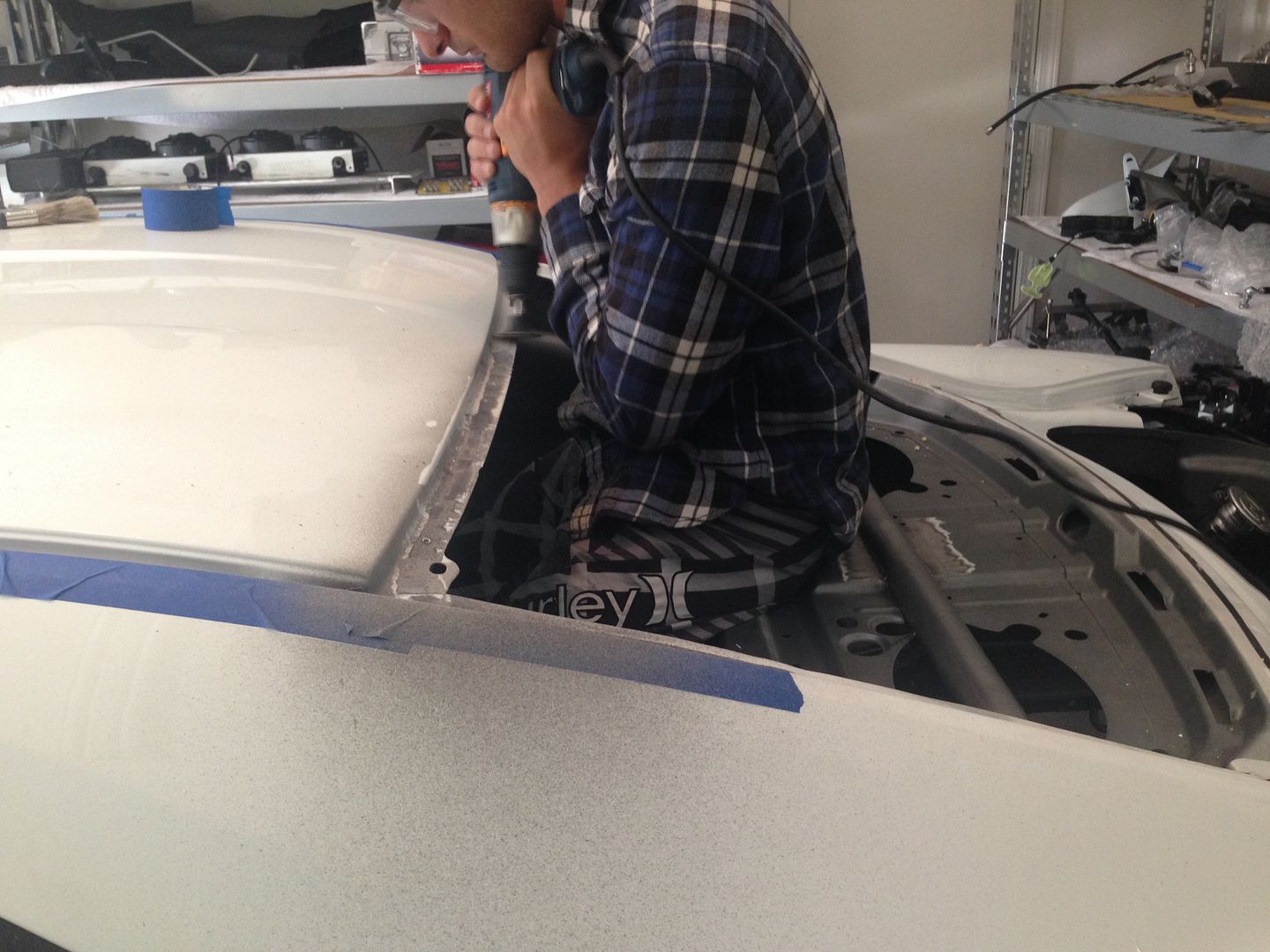

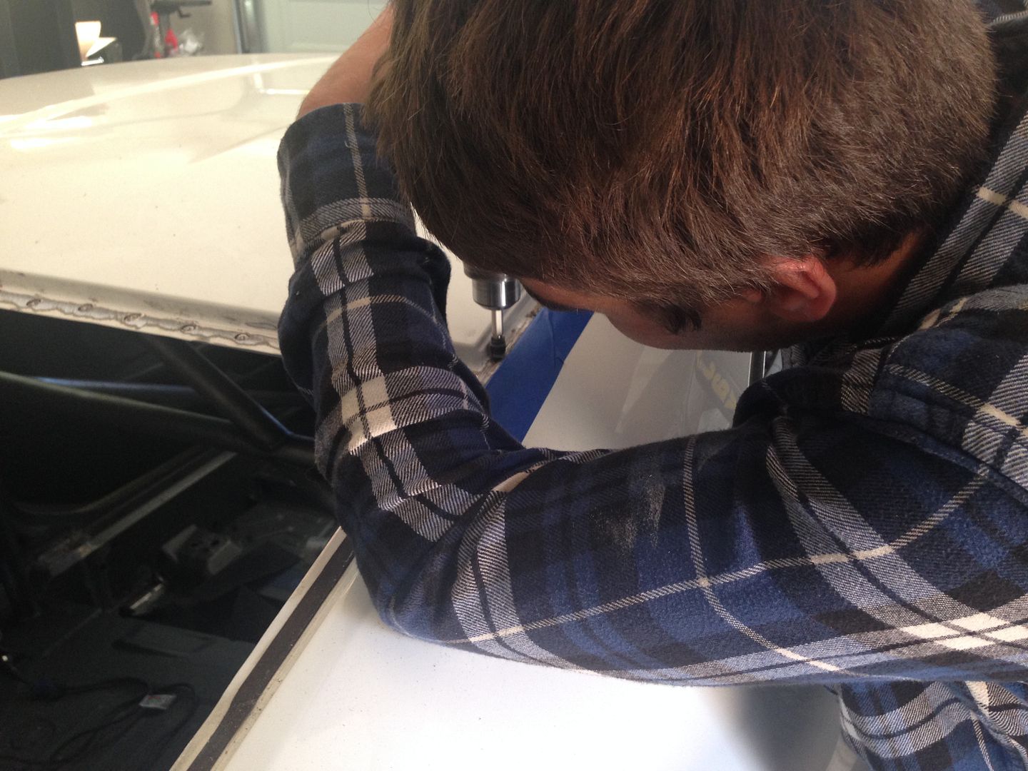

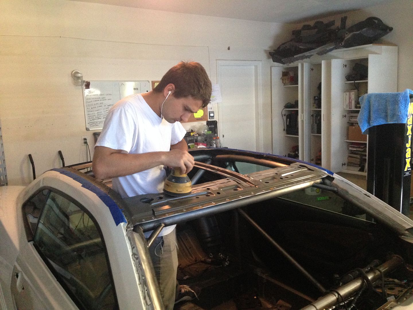

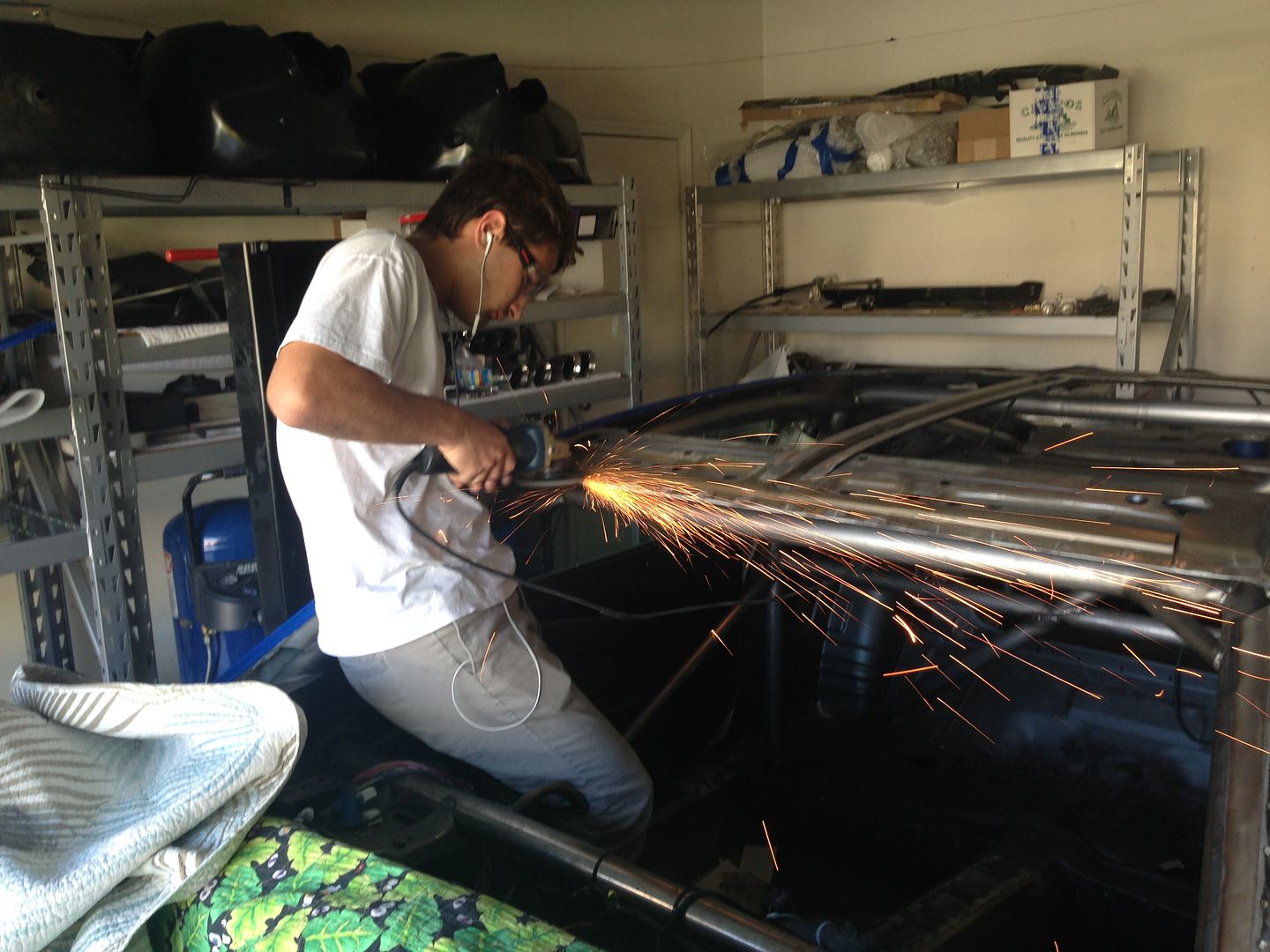

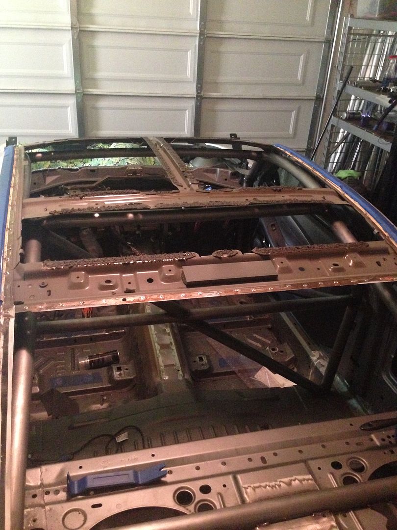

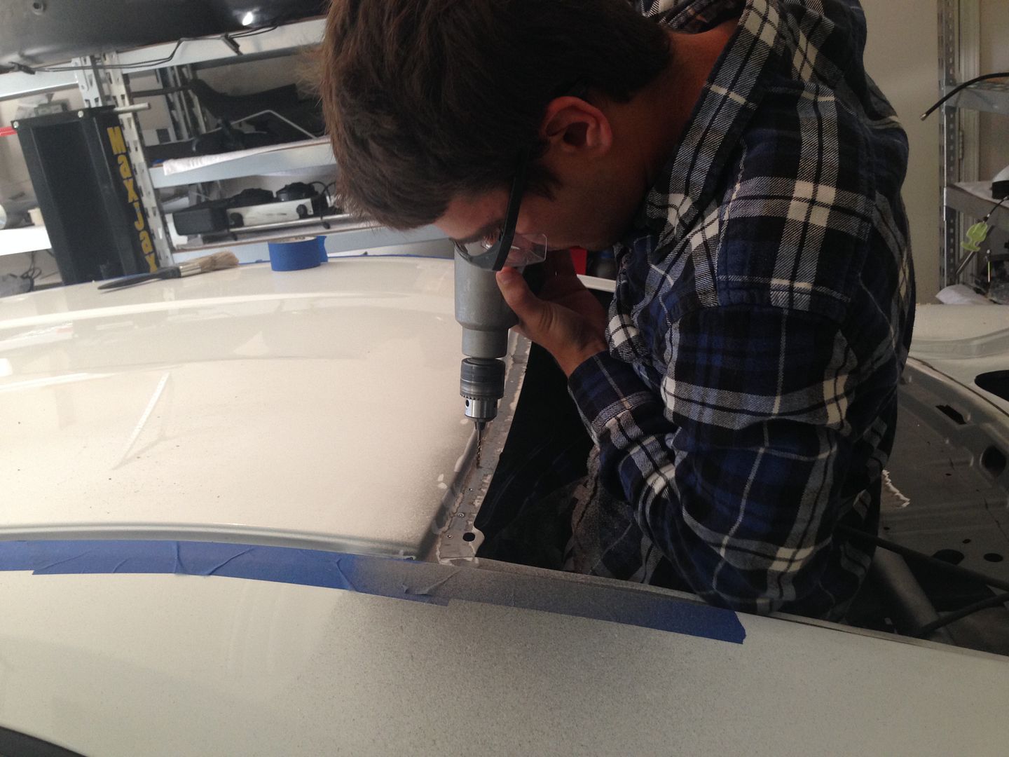

Lastly, Nathan started on the roof removal.
Here, he's cleaning off the paint to get a better view of where the stop welds are.
http://i1231.photobucket.com/albums/...psce48fc27.jpg
Next, he did a pilot hole.
http://i1231.photobucket.com/albums/...ps4a51c699.jpg
Next, drilling out the stop welds.
http://i1231.photobucket.com/albums/...ps1203f966.jpg
Grinding them down...
Finally
http://i1231.photobucket.com/albums/...psf620b330.jpg

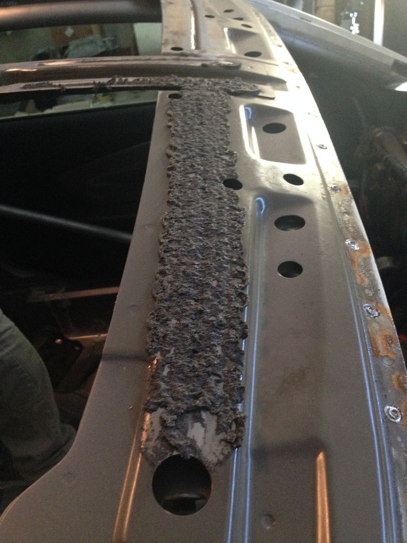

Next, cleaning the foam filler and spot welds.
http://i1231.photobucket.com/albums/...ps4dc8ac19.jpg
http://i1231.photobucket.com/albums/...ps5bc823e9.jpg
http://i1231.photobucket.com/albums/...ps43186939.jpg
I will post more updates tomorrow

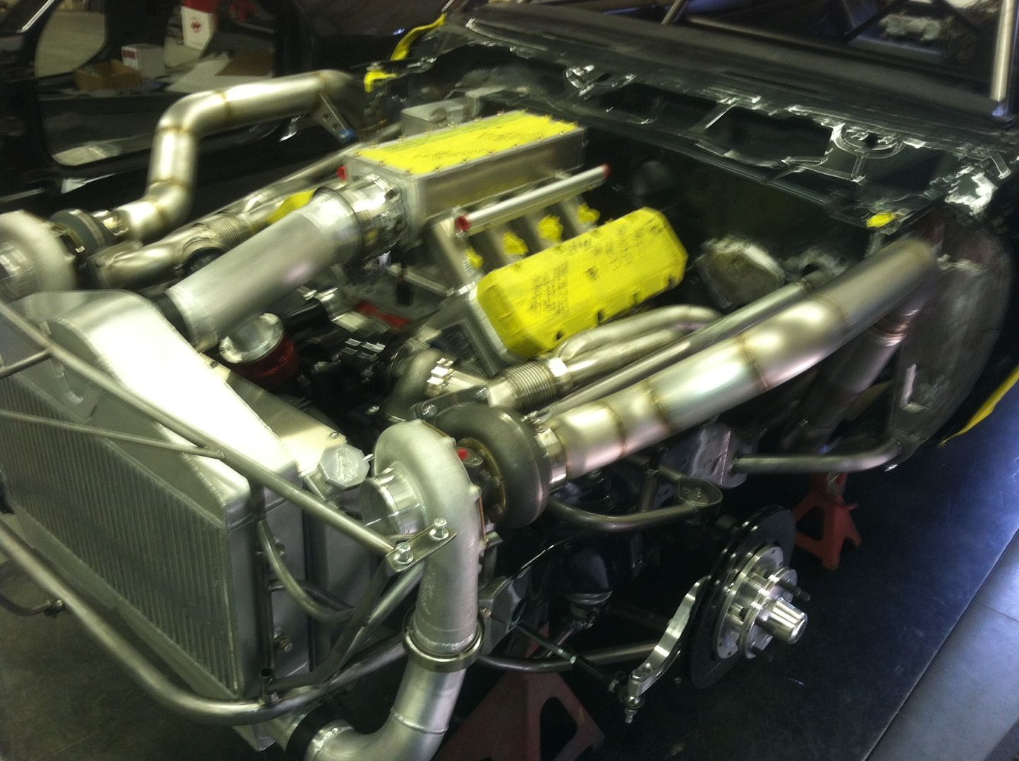

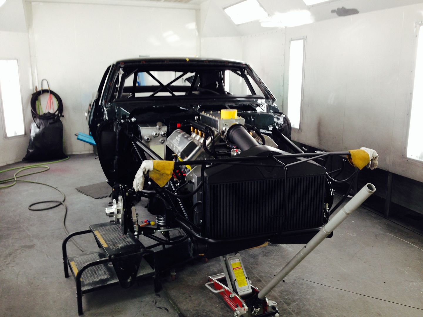

One more for today Marty,
Intake tube was cut to size. XRP oil filters mounted. Having one on each side makes for a really symmetrical look. Still need to figure out best way to mount the breather tank on passenger side by firewall.
http://i1231.photobucket.com/albums/...ps38ea0a23.jpg
Pictures really don't do it justice as theres so much details. You just need to see it 3 dimensionally.

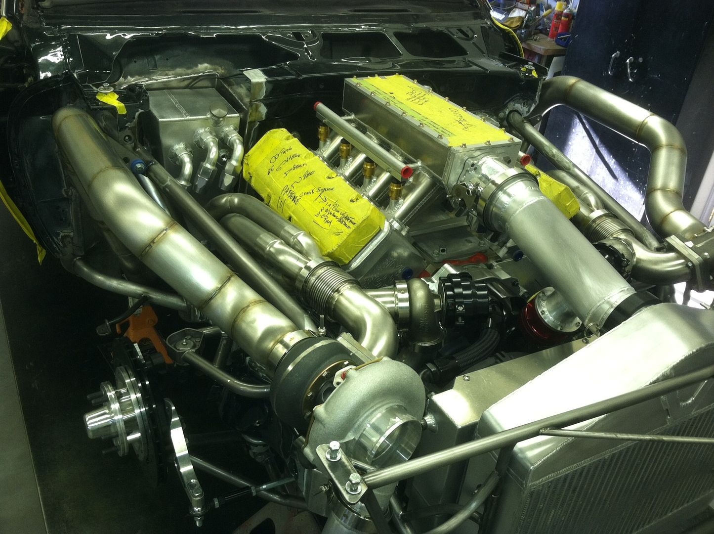

fleet 07-06-2014 09:55 AM
Originally Posted by Al Moreno (Post 558977)
Skip that's too funny! Thanks for posting it. I'm going to make it my desk top, LOL
I think this pic is gonna be on a lot of desktops Al... :wow: :thumbsup:
WSSix 07-06-2014 02:59 PM
Wow, is right. What a great pic of the engine bay. Gorgeous!
Easy-Off oven cleaner takes anodizing right off. I believe it's the yellow can that you have to use though.

Make sure you get the boys to wear a dust mask, CPOD is a bitch! I have early signs of Asthma due to metal grinding and spraying primer without a mask.
Even faster is CRYSTAL DRANO sold in a small can -- Home Depot etc --- put some in a plastic bucket --- add some water... put parts on some kind of wire and dip 'em... I use a clear plastic bucket so I can watch them boil -- because when you get the mix right --- it's friggin' boiling! And the anodize comes off in seconds... Rinse 'em off... and you're ready to polish or paint or whatever you're doing.

One questions though, why did they take the roof off?
Hey Vince, thanks for the reminder.The crazy parts is they have a box of really nice mask but I still have to keep on them to use them.
Thanks for the tip G

Originally Posted by aggie91 (Post 559882)
They are doing a great job with the car. The engine bay looks outstanding.
Replacing with a carbon panel. The factory roof came in at approximately 22 lbs. Hoping to shed 15 of them.

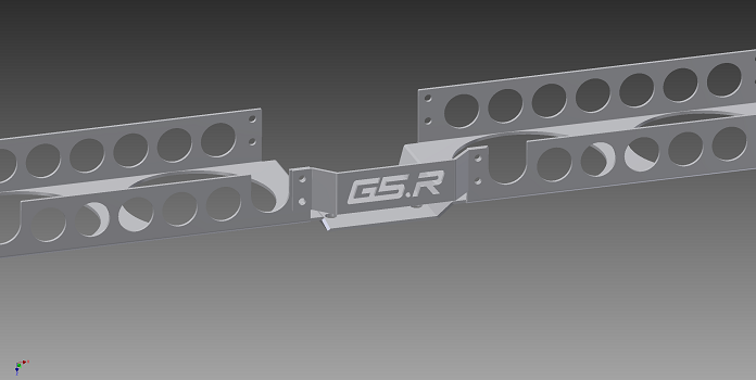

Justin design new coil bracket and rear cooler mounts.
Bracket will be welded to the tube frame
http://i1231.photobucket.com/albums/...ps778e1237.png
http://i1231.photobucket.com/albums/...ps784e8726.png
Rear mount trans and diff coolers bracket. The big holes are for the fans. The Triton pump will sit in the center.
http://i1231.photobucket.com/albums/...ps53797889.png
http://i1231.photobucket.com/albums/...ps616a8345.png
Got to give props to all the guys at Derale as they are helping the boys take it to the next level!
Al Moreno 07-16-2014 09:36 PM
Nobody will see a lot of these details but who cares, LOL
http://i1231.photobucket.com/albums/...ps6c716382.png
http://i1231.photobucket.com/albums/...ps1c244ea8.png
http://i1231.photobucket.com/albums/...ps6aaef6a6.png
