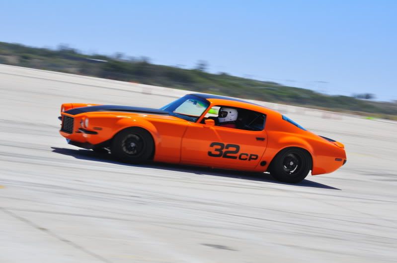

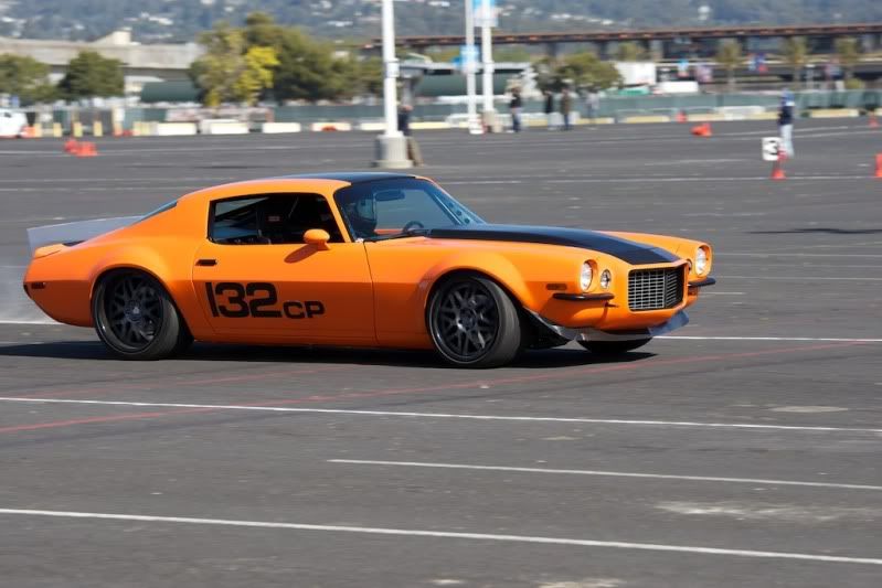

How much camber were you running in the pick ? looks like a ton from that angle .Any chance you shortened the upper A arm and took some -camber out ? Just guessing here .
It was nice to see that ad when I opened up Hot Rod the other day.
My suspension is all custom Maier Racing suspension. The A Arms are actually fairly long, upper and lower. I run anywhere from 2.5 to 3.25 degrees of negative camber in the front. The rear is a solid axle Ford 9" with a Maier Racing 3-link with a Watts link.

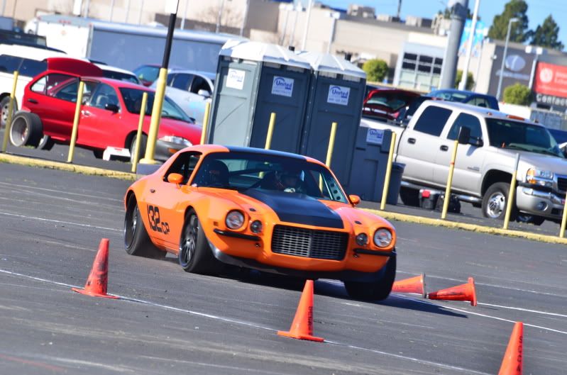

Getting ready for 2012 and went to the first SCCA Autocross event of the year. I am looking forward to seeing everyone at RTTC in a few weeks.

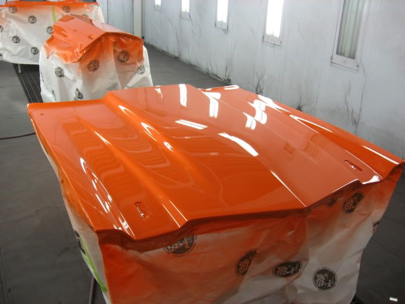

Did you buy or fabricate your hood? I noticed the "scoop" rises to one level and stays that way all the way back. The aftermarket cowl style hoods I've seen have a continuous rise that I don't care for. If you bought it, where from?

The hood is from UP22. Typical of all the fiberglass hoods. We cut out the spine and lowered the hood to get the look I wanted. Here are some photos of the work we did.
Grinding down the raised body line
http://i80.photobucket.com/albums/j1...b/IMG_3335.jpg
http://i80.photobucket.com/albums/j1...b/IMG_3307.jpg
http://i80.photobucket.com/albums/j1...b/IMG_3336.jpg
http://i80.photobucket.com/albums/j1...b/IMG_3351.jpg
Primed after modification
http://i80.photobucket.com/albums/j1...b/IMG_3386.jpg
http://i80.photobucket.com/albums/j1...b/IMG_3540.jpg
70rs 02-20-2012 08:58 PM
