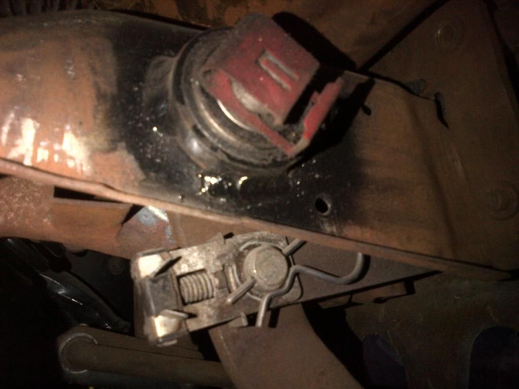

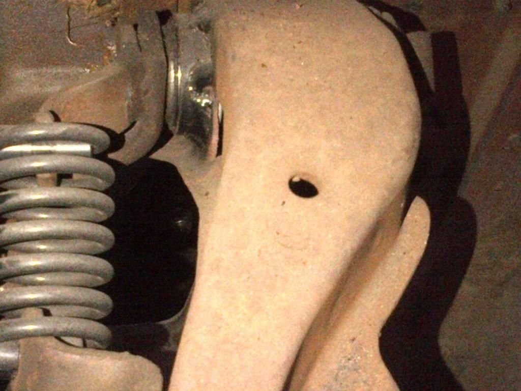

Thanks for the heads up but I think your buddies problem has everything to do with his pedals and little to do with the linkage. The stock pedal design doesn't fair to well after decades of use with a heavy clutch. The metal shaft swinging in the metal hander with only a thin delrin bushing results in an oval hole over time and a pedal that no longer swings in one vertical plane. The side loading on the MD linkage looks to me to be his pedal rocking in the hanger.
Now in mine I took my pedals and pressed on some sealed bearings on the shaft and tacked in a couple of races on the hanger to hold the bearings. My pedals only swing front to back not side to side. The plane the pedals move in is aligned with the throw of the master. The pivot point on the MD linkage is at the bottom and the actuation rod for the master in the middle. The top is the pedal only moving fwd and back in a plane that bisects the master and the path of its piston. I don't think the bottom can chart a different path in my scenario. Ask your buddy if he can rock his pedals side to side, I bet he can. The only way to do that with mine is with a sledge or something else that can bend the hanger.
http://i291.photobucket.com/albums/l...psa5dd6501.jpg
http://i291.photobucket.com/albums/l...ps2dad131d.jpg
