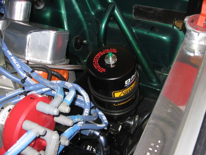

Can you set an accumulator up to introduce oil at a specified oil pressure? Once that oil is introduced into the system does it retrieve it back when pressures are adequate?
Yes you can, here is one i installed year ago on a drag car. See the solenoid at the bottom,that opens at a certain drop in pressure..

Thanks Jerry. I think I'll be putting mine right behind the radiator laying horizontally on top of the subframe.

Gae, just a thought...Chris (Project Major Havoc) mounted his switch activated accusump horizontal and forward of the fuel tank and ran the hoses up to the engine. Seemed like a good ldea for weight distribution.

Weight distribution yes, but it's about the farthest run possible for the lines to get to the motor when it needs it.

Stealing a little time from work here but quickly this is what I have. Also, with the mechanical the pressure set to dispurse will be pressure at engine shut down which is why I will be going with a solenoid in the 40 psi range.

Payton King 06-27-2013 01:54 PM
Pressure
should be set at 25 lbs. It will be dumping extra oil in your motor at hot idle if it is set at 40 psi when it does not need it and assuming you are getting the 3 quart system, that is way too much.
Randy Bell has on on his car and he also wired a red warning light to the system. The light would come on when the system discharged just so he would know when and where on the track he was losing pressure.
