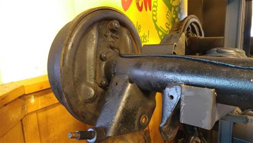

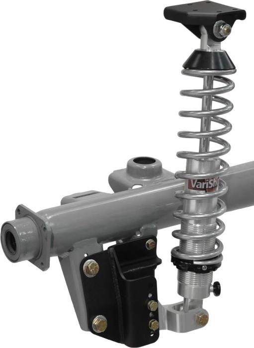

PunisherGTO 11-25-2018 02:40 PM
2 Attachment(s)
Did you choose your shock length or order G body rear coilover?
The Moser style refers to the shock mounting hole is incorporated into the lower control arm mount. (Just like quick performance and currie) Which needs a different bracket to mount coil overs and it Moves the lower shock mount inboard for more tire/wheel clearance.
Factory A body axles have two tabs for lower control arm mount and shock. The mounts for coil overs use the lower control arm bolt and the shock mount together. And usually drilling a third hole above the lower control arm bolt and the axle tube for more strength. Attachment 67399Attachment 67400
Sent from my SM-G965U using Tapatalk
SSLance 11-25-2018 04:31 PM
I have never seen a shock mount like that before...interesting. We chose a 6.3" shock for my car and I built the lower mount to get it as low and as close to the wheel as I could get it.
