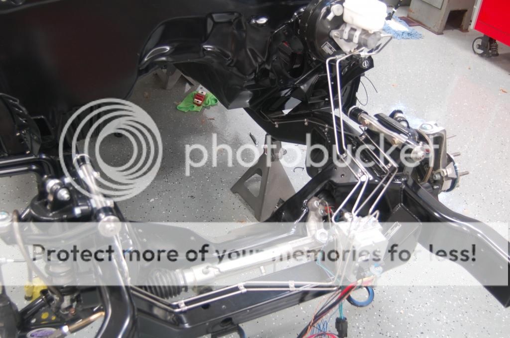

Killer line work! Line and electrical some of my favorite details to look at on a project. They say so much about your focus and attention to detail on a project.
I really want to run ABS on the PT-57. I wish you had a "how to" article somewhere on the interwebs for those of us who wish to follow in your footsteps. -Russell |
Beautiful line work. As previously said, great attention to detail. Is the distribution block on the front cross member possible due to the set back of the engine in the car this time or is this the same as Mayhem? Regardless it is both fun and educational to watch you piece together your cars. I really do appreciate the amount of work you do to support this thread while building the car, working full time (at a job that all of us wish we had the knowledge and skill to do), and having a life for you and your new wife.
Thank you, Rod |
HAHA !!! I think I know what you mean... Looks killer ! Mark |

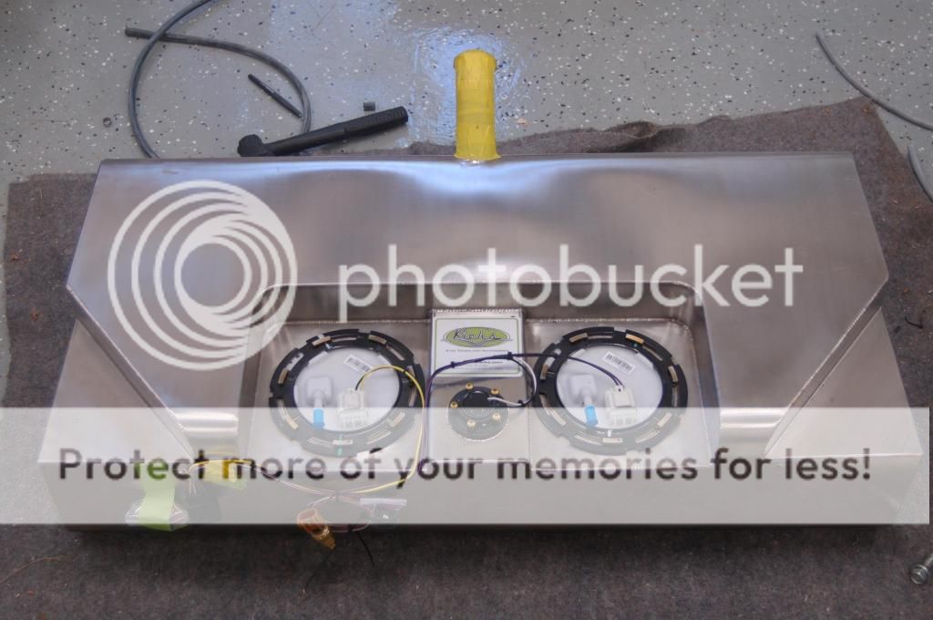

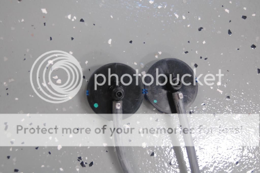

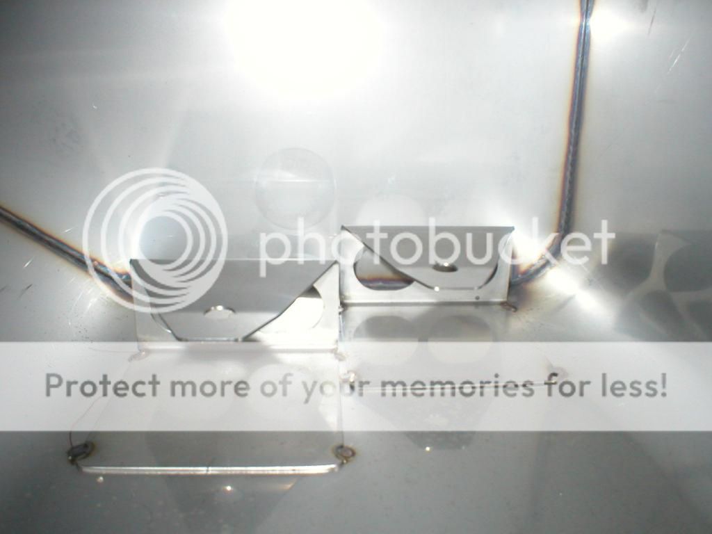

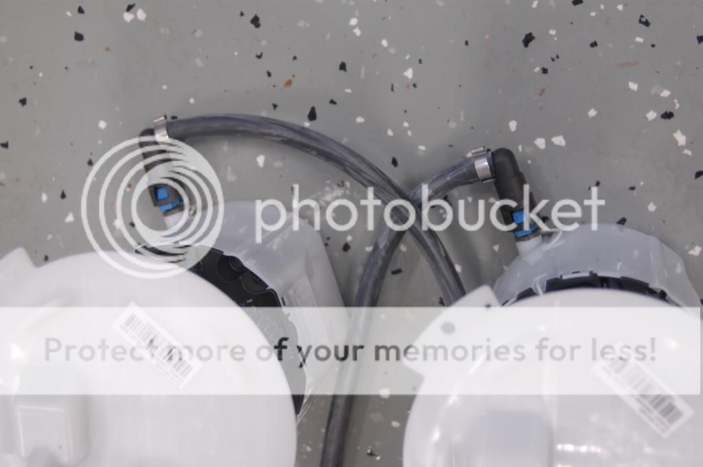

Fuel Tanks
Ricks made me a very nice tank with twin Camaro ZL-1 pumps.

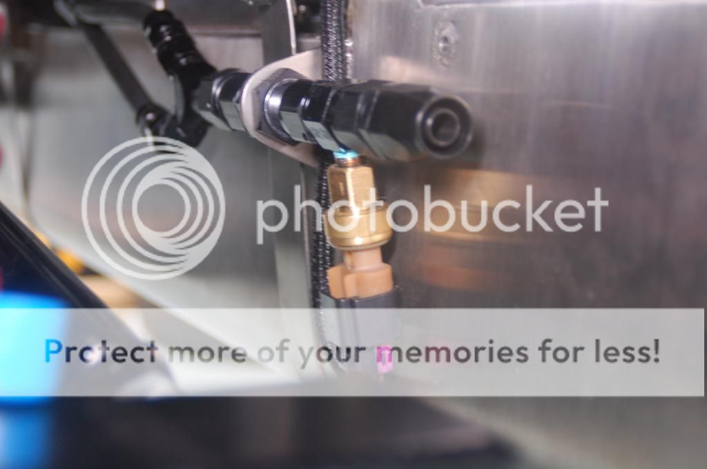

http://i439.photobucket.com/albums/q...ps79b32e7d.jpg http://i439.photobucket.com/albums/q...psa0d23172.jpg http://i439.photobucket.com/albums/q...ps93e6e97a.jpg http://i439.photobucket.com/albums/q...ps29257e01.jpg Vapor Worx preressure feedback sensor and TechAFX lines http://i439.photobucket.com/albums/q...ps19b51e57.jpg |

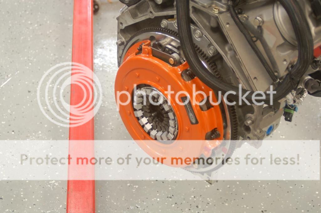

Clutch

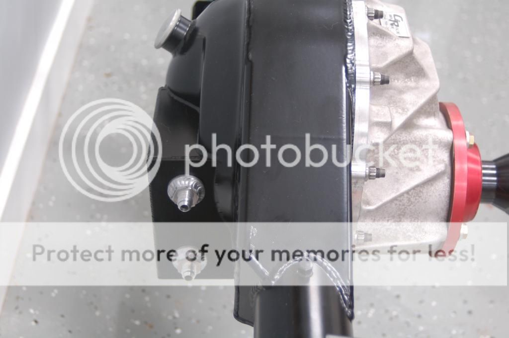

I went with a Centerforce Clutch and D &D Performance in Wixon Mi installed a oil pump in my trans. They are offering this now. It is the same pump as the TR6060 in a Magnum box. I will use it to pump my trans fluid to the rad to cool the fluid then that fluid will go to the diff.

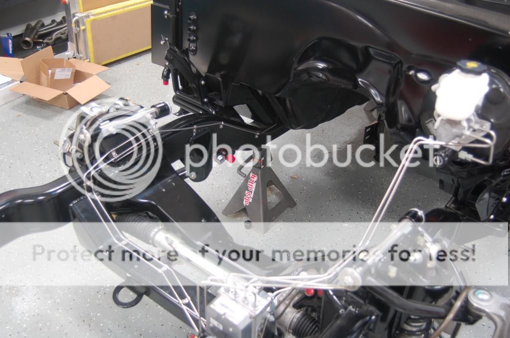

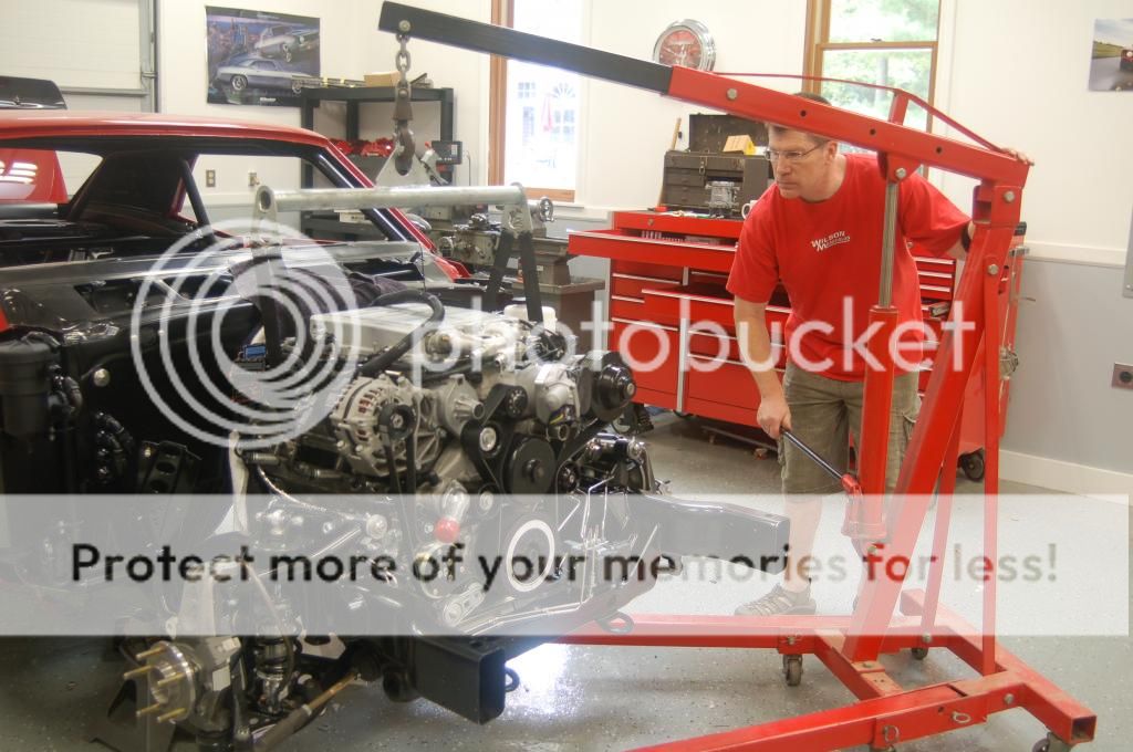

http://i439.photobucket.com/albums/q...psa2695a3c.jpg This a GT500 throw out bearing with a quick connect. The GT500 CSC has more travel and a smaller effective piston area so it will stroke farther. http://i439.photobucket.com/albums/q...pscc7020ff.jpg Diff cooler http://i439.photobucket.com/albums/q...ps08cb0738.jpg I installed the engine, trans, rear axle, drive shaft and fuel tank last weekend. Also you can see the Bosch ABS controller in this shot in front of the engine. Late change to go to Bosch to work with the Carbon Ceramic Brakes http://i439.photobucket.com/albums/q...psc4aadc81.jpg |
