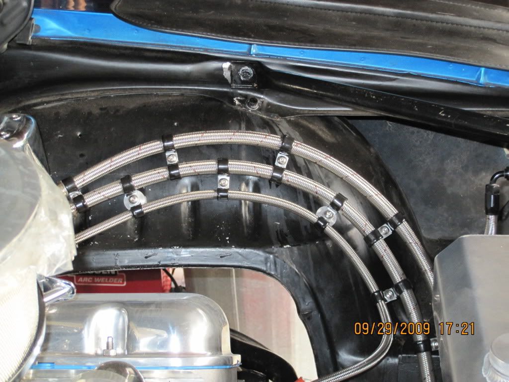

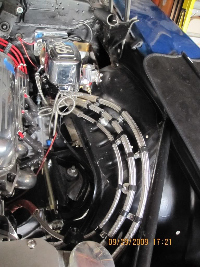

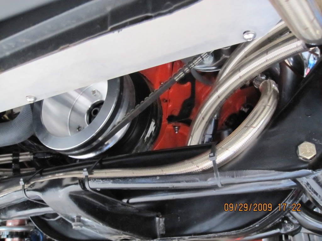

Routed all the power steering hoses and installed a power steering cooler (pictured above between oil and trans coolers):
http://i328.photobucket.com/albums/l...Routing002.jpg
http://i328.photobucket.com/albums/l...Routing003.jpg

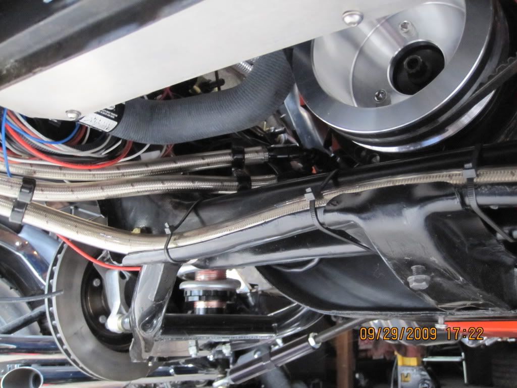

Routed P/S return on the subframe (with tiagon tubing over the braided line) back to the P/S pump. (very tight under there with those big -10 hoses).
http://i328.photobucket.com/albums/l...Routing004.jpg
http://i328.photobucket.com/albums/l...Routing005.jpg

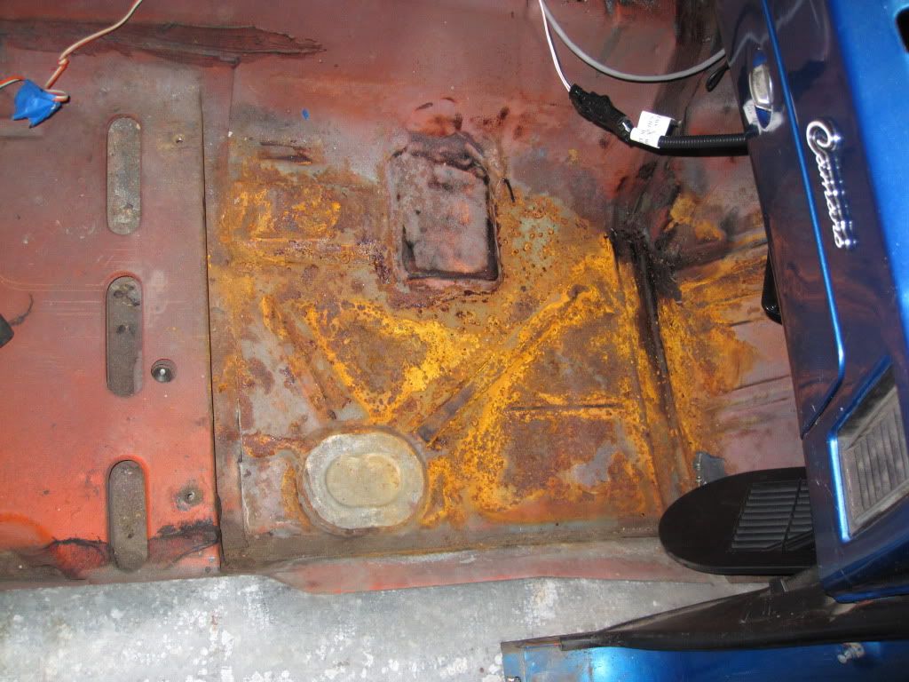

Except for bunch of rust in the passengers floor area:
http://i328.photobucket.com/albums/l...orFloor001.jpg

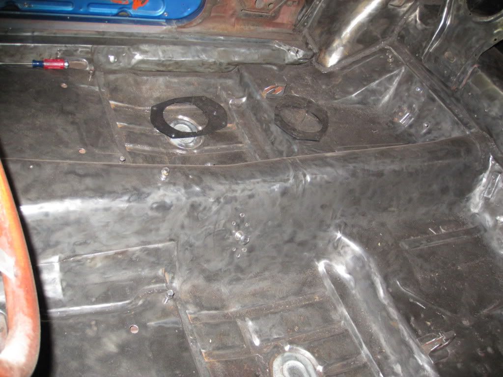

So I stripped the entire interior down to bare metal using an angle grinder with wire wheel cupped brush:
http://i328.photobucket.com/albums/l...orFloor004.jpg
http://i328.photobucket.com/albums/l...orFloor006.jpg
This is one of the messiest jobs I have ever done, not much fun at all.

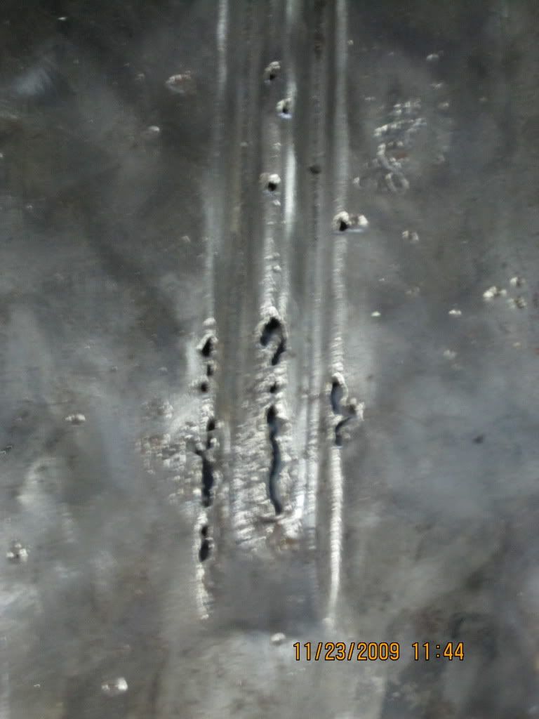

I gotta say I really hate the body shop that plastered my trunk with tons of bondo trying to hide the rust and holes. When I looked at the car when I bought it, it certainly looked ok. But once I started to stripe the trunk you could immediate tell something was up with all the bondo. Basically I need a full trunk pan, but not going to deal with it now I want to get it running.
One of the many holes:
http://i328.photobucket.com/albums/l...nkStart004.jpg

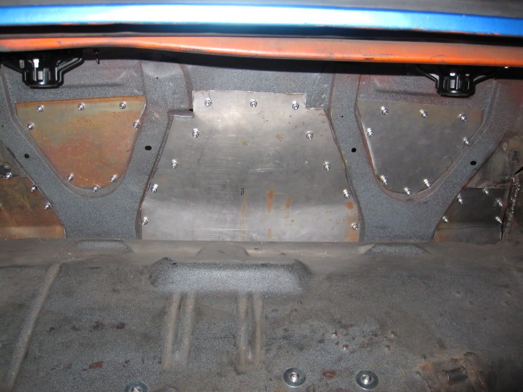

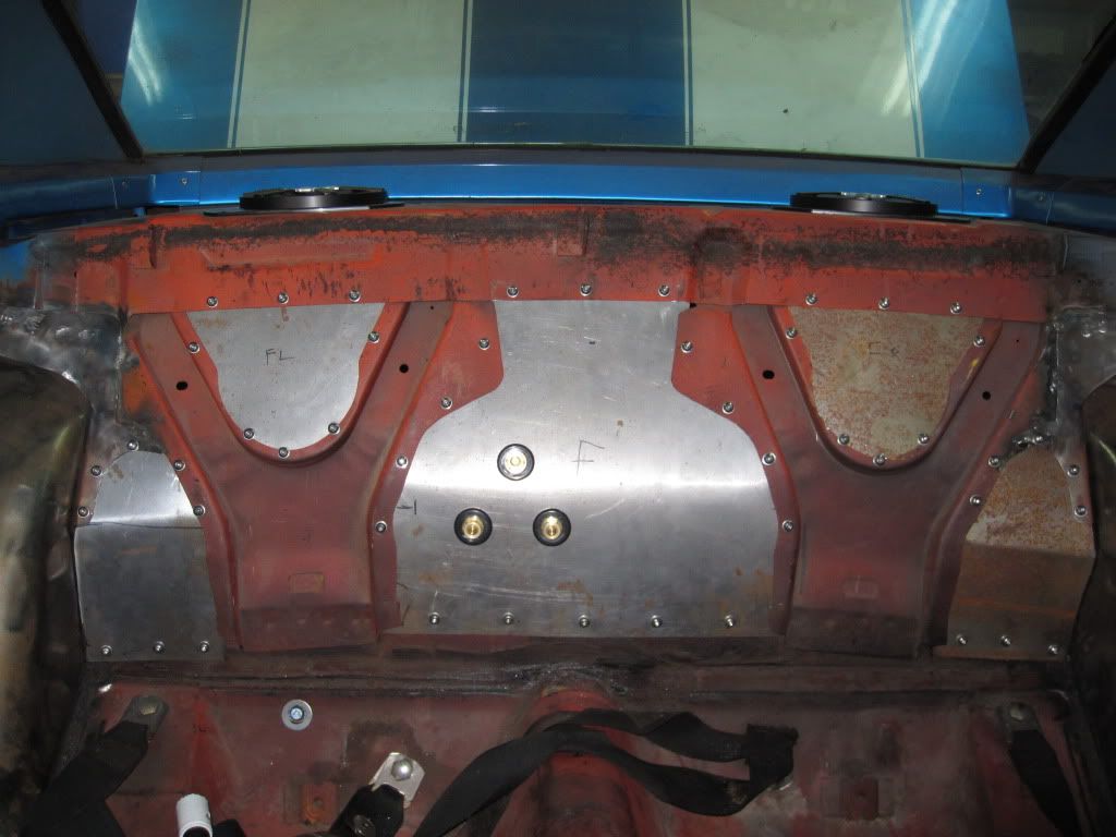

Mocked up a rear firewall that is bolt on:
http://i328.photobucket.com/albums/l...irewall004.jpg
http://i328.photobucket.com/albums/l...irewall003.jpg

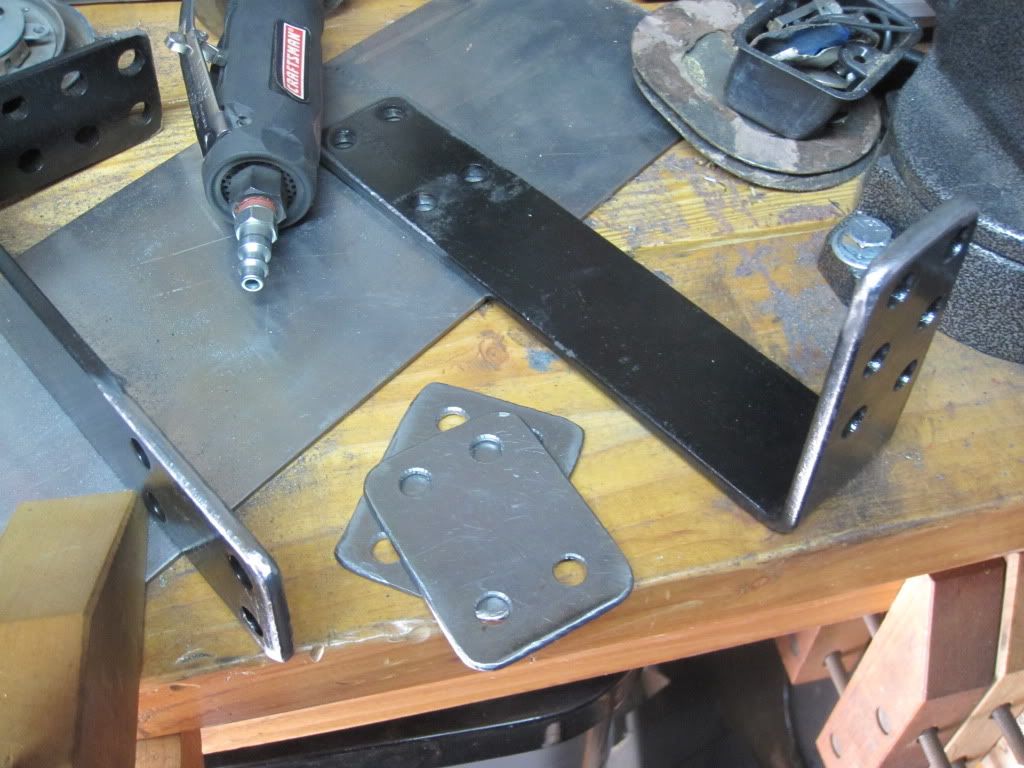

Bought Summit's kit for a drive-shaft loop and modded it to fit my application (also made some reinforcement plates):
http://i328.photobucket.com/albums/l...aftLoop004.jpg
Had hoped to install one in both the front (near the trans) and rear (near rear axle), but the rear one is out there is simply not enough room near the axle due to the large 3" exhaust.

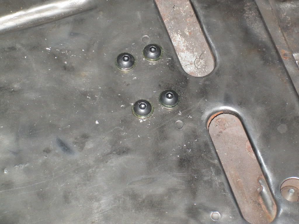

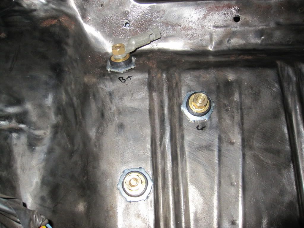

Drilled several holes in the floor boards for bulkhead fittings (drilling big holes in good floors is scary ):

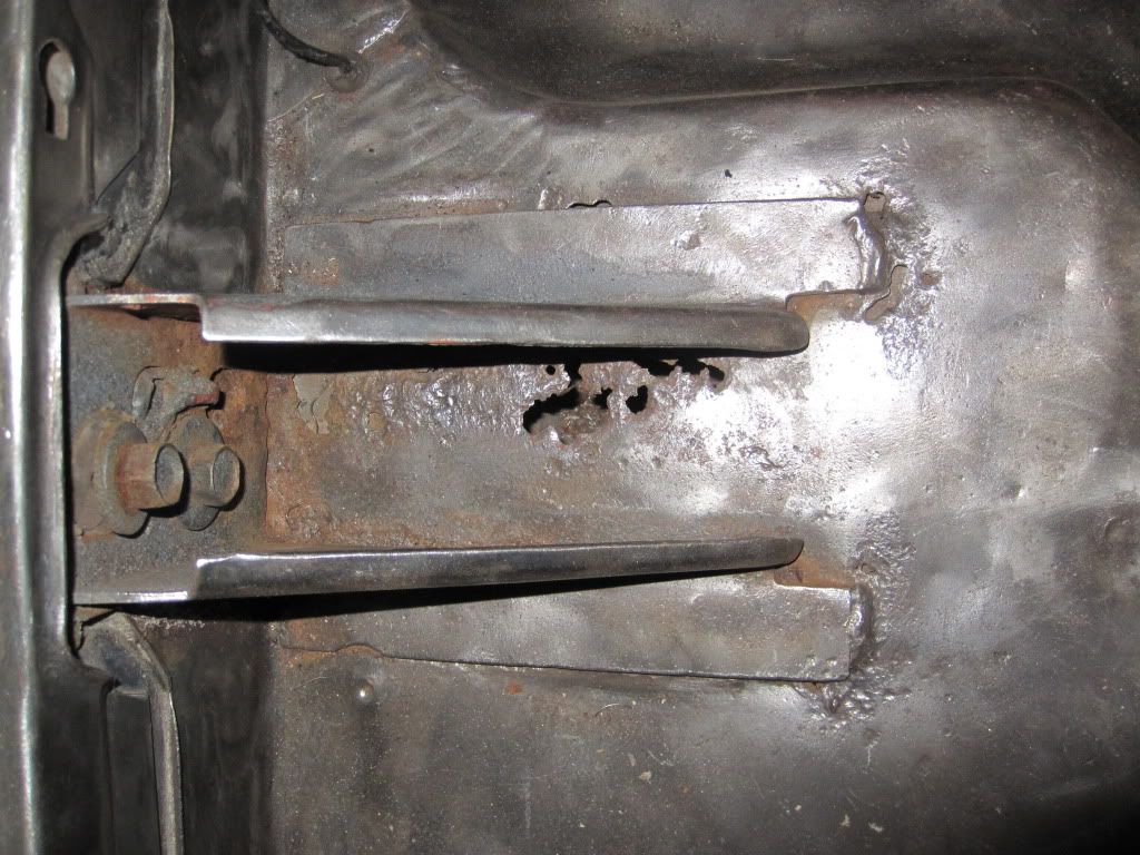

Thanks for the vote of confidence Wayne. Certainly not as bad as I have seen on this site and others but definitely not what I was expecting. Here is more pics which is kind of typical of a number of places around the trunk pan:
http://i328.photobucket.com/albums/l...r/Trunk008.jpg
And other side:
http://i328.photobucket.com/albums/l...r/Trunk009.jpg
I am pretty sure that at some point my car had been in a rear end collision and trunk pan got tweaked (you can kind of see the rippling in the pics below) which probably made the rust worse (from water leaks). You can see some welding done that definitely wasn't factory.
Someone had gone to great measures to cover it all up with bondo, and smooth it all out and paint it up nice :( Only because I did a mini-tub did I ever start finding out what was hidden beneath the surface. I would have left the trunk alone cuz it looked so purdy :mad:

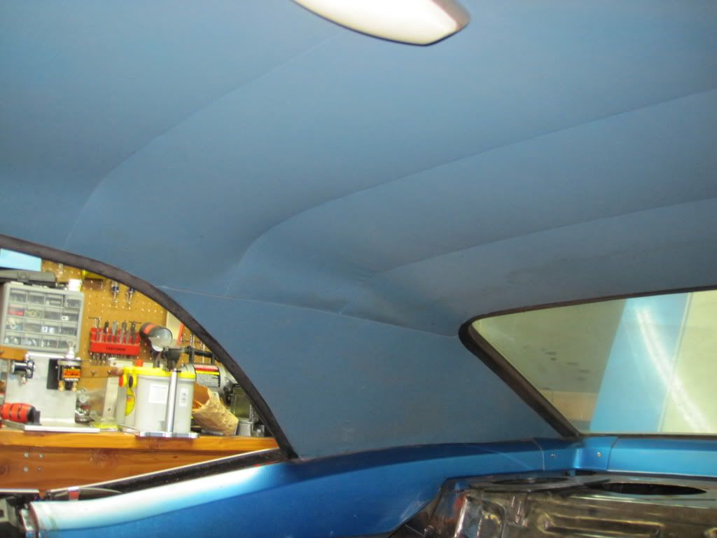

Started pulling headliner out. Pretty much one of the few areas (other than body / paint) that I haven't pulled out or redone yet:
http://i328.photobucket.com/albums/l...adliner001.jpg
http://i328.photobucket.com/albums/l...adliner004.jpg

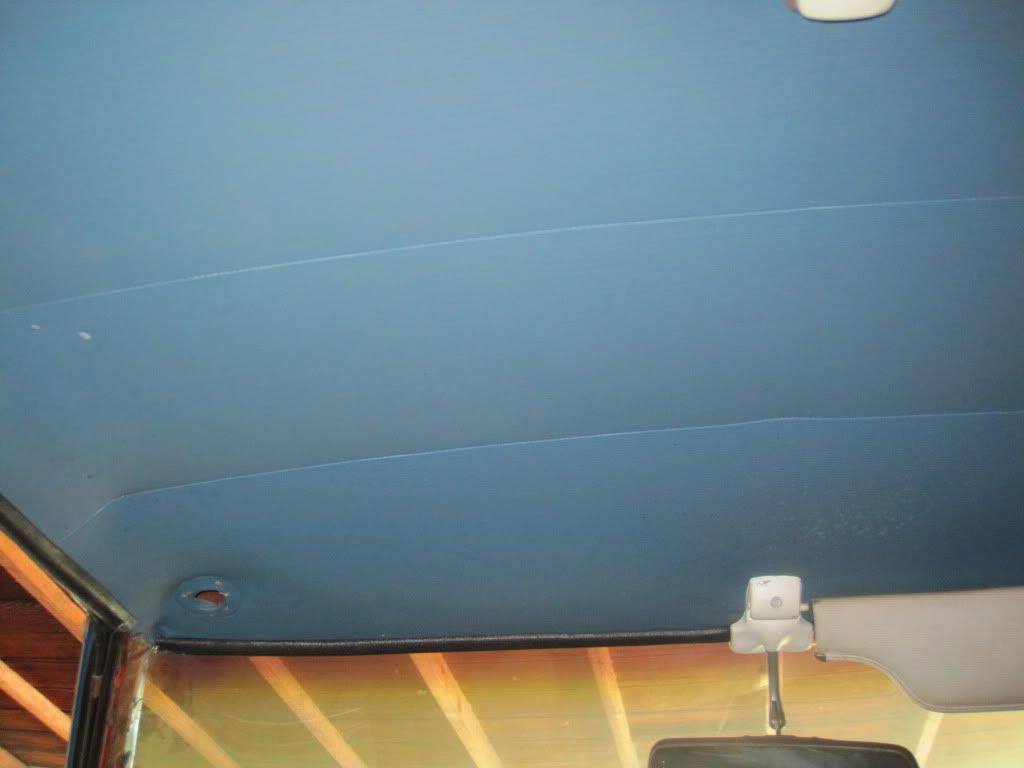

headliner wasn't too bad except for one tear near the dome light:
http://i328.photobucket.com/albums/l...adliner007.jpg
But since had the rest of the interior apart and was planning on sound deadening and insulating the interior figured I might as well do the complete interior. Also my car came with white interior with blue dash:
http://i328.photobucket.com/albums/l...maroInside.jpg
that I am thinking of changing to a black interior and since the headliner was blue was going to need changing anyways.

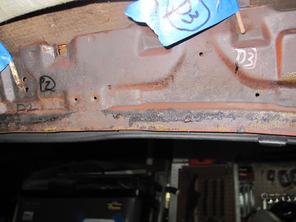

Anyways took a few reference pic/measurements also started labeling all the headliner bows:
http://i328.photobucket.com/albums/l...adliner017.jpg

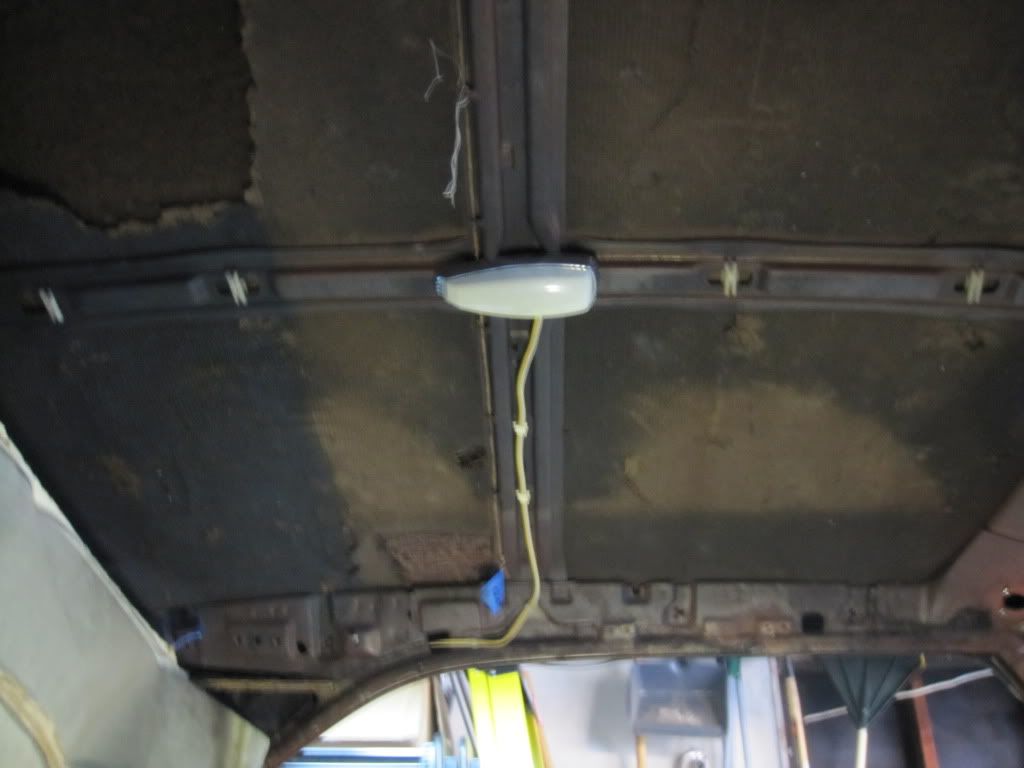

Was thinking I could maybe get the headliner out in one piece w/o ripping it, but after going slow a few rips later and I was tearing it apart. I was able to get the rear sail panels out in one piece with the tack stripes intact. So far the roof looks good. Most of the original padding seems to be in-place and intact:
http://i328.photobucket.com/albums/l...adliner026.jpg
Next up the messy part of scraping the ceiling.
