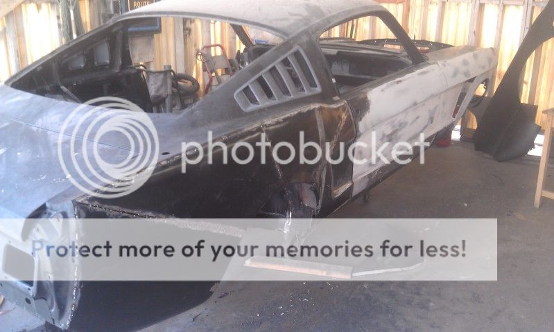

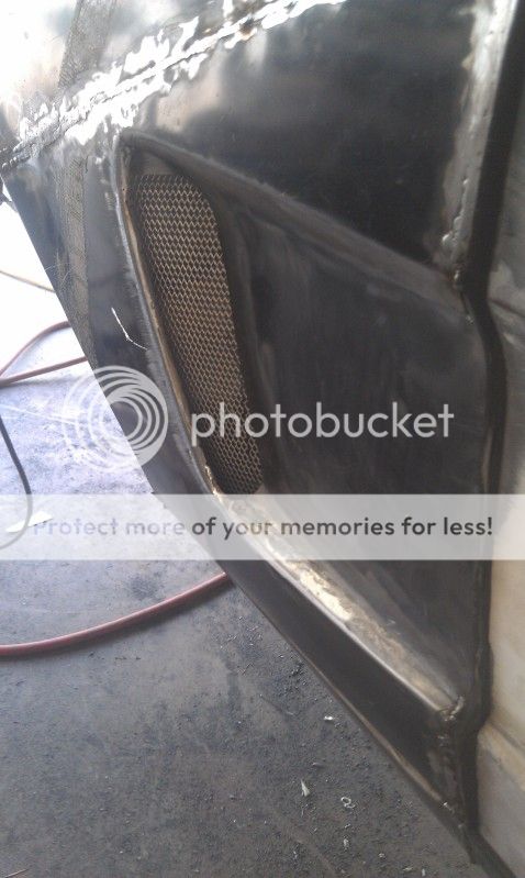

I've been working on the back part of the car, and as per usual, it has been fighting with me. Fitting the quarter initially was the easy part. The contour of the quarters has changed so much that I was forced to build my own outer wheel houses from scratch. As for the inner wheel houses, I just pushed them inwards to the factory frame rails. The goal was to get a 335 in the back, however the frame rails curve out to much at the back to be able to accomplish that, and it looks like I'll end up with a 315. Hence why DSE's new kit has an asterisk that notes that '64.5-'66 cars need to have their frame rails narrowed 1" for a 315 tire.
Made sure that I've got some space for some kind of oil cooler and/or brake ducting.

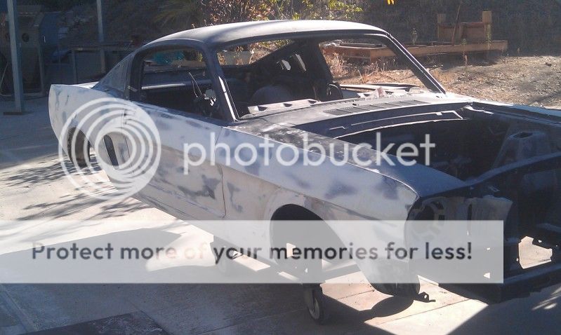

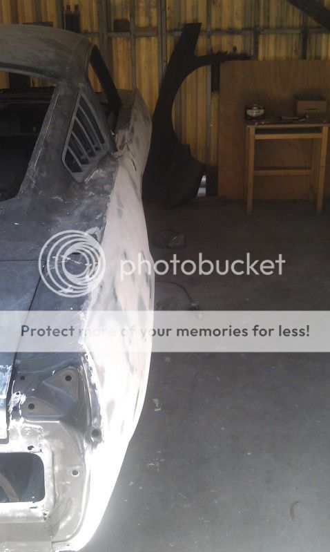

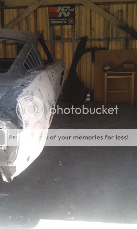

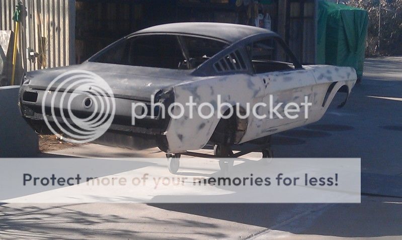

Matt@BOS 07-31-2012 11:07 PM

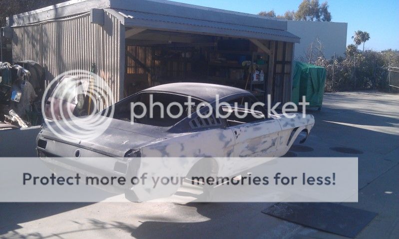

Been busy sanding filler. Since I got pretty crazy with the metal work and it looks like the car might actually turn out nice, soon I'll be handing it over to Jesus at the shop to go over the side one last time for me and fix all of the wobbles and heavy sanding scratches along the side. Then it will finally get a coat of primer, well at least one side will. I'll be busy buttoning up the other side in the mean time.
Right now it looks like one of those funny test cars with splotchy camo on it, so forgive me if the side just looks like a blob.
http://i366.photobucket.com/albums/o...A/IMAG0583.jpg
http://i366.photobucket.com/albums/o...A/IMAG0582.jpg
http://i366.photobucket.com/albums/o...A/IMAG0581.jpg

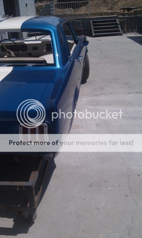

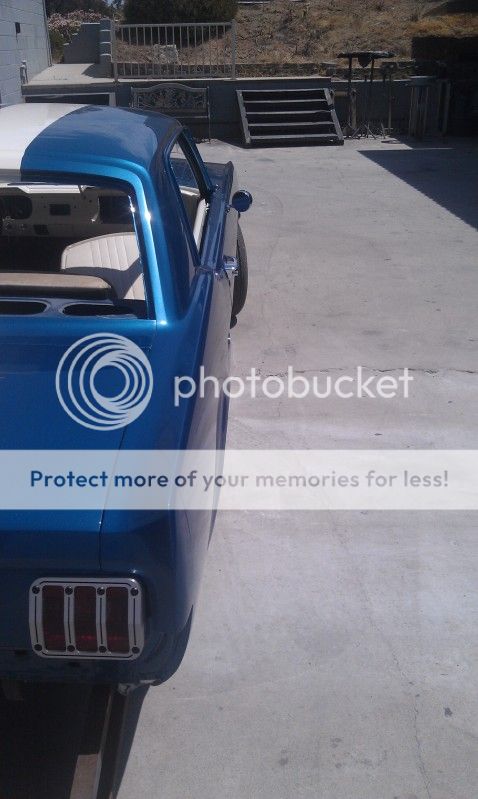

Just for reference I snapped some shots of another customer's 1965 coupé, which he has owned since new. From certain angles you can really see how much the side of the car has been changed!
http://i366.photobucket.com/albums/o...A/IMAG0585.jpg
http://i366.photobucket.com/albums/o...A/IMAG0589.jpg
http://i366.photobucket.com/albums/o...A/IMAG0586.jpg
http://i366.photobucket.com/albums/o...A/IMAG0588.jpg
