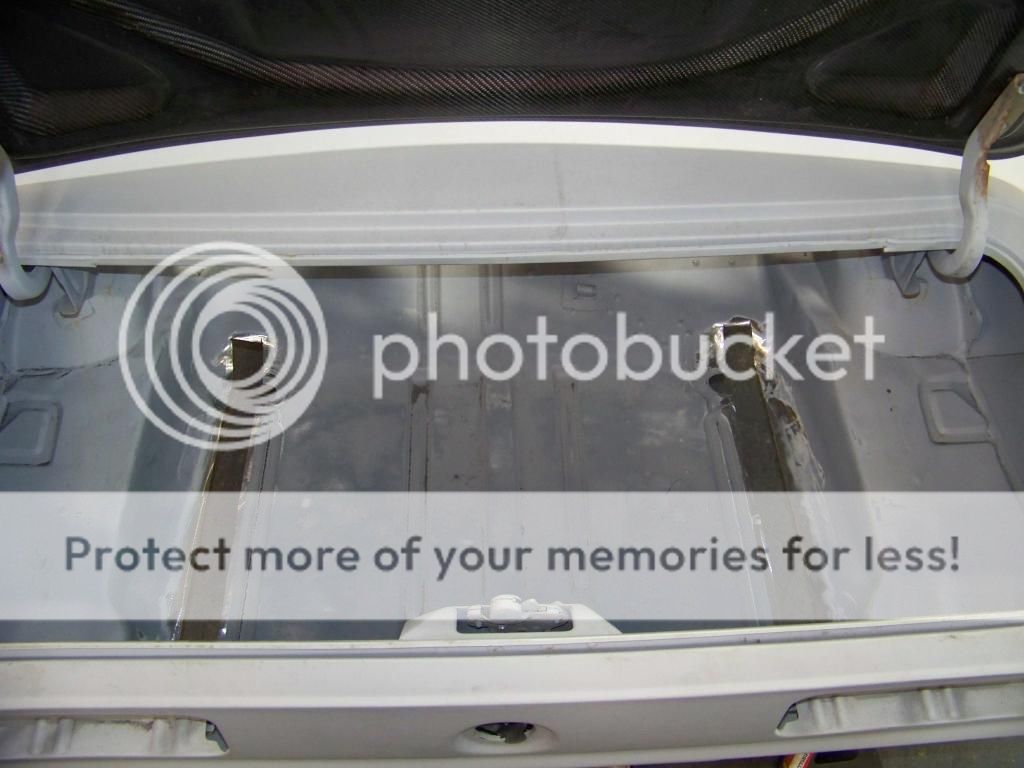

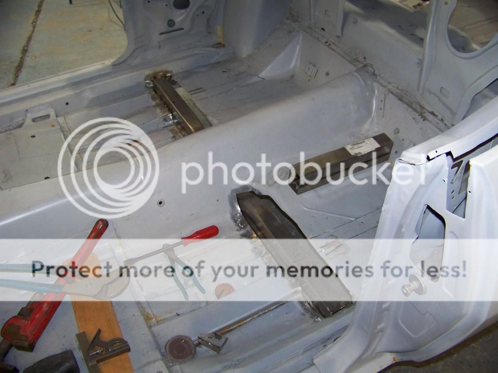

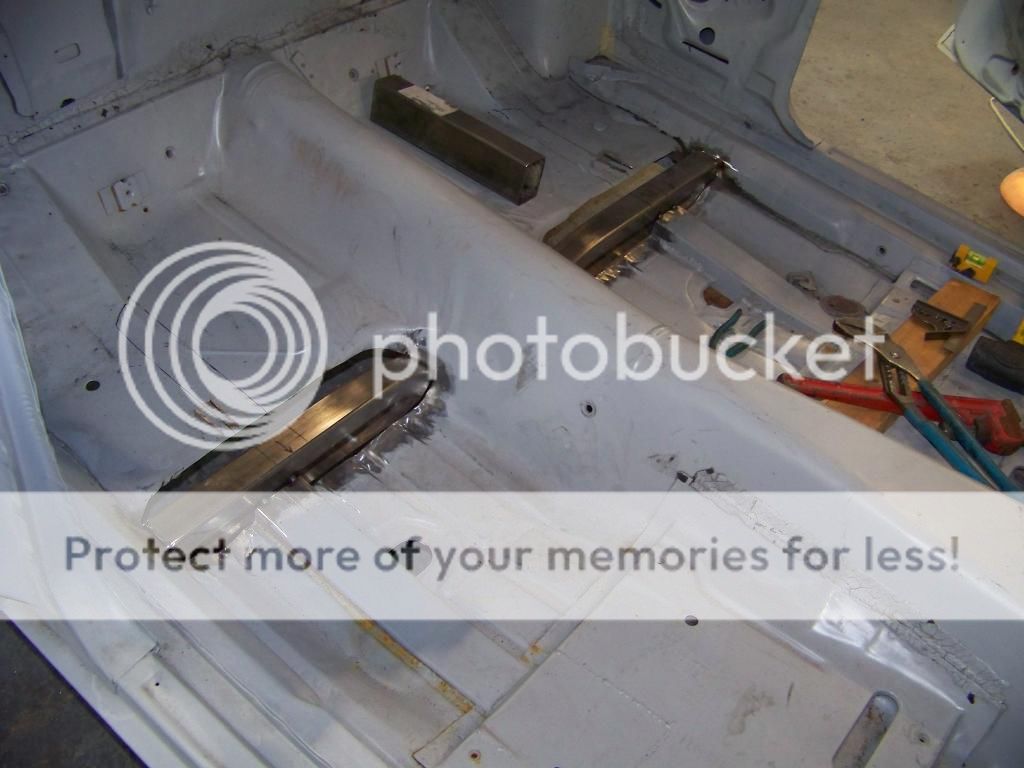

Fab progress. Mike Tolle has got the cross member located in the correct spot, from which everything else will be measured and installed.
http://i885.photobucket.com/albums/a...ps5e1e671e.jpg
http://i885.photobucket.com/albums/a...ps0615fc14.jpg
http://i885.photobucket.com/albums/a...ps5ba29afe.jpg

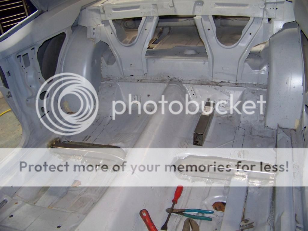

Next up is the frame rails:
http://i885.photobucket.com/albums/a...psc4e09341.jpg
