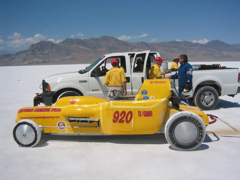

JamesJ 01-06-2007 12:23 PM
Originally Posted by nvawgn
exactly, i love watching 32 fords run 200+mph
Ron has a good car, and knows how to tune a Nitro motor.
We got the record in this car at 233 its a 29
We put a A motor in it and qualified at about 270 but missed the record run because of a spark plug wire.
Is there an easy way to make this pic smaller?
http://i143.photobucket.com/albums/r...s/IMG_3804.jpg
