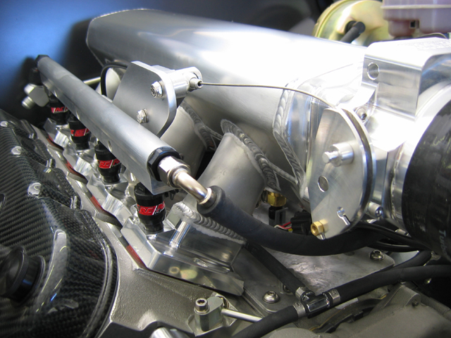

camcojb 04-27-2008 03:13 PM

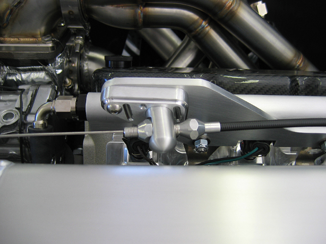

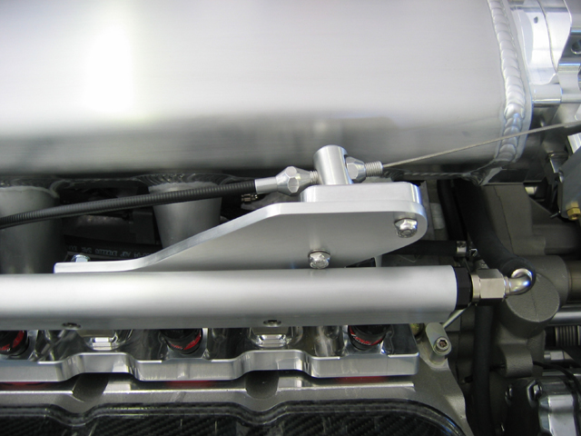

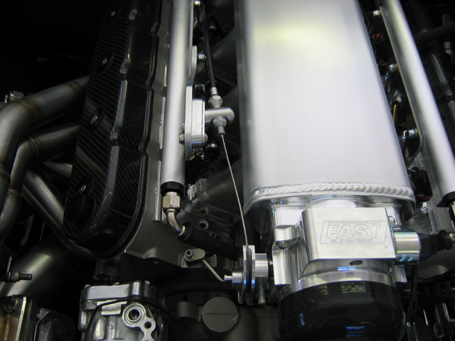

Hooked up the throttle this morning. I own a tig, but can't weld with it................... so I bought a Lokar cable mount and built a bracket to attach it to the fuel rail support. Turned out nice. The cable has a bit of an angle to it, but that's how the Lokar mount is built, and was the only way it was going to fit.
http://www.camcojb.com/temp/malitude 579.jpg
http://www.camcojb.com/temp/malitude 580.jpg
http://www.camcojb.com/temp/malitude 581.jpg
http://www.camcojb.com/temp/malitude 582.jpg
http://www.camcojb.com/temp/malitude 583.jpg
awr68 04-27-2008 05:05 PM
Looks nice, is that a universal part or LS2 specific? Are we getting close to firing it up? :unibrow:
camcojb 04-27-2008 05:27 PM
that's a universal TPI piece that Lokar sells. It's close, got to mount the coils and fill the fluids. It turns out the coils I have will be very difficult to mount the way I wanted to, so I'm trying to find some stock LS2 units.

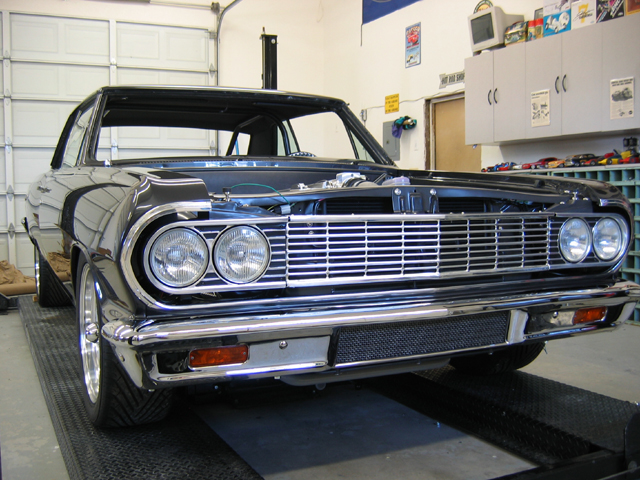

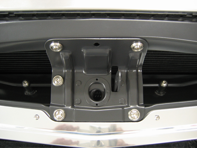

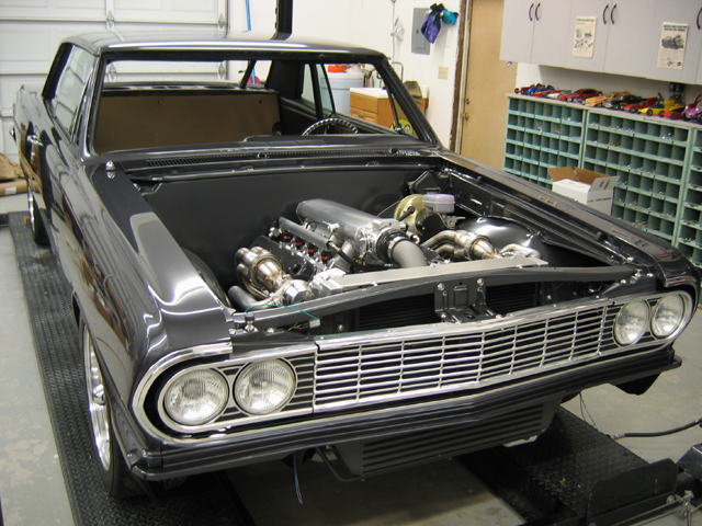

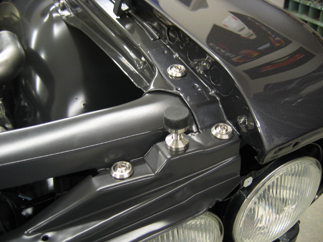

camcojb 04-29-2008 09:29 PM

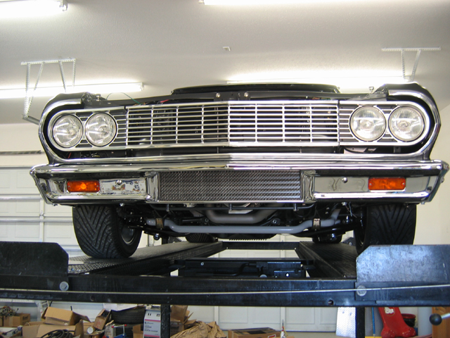

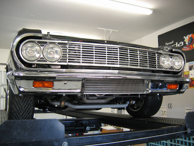

got my front support panel back from the painter (thanks Jim!!!) so now the front end can be finished. Added some Marquez Design hood stops (these are very nice!), finished off most of my Ring Bros. bolts, and fitted the front grille and trim. Only thing left is the bumper, and I'll need a helper for that.
As a side note, you Camaro guys don't know how good you have it with the reproduction parts. The 64 Chevelle stuff is in many cases horrible; quality is crap, very disappointing. All I can get though.
http://www.camcojb.com/temp/malitude%20590.jpg
http://www.camcojb.com/temp/malitude%20597.jpg
Here's the front of the car, minus bumper. Getting close, should be firing it this Friday/Saturday.
http://www.camcojb.com/temp/malitude%20598.jpg

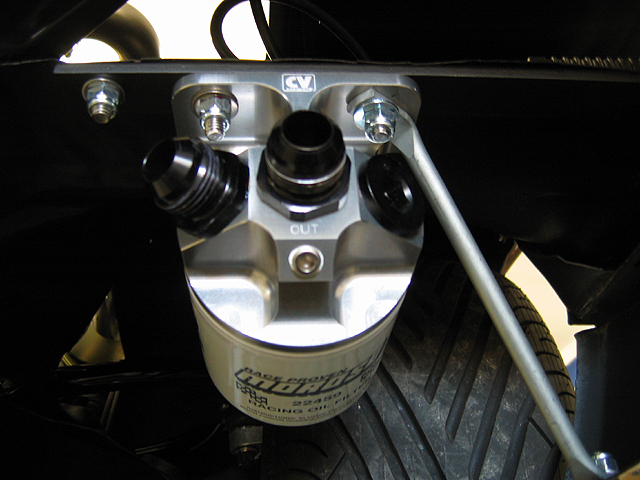

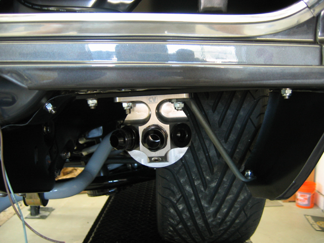

ok, moved the remote filter. Had to build a brace out of 3/16" strap to bolt to the edge of the inner fender to stiffen it up; mounted the filter on that brace and the lower fender brace, completely protected by the bumper when I get it installed.
http://www.camcojb.com/temp/malitude 599.jpg
http://www.camcojb.com/temp/malitude 600.jpg
camcojb 04-30-2008 03:40 PM
Originally Posted by 67turbostang (Post 147459)
Great job! This is the best looking Malibu I have ever seen! R u taking the car to the Good Guys show in the end of May?
well, it should be on a truck heading to Power Tour the end of May.
camcojb 04-30-2008 04:35 PM
well, so much for my new oil filter location. Forgot about the bumper brace, runs right through where the filter is mounted. Back to looking again............ :rolleyes:
