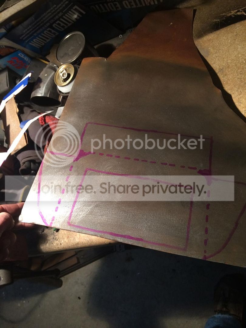

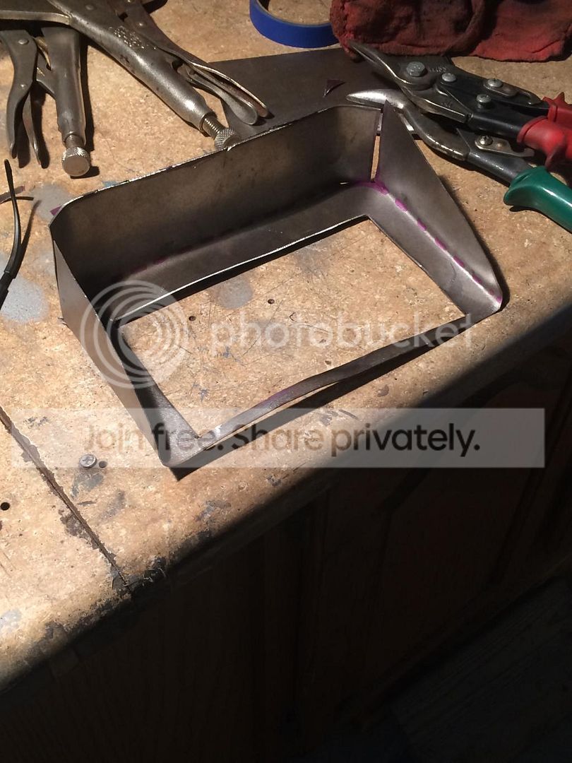

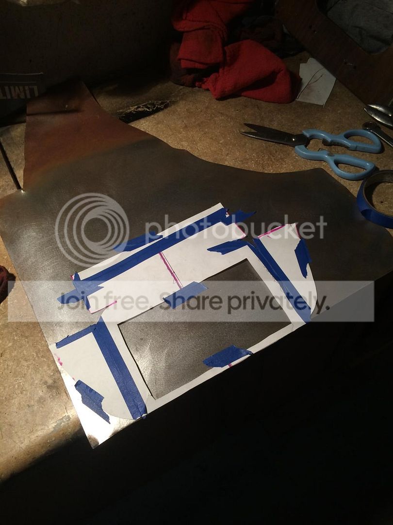

also, trying to clean up the dash and interior trim, tomorrow the dash gets all the attention, but at least now it's ready to be stripped.
http://i539.photobucket.com/albums/f...pseuprdns6.jpg
http://i539.photobucket.com/albums/f...psxovzw6cq.jpg

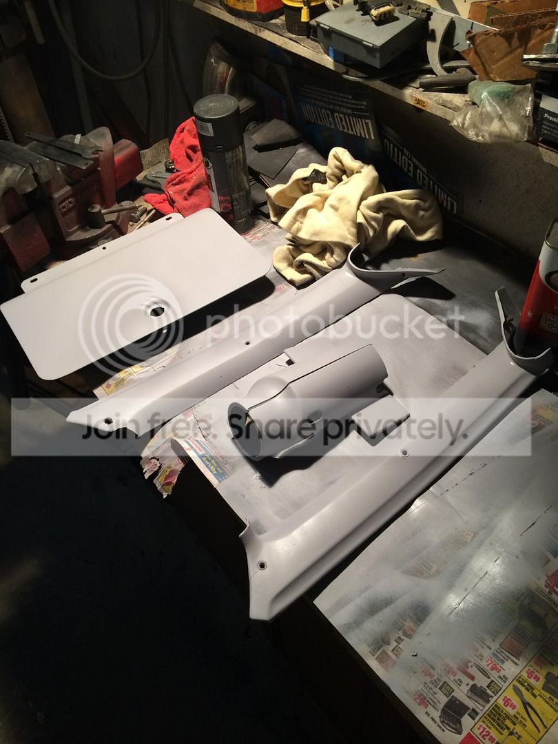

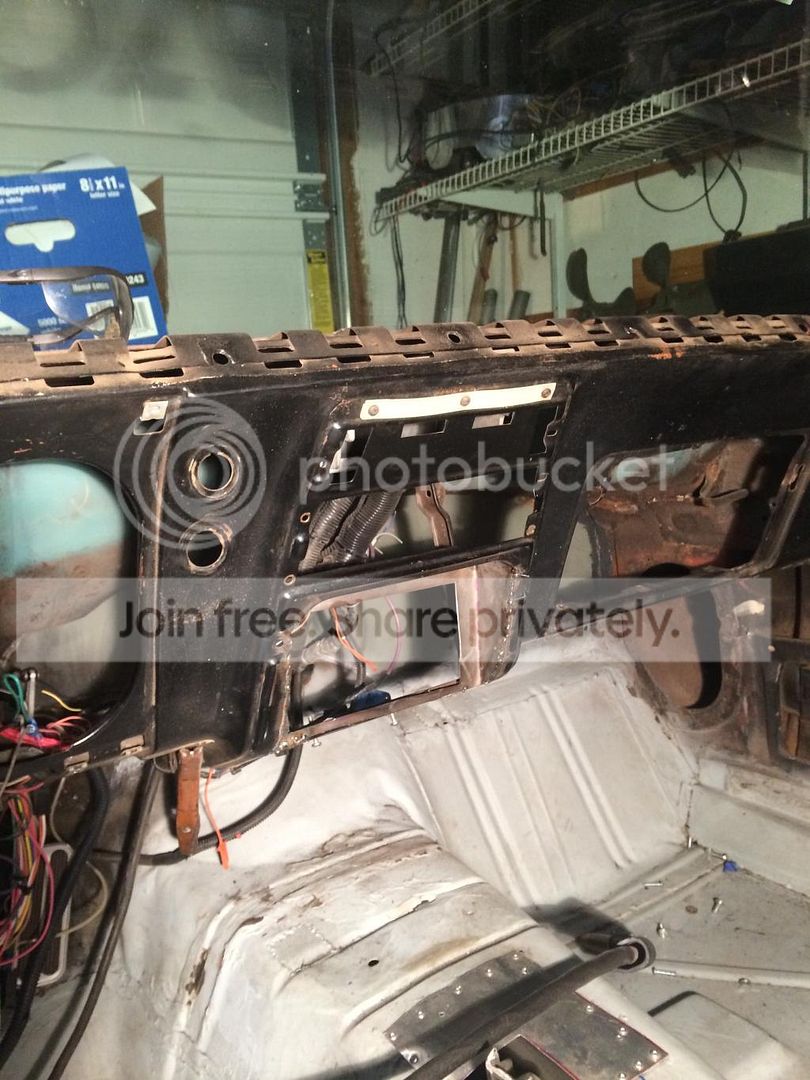

Anyway, I'm restoring the dash to go along with the new steering set up and gauges going in, So I decided to cut it up a bit to make room for a double Din Radio. I've seen some pretty cool ones that you can sync to your IPhone and run some of the apps from your phone. I'm hoping I can get my lap timer to display on the bigger screen, and at least be able to stream some 80's music from Pandora! This is what I got done yesterday, today final sanding and the black gets applied.

Everthing is restored and ready to go back into the car. And the Dash is a nice shade of Satin Black.

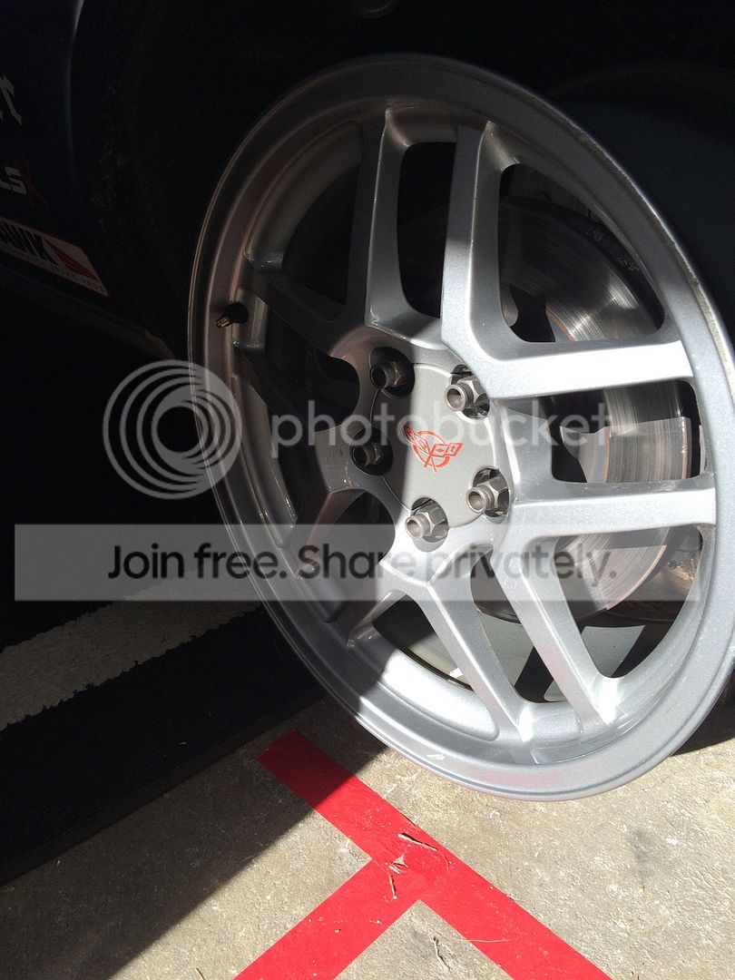

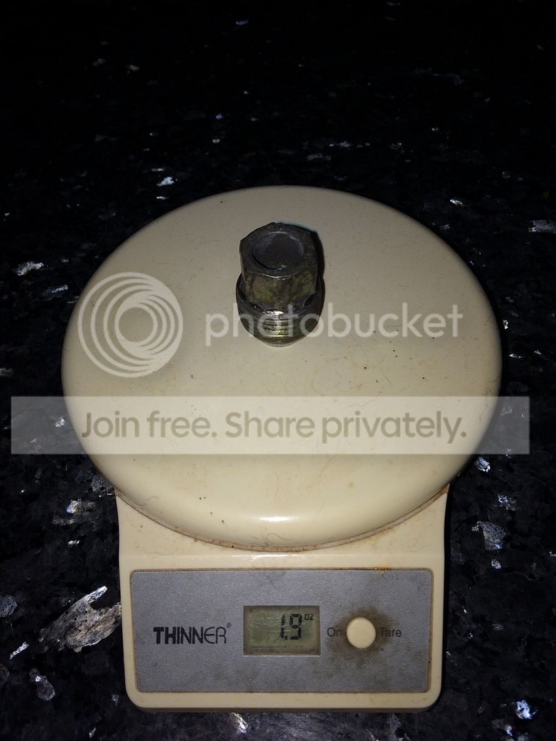

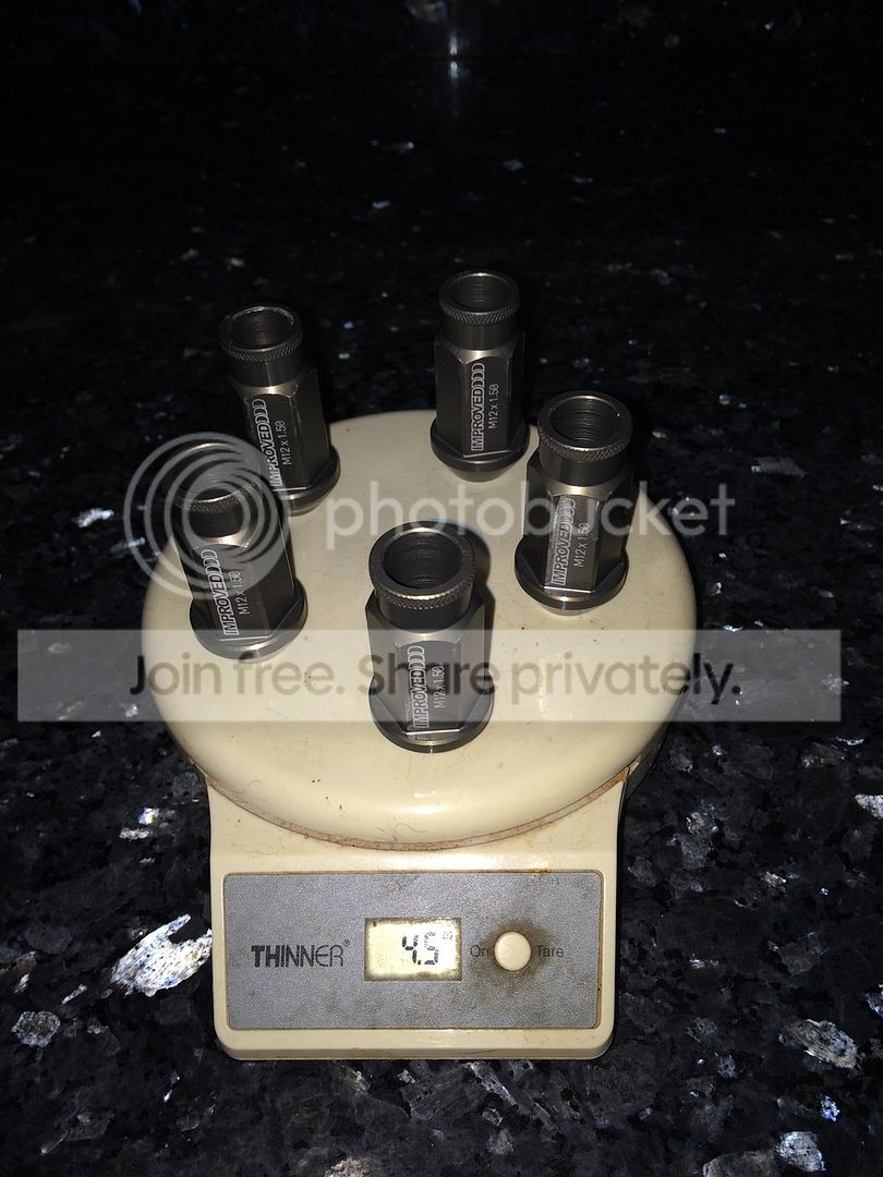

Improved Racing just sent me some Easter goodies! I told them I had Ugly nuts and this is what they came up with!
http://i539.photobucket.com/albums/f...psj9ts193n.jpg
Since I had them off the car today, I weighed them for comparison. I was off by a little with 5 = 1 but it's not that far off. Here are the scale readings (in Ounces for us old school guys)
http://i539.photobucket.com/albums/f...psiuee8ah1.jpg
http://i539.photobucket.com/albums/f...ps4vi5tic2.jpg
http://i539.photobucket.com/albums/f...pszyuawrae.jpg

Justin@EntropyRad 04-07-2015 01:03 PM
Sweet!
Have you taken it back to see if it will pass tech with the aluminum lugs? I failed tech at an autocross for having them..luckily i had some cheap oem steelies to use
Beach Cruiser 04-07-2015 04:03 PM
I'm working on some more aero stuff now, I already have the rear diffuser mocked up in cardboard, all I have to do is make it, which may happen next weekend. I need to reset both my front and rear windshields up higher so they sit flush with the body, I'm also working on closing off the front grill area more. I'm also going to add more rear spoiler area similar to what Mark Stielow did on his last car, only in clear lexan and make it adjustable. All those things are secondary to keeping the car running! ie, they are on the nice to do list, not the must do list.
I'll ask at tech next time about the lugs, I've seen lots of other cars running them, I've never seen anything in the rules saying no. I also have NASA annual tech which is good for the year, but I'll run it by them to be sure. I also learned a long time ago to take a ziplock bag full of extra nuts and studs in my tool box.
GrabberGT 04-08-2015 06:44 AM
My concern over using aluminum lug nuts was having full thread engagement. If you're not using studs long enough for all the threads of the lug nut, you are not getting the full binding strength designed by having the extra threads. The length of the aluminum lug nut is not just to look cool or add extra strength but a requirement to have the same strength of a shorter steel nut.... Just my thoughts. Did the lugs come with a minimum thread engagement note?

I wonder what minimum stud engagement is.
On a side note. These are really nice. Unfortunately they do not come in 1/2x20.
Beach Cruiser 04-08-2015 06:59 AM
I'm all good in the nut department, I'm using ARP extended length wheel studs, the stud is actually threaded past the threads on the nut so it's 100% engaged.

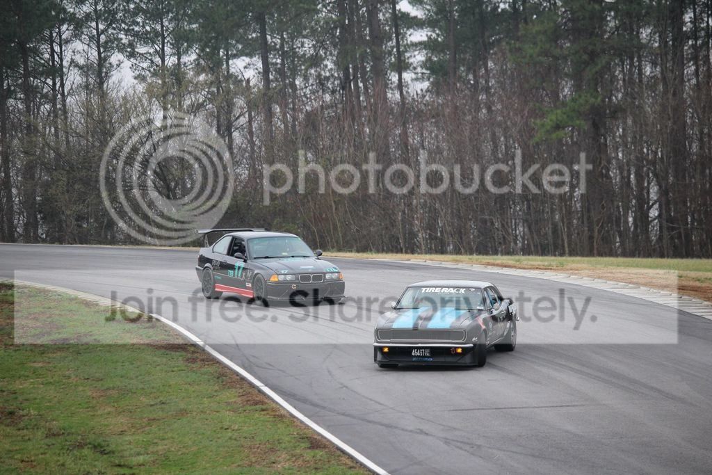

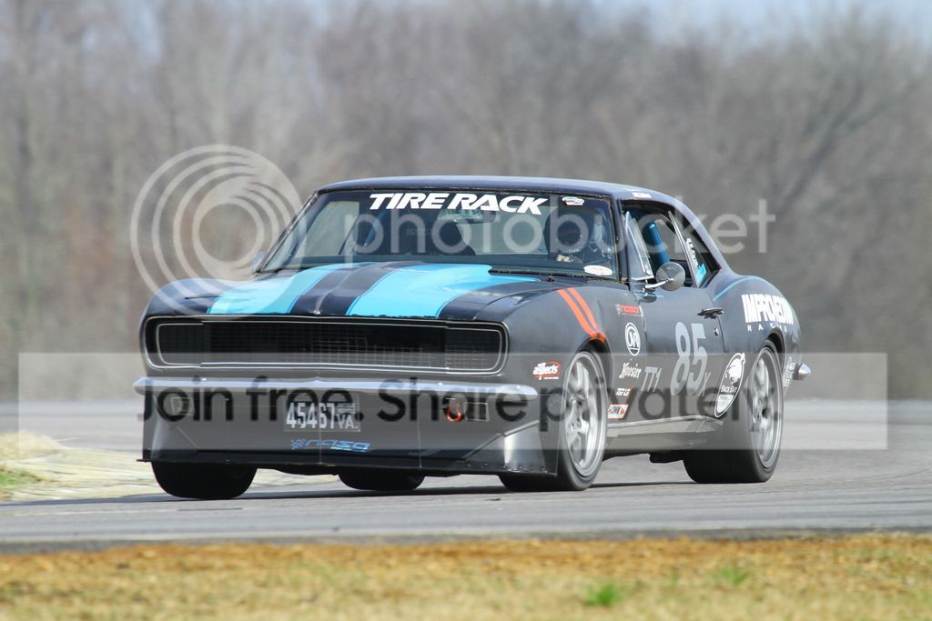

Just got some pics back from VIR from two weeks ago. Headed back to VIR May 1-2 for Hyperfest!
http://i539.photobucket.com/albums/f...psvu37z4cp.jpg
http://i539.photobucket.com/albums/f...psusbrtery.jpg
http://i539.photobucket.com/albums/f...pseoplhnr0.jpg
http://i539.photobucket.com/albums/f...pslkvatv5l.jpg
http://i539.photobucket.com/albums/f...ps1bpox6m5.jpg
http://i539.photobucket.com/albums/f...psavhqpy9n.jpg
