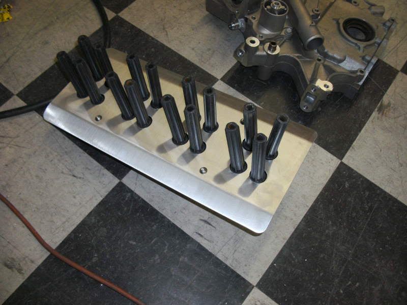

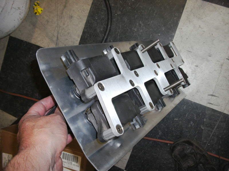

How are you going to relocate the coil pack's Ned? Are you planning to use the Indy kit or come up with something on your own?
DRJDVM's '69 01-13-2011 09:25 AM
Jeff is making me some brackets to go under the manifold. I'll post some pix when everything is finnished.

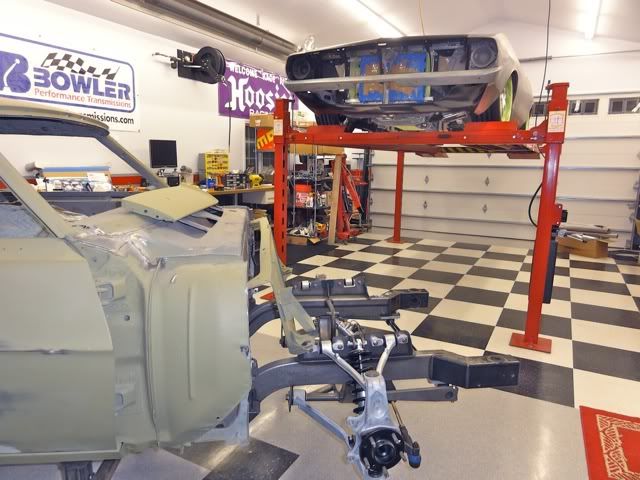

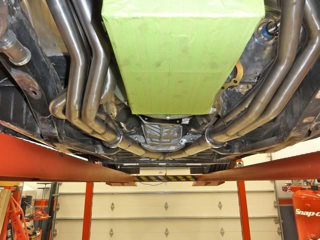

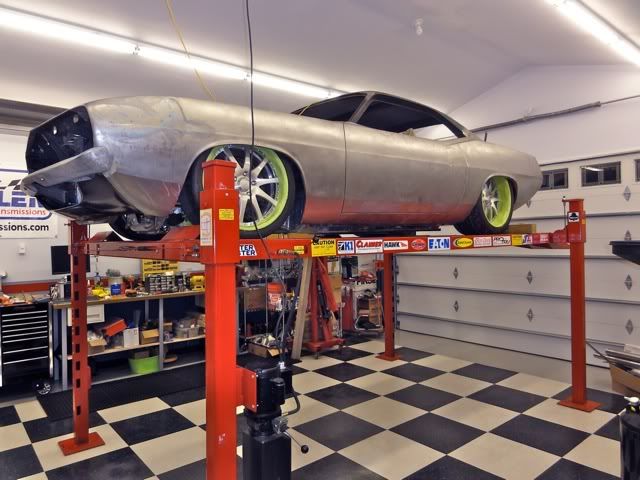

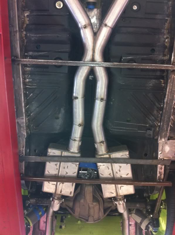

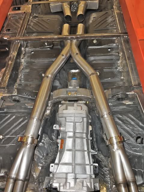

So...... took the car over to Rob's house to fab up the exhaust. Since he has a lift in his shop we figured it would be way easier than working up on jackstands...and it was. Even up on a lift, it was a PITA. Big thanks to Rob for taking time away from his family and his own project, to help me out
http://i229.photobucket.com/albums/e...t%20II/121.jpg
http://i229.photobucket.com/albums/e...t%20II/120.jpg
The exhaust turned out pretty damn good for some first time exhaust builders. I bought quite a few bends from Columbia River, and I decided on the Spintech Sportsman 3000F mufflers.....hope they arent too loud :) The pipes are a tad off center in the tunnel but its pretty damn close.

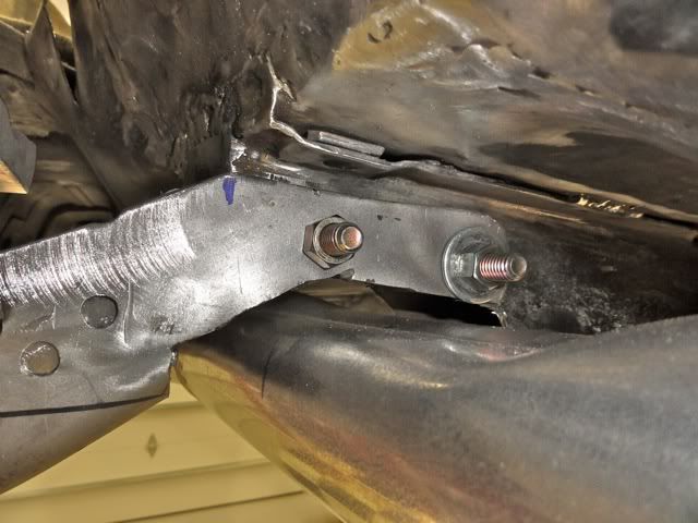

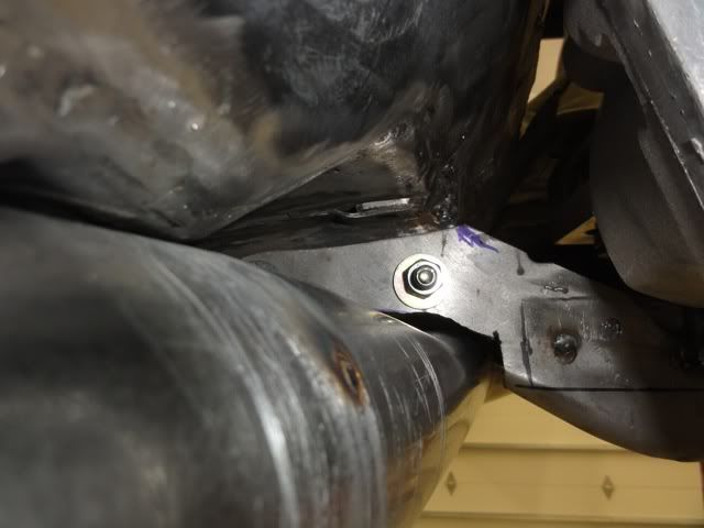

At first I was really trying not to notch the frame but the car is so low and the motor is raised, it looked terrible to have the exhasut go under the trans crossmember....so out came the cut off wheel :).... I rough cut everything and we tucked it up nice and tight. I'm making a new trans crossmember and dialing in some more clearence this weekend. The stuff in the pix looks terrible right now, but I'll get it all even and dialed in.The entire exhaust is above the frame and SFC's so you cant see it at all from the side....

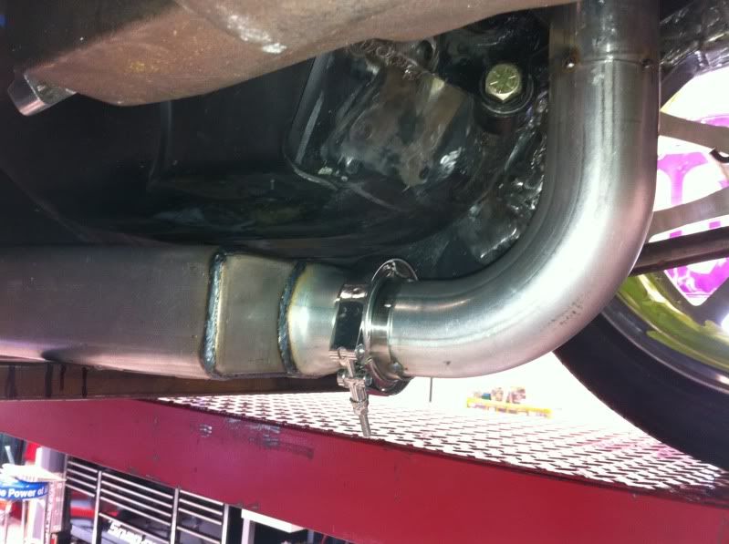

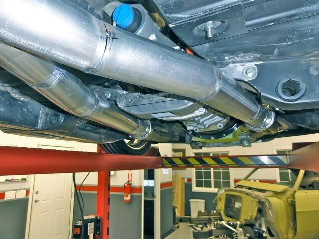

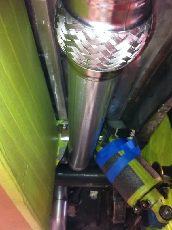

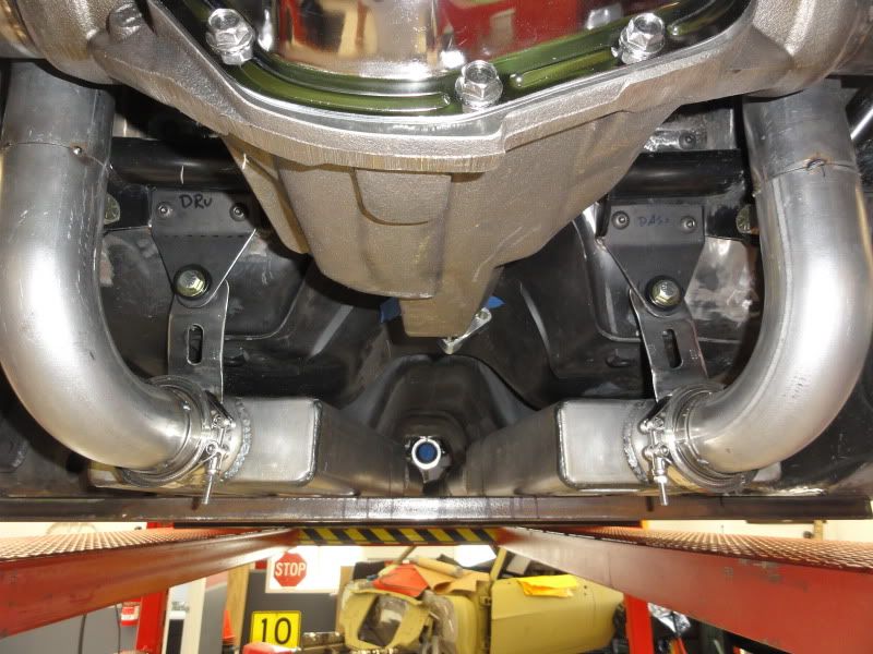

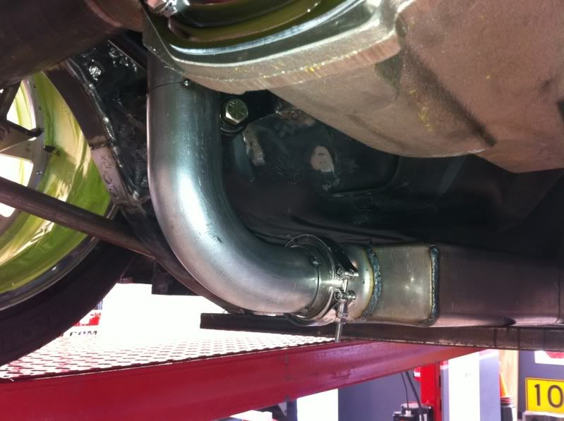

Then back to the mufflers.... The Spintechs are 3 inches deep, so I can tuck them up nice and high and still have clearence to the floor.
http://i229.photobucket.com/albums/e...t%20II/159.jpg
http://i229.photobucket.com/albums/e...t%20II/160.jpg

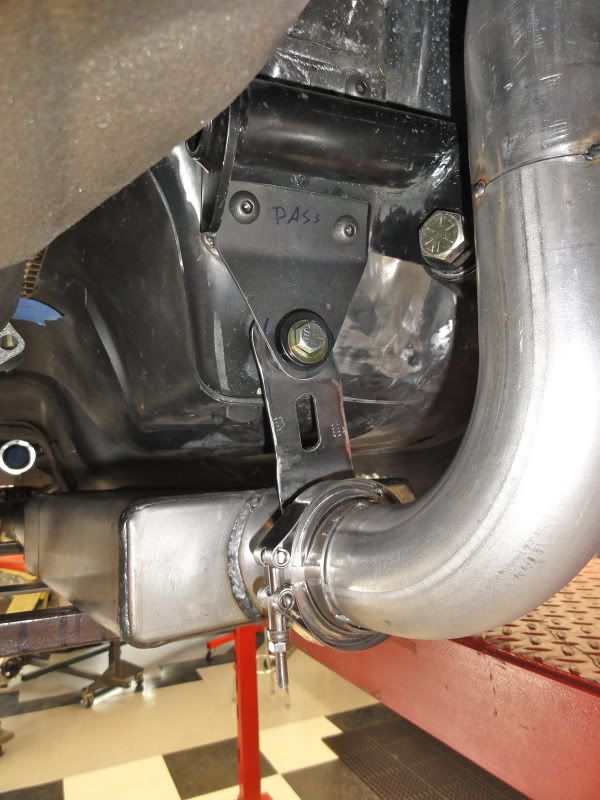

Rob and I then made some hangers using the isolaters that The Roadster Shop sells...
http://i229.photobucket.com/albums/e...I/DSC04678.jpg
http://i229.photobucket.com/albums/e...I/DSC04677.jpg

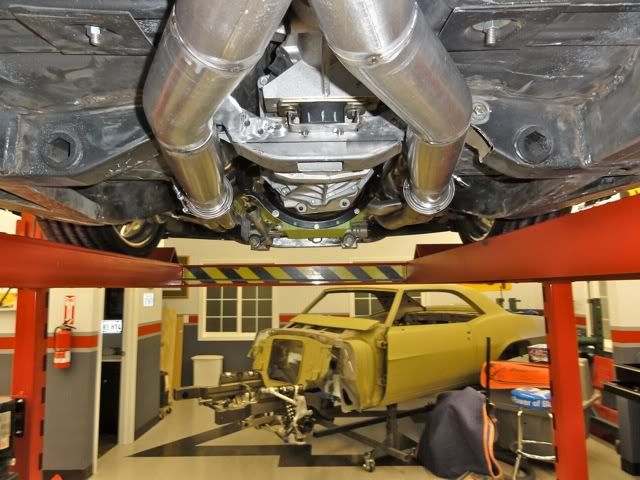

Not too shabby...
http://i229.photobucket.com/albums/e...t%20II/165.jpg
http://i229.photobucket.com/albums/e...t%20II/167.jpg

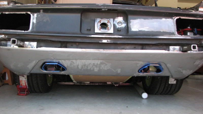

I left the tailpipes alittle long so I can dial in the exhaust tips later
http://i229.photobucket.com/albums/e...5-12001008.jpg

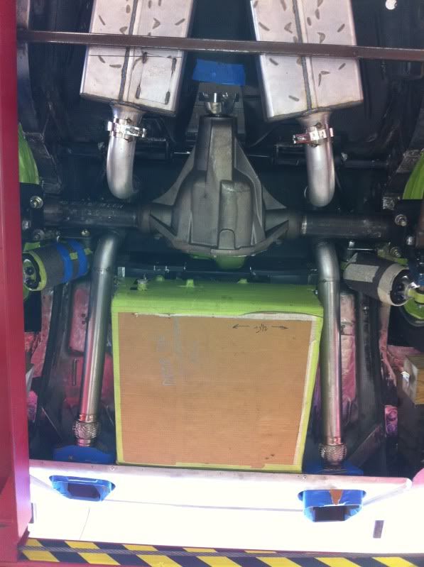

I went 3 inch from header to muffler and then 2.5 inch over the rear and out the back. With the Air Ride, it gets pretty tight back there when I drop the car...plus it will tone down the Spintechs alittle too....
http://i229.photobucket.com/albums/e...t%20II/162.jpg

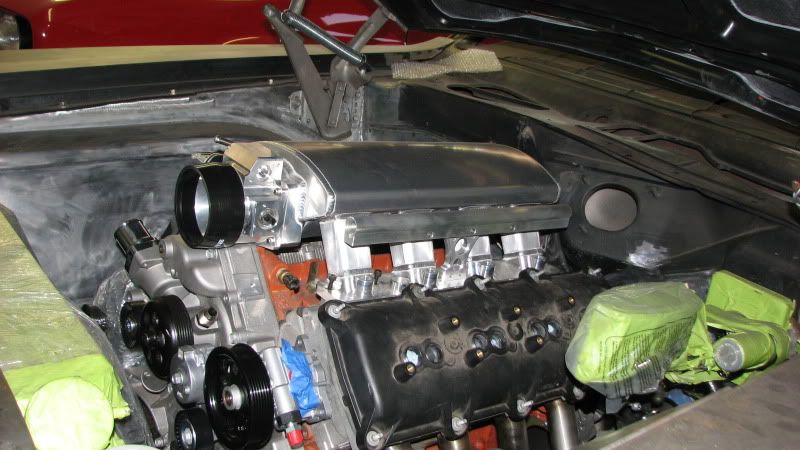

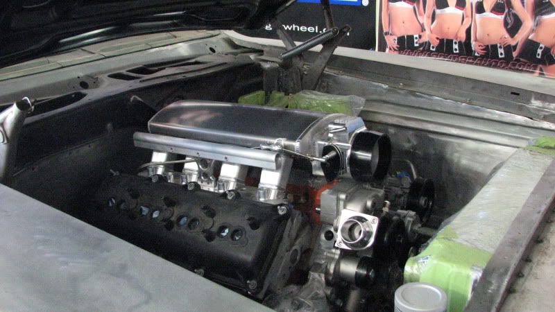

Jeff Davis at Precision Metalcraft got the intake all made for me a couple of months ago, but havent had the time to post pix up. He let me borrow the original prototype as a test fit and then modified the original design to be alittle shorter and more compact so it all fits under my hood. He also machined my front timing chain cover to remove some un-necessary "bulges" and add some AN fittings. The he had a mounting plate so I can run my coils under the intake and really clean up the valve cover area.
The intake is gorgeous....its really going to make the car stand out from all the other Cuda's with a 6.1 HEMi transplant

Yeah the exhaust was a challenge....especially since neither one of us had built a custom one before....lots of angles to visualize and fine tune the cuts just right to get the angle right and the joint tight. Rob knows a local guy that is awesome at TIG, so now that its all tacked together, I'm gonna pay him to weld the joints all purdy :)
I bought the mufflers straight from Spintech, so I just had them do the muffler exit at 2.5 inches...so the reducer is built in already.

That intake is awesome, gonna be a nice looking package with the coil mounts under the manifold.

I love the look of the intake, are you going to leave the motor mopar red/orange and the valve covers satin black? I think that look is killer. :)
