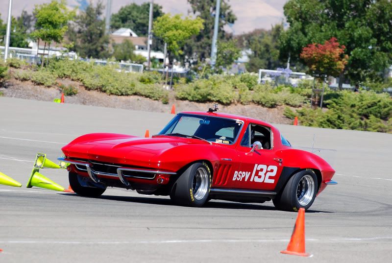

Mark,
The Corvette flares were done well over 30 years ago and were hand made. The car was flared the first week the original owner received it and they grew over the years as tires were getting bigger. There are not any molds of these flares. We get a lot of compliments on the flares. The body line continues down the side in the flares and they do not look added on. We run a 335/35/17 in the rear on a 17 x 12 wheel. A 345/35/18 or a 345/30/19 will fit with no problem in the rear. The front fits a 315/35/17 with a 17 x 12 wheel perfectly.
http://i80.photobucket.com/albums/j1...oX42907235.jpg
I will be taking the Corvette to RTTC II and you can see it in person if you are there. I will have 315/35/17 all around for that event.

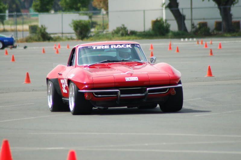

Dan,
We run a spec 15" Goodyear bias slick 25x11x15 front and 27x11x15 rear. It is the GT/GT1/GT2 spec tire. Mike and Frank use a 16" G19 setup. Our local class uses the spec tire to keep the class as even as possible. It is a great tire as it has good stick and wear.
Here is a photo with the Goodyears on it.

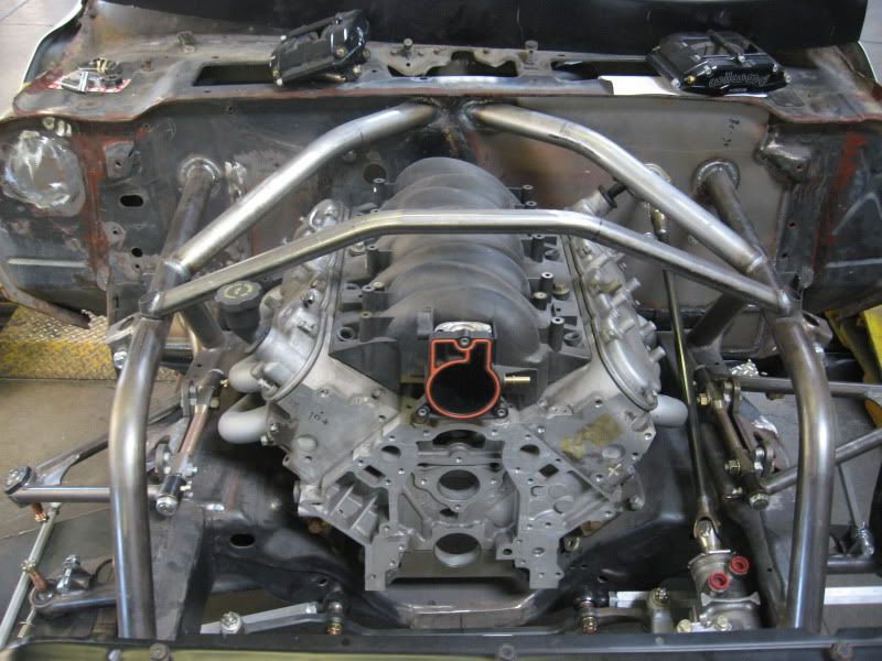

The engine and transmission are going in tomorrow. Here is the last shot with an empty engine compartment.
