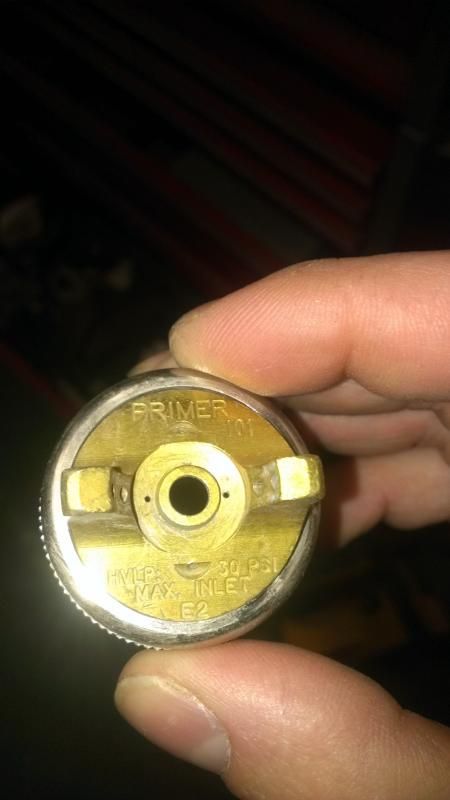

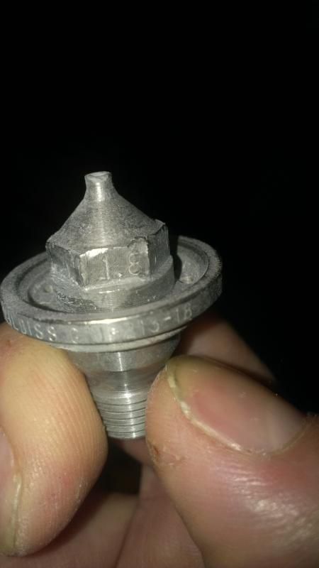

streetbird 02-05-2014 02:28 PM
I use this 1.8 tips
http://i9.photobucket.com/albums/a56...psfb9886e4.jpg
and this primer nozzle
http://i9.photobucket.com/albums/a56...ps935c0c00.jpg
on a 670s devilbiss and it spray perfectly.
Check what size you use.
Also, check the packing in your gun and check if the nozzle had a blocked hole
makoshark 02-05-2014 02:44 PM
Thanks for the pics!
The tech sheet for the particular primer I'm having trouble with, says to use a 1.5-1.8. I first started with a 1.5 and quickly changed over to a 1.8 tip. My nozzle is different than the one your showing. Do you have a part # for that particular nozzle?
