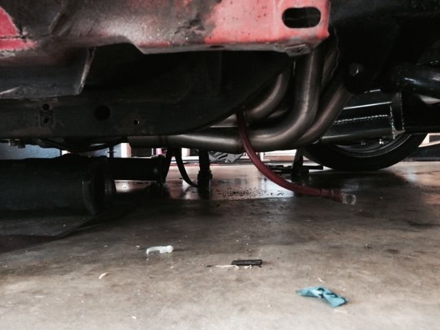

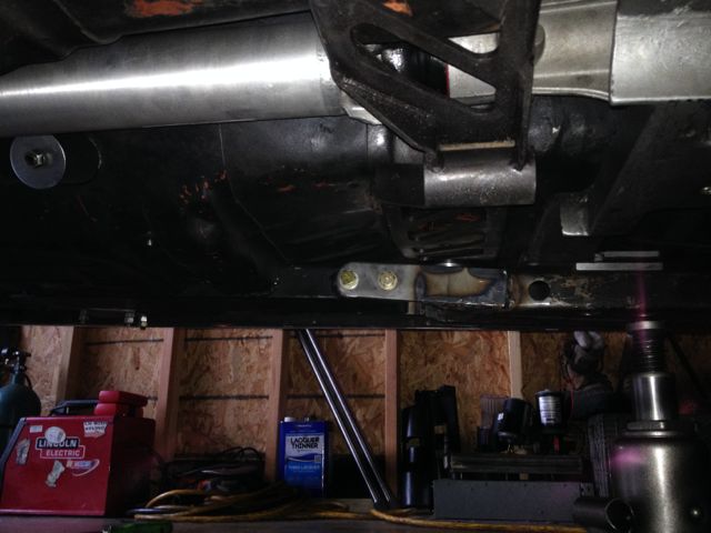

So I looked at my header clearance and I have 1.25" between the header and the floor. From the stand mounting surface on the frame to the face of the adapter plate there is 3.5".
I think you'd be ok on the gap to the floor with the 1/2 height body mounts and if the clamshell setup is about the same 3.5" the SW's should work.....maybe lol
I bought the headers on sale at Colorado Speed. Looks like they are $867 right now.
They hang a little lower than I thought they would but they don't hang lower than the QuickTime bell or the gforce crossmember. So I guess I'm good with that....

Thanks for taking the time to get those measurements.
I measured up the clamshells on the mounts in the car. They are ~3 1/4 from the frame to the back side of the shell. Pretty close to your measurements given there was also so slop with the bolts.
Given the measurements you provided and a good point Mike made to me about flanges catching on things more than slip joints I'm really reconsidering the SW over Kooks. The price at you showed me certainly doesn't hurt either....

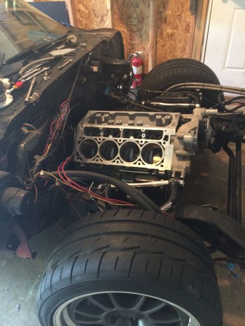

gerno 08-22-2014 08:36 AM

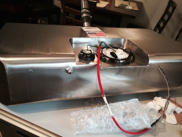

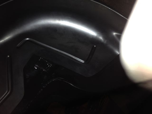

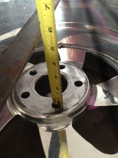

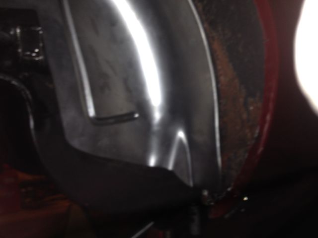

10 Attachment(s)
I've made a little bit of progress on the car but am still waiting on a few more parts.
I decided to go with a vaporware tank with a ZL1 pump. The guys at Ricks did a great job and were terrific to work with.
Attachment 49899

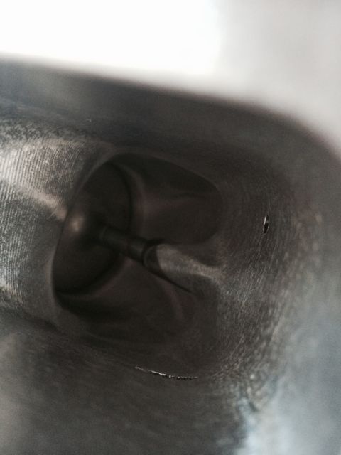

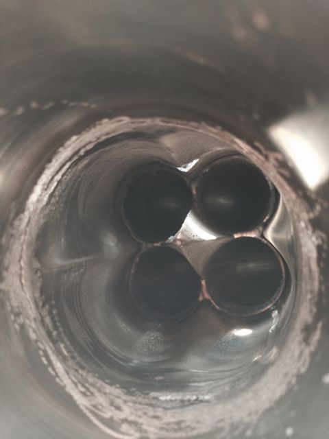

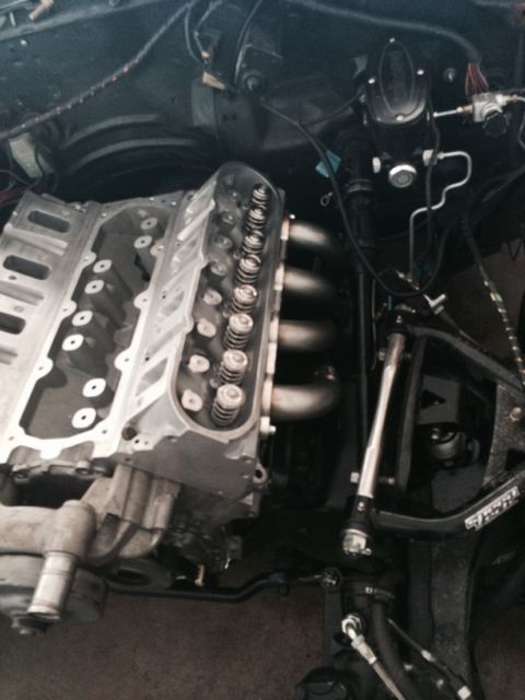

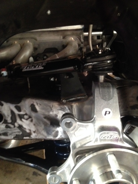

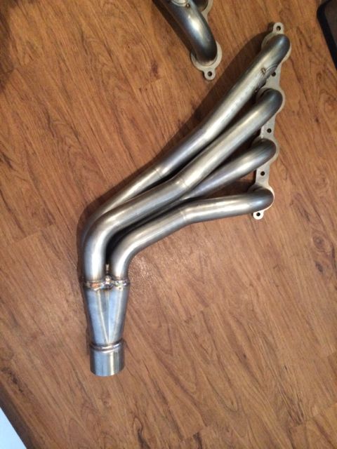

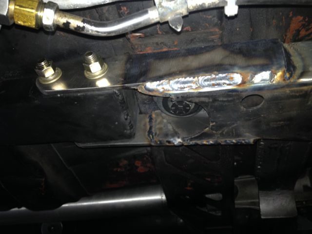

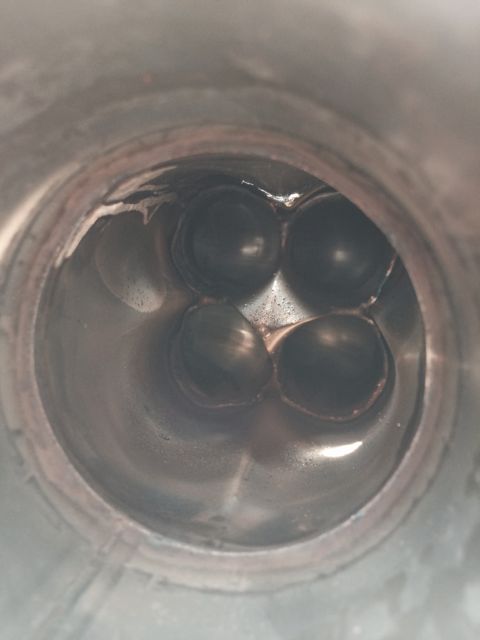

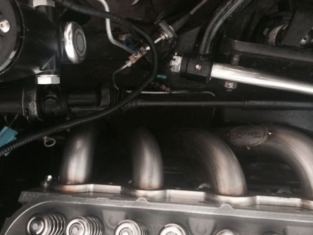

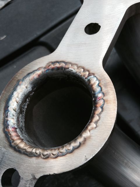

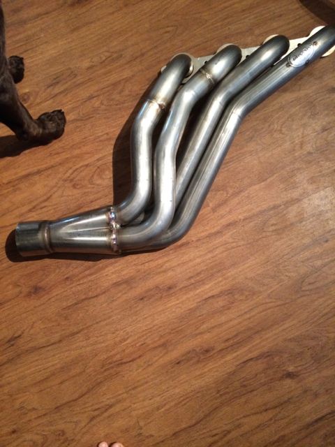

I also received my SW headers. In general these are nice but there were a few things I noticed could have been improved. At the collector they pinched the tubes down and did not clean up the inside. Also on the primaries they could have done a better job cleaning the area after the welding too. Nothing huge that a die grinder and some time couldn't fix. I did use the plates they sent and the fitting of the block with the clam shell mounts seems to be perfect. I never pulled the trans so it's in the exact position it was with the SBC. It bolted up pretty well, only needed to move maybe 1/2" which was simple.

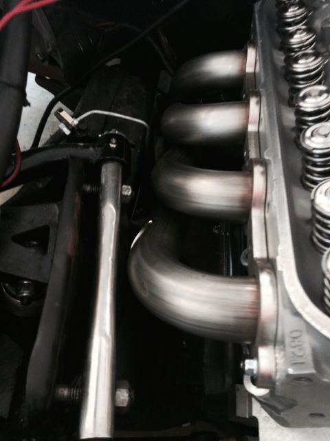

I am very glad it is an aluminum block. It makes test fitting things soooooo much easier. Next thing I need to work out is the Alt/PS mounting. I want to place the alternator on the pass side below the water pump where the A/C compressor used to be. I also want the PS down fairly low on the driver side almost like the SC PS. I need to fab up some mounts when I find some time
Attachment 49900
Attachment 49901
Attachment 49902
Attachment 49903
Attachment 49904
Attachment 49905
Attachment 49906

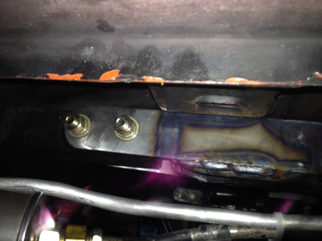

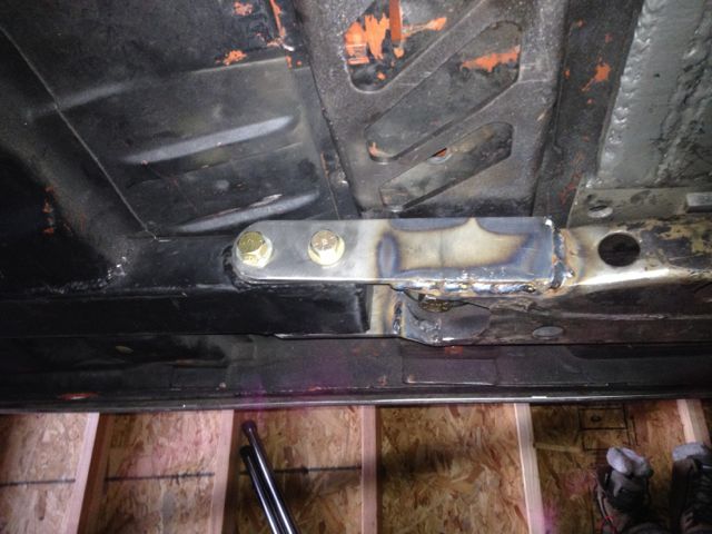

Here is the factory 2010 Camaro mount with SW plates and Speedtech Pitman
Attachment 49907
Attachment 49908

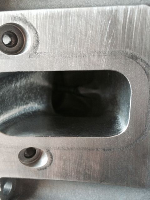

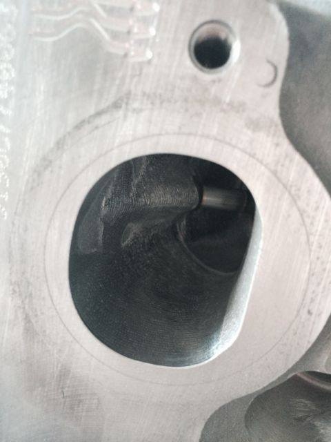

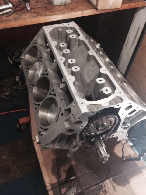

Internal engine wise i have most of the parts. The block is honed for the new pistons, rotating assembly fully balanced with crank keyway added for the balancer. Custom cam from BTR is in along with the Johnson tie bar lifters. I'm only waiting on the heads.
TEA has the port and valve blueprint (45/50 angles) complete but also needed to change all the guides. Apparently they were completely worn out with only ~28k miles. BTR should have the heads now for final blend and assembly. I hope to get them back late next week.
Goal is to have the car running just after labor day. It's a bit of a stretch...
GregWeld 08-22-2014 08:47 AM
I'm surprised at those headers --- you're spot on -- the weld quality - and in fact the mounting holes are not what I would expect. Sloppy!
Glad it's coming together Steve! It better be up and running when I get there the end of September for Lonestar Nats!
Salt Lick and Franklins here we come!!
Sieg 08-22-2014 10:30 AM
The headers look like an apprentice may have done them. :headscratch:
CURVES 08-22-2014 03:08 PM
I think you may be right Sieg, certainly a different welder did mine. Also mine appear to have a different collector.
This is why I hate recommending parts or companies.

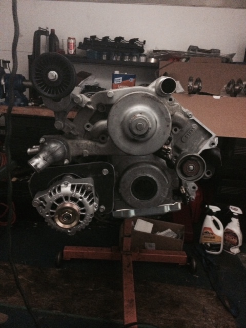

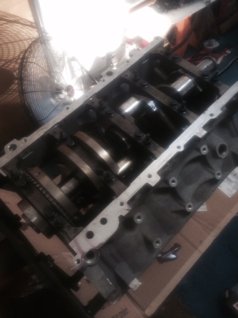

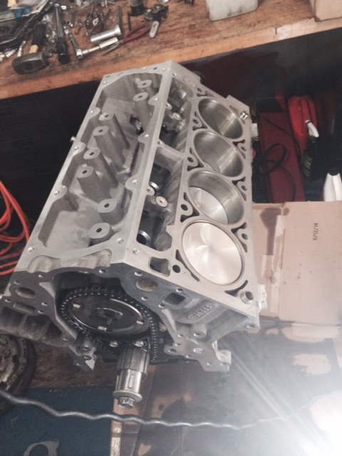

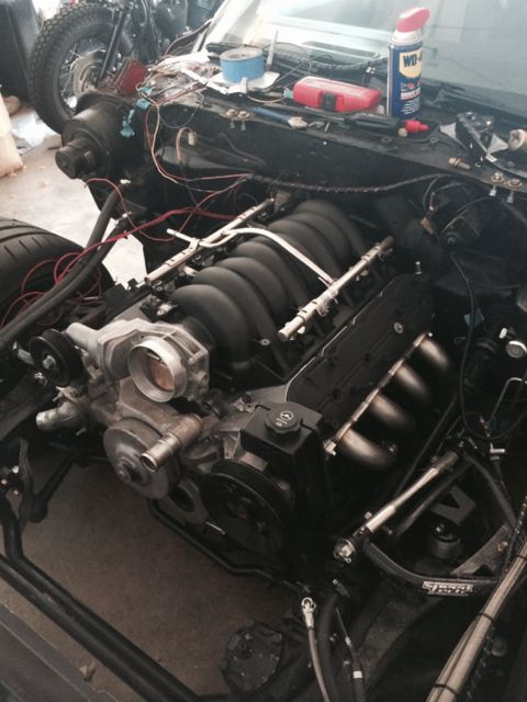

gerno 09-09-2014 06:52 PM
9 Attachment(s)
Finally think I have most of my parts for the new engine. Head arrived over the weekend and look very nice. I mocked the engine in place and am very happy with the placement of the engine and the header fitment. Everything is tucked up nicely. Even with 1/2 height body mounts I have ~1/2" between the collector and the floor pan. The pics aren't that good because it was loosely mocked up. Once I have it all together I'll take better pics.
I started filing the rings today for engine assembly, hopefully by the end of the week I'll have it complete.

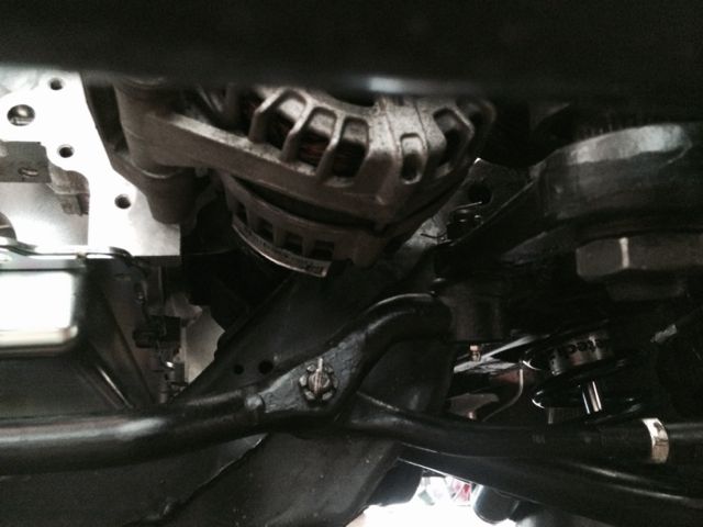

I think the only real fab work I need to do is to build the alternator mount. I have a plan using some 1/4 plate with some 5/8x.120 DOM. Hopefully it works. I also decided an accusump was necessary so I need to figure out where to mount that beast too.
Attachment 50105
Attachment 50106
Attachment 50107
Attachment 50108
Attachment 50109
Attachment 50110
Attachment 50112
Attachment 50113

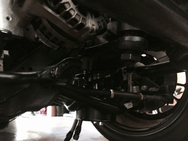

Spent most of tonight filing rings and working on the alternator mount. Here is a pic of the mount as it is. I used some 1/4 plate and have some 5/8x.120 DOM to use as a spacer for the bolts. Plan is the reinforce is back to the block near the motor mounts there is less flexing. I also want to retain the driver side idler pully using an aluminum spacer i will fab and add an idler pulley near the mount closest to the center of the engine. I think this will give me maximum wrap of all pulley. To clear the thermostat housing I am hoping a manual adjuster like this one (https://www.texas-speed.com/p-2838-a...r-wpulley.aspx) will move the pull to the center an down enough to clear. Luckily Texas Speed is now local so I'll try to pick one up tomorrow.
Attachment 50144
gerno 09-14-2014 07:51 PM
5 Attachment(s)
More progress made over the weekend. Short block is together with only a little time needed to finish the engine build.
Attachment 50211
Attachment 50212
Attachment 50213
I also think I made more progress with the accessory drive. I think I'm going to try to reroute the belt like the truck setup and build my own manual belt tensioner. I'm a little worried about the clearance needed since the area under the TB and rear the radiator hose will be tight. Does anyone know a tolerance that is reasonable for whip in the belt in and out of load using a manual tensioner?
Attachment 50214
Attachment 50215
GregWeld 09-14-2014 07:57 PM
Okay -- this might at first seem like a stupid question - but I'm going to ask it because I've seen this mistake made before... Not saying YOU made any mistakes - I'm just asking...
Did you match up the piston valve notches with the valve placement in the heads...
And did you offset the ring gap...
Torque with the proper lube??
gerno 09-14-2014 08:08 PM
All good questions and thanks for confirming
When I first hung the pistons I did not think about the valve reliefs and needed to rehang half of them.... it sucked... There is a left and a right in the kit you you do have to pay attention. I also have all the rods hung correctly with the large chamfer towards the crank.
I set all the ring gaps, took me over a day to do. I decided on the circle track spec which equated to basically .023 2nd and .022 first. I felt I'd rather have a little too much gap and not worry about heat expanding the rings and cracking the piston. It also sucked but the are right on for each hole.
I used ARP lube for all bolts except the rod bolts because Carrillo has a special lube they want to use for there specs
67goatman455 09-14-2014 08:15 PM
And this is why i'm paying someone else to build my engine haha. i would be second guessing myself for months about stuff like this.
gerno 09-14-2014 08:21 PM
I'm far from an expert but have build many engines in general over the years. I just take my time, double check all the measurements and continuously roll the engine over to make sure nothing is binding up. This is my first LS so I'm hoping it goes as well if not better than all the SBC's I built in the past... If I screw it up I pull it back out and learn what not to do again..:EmoteClueless:
carbuff 09-14-2014 08:39 PM
Originally Posted by gerno (Post 569866)
So, that belt is really close on both the top and the bottom of the radiator hose. Do you have enough clearance to move the PS pump up or down? It looks like if you help one you will hurt the other...
gerno 09-14-2014 08:45 PM
I was thinking to possible use an under drive PS pulley. First I need to see how the modern PS pump pressure compares to an old style pump when using a steering box. By using a larger diameter pulley the belt will hug the WP pulley more and clear the hose. If I also keep the tensioner lower the angle seems to create at least 1/4" clearance with the intake tube. I was also going to grind a small portion of it down for reassurance. It's all just mocked up by hand in the pic so it's hard to say. I have the same concern you mention.
