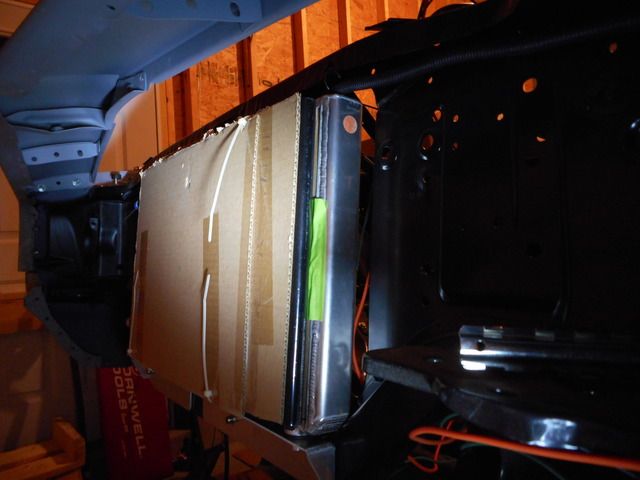

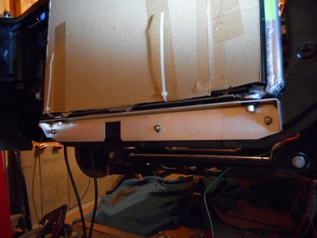

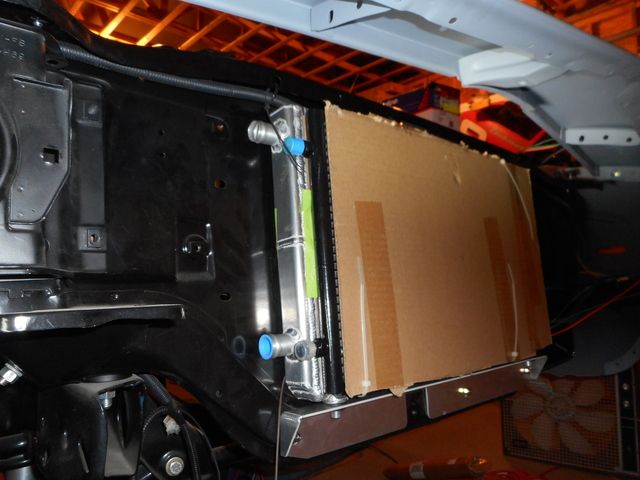

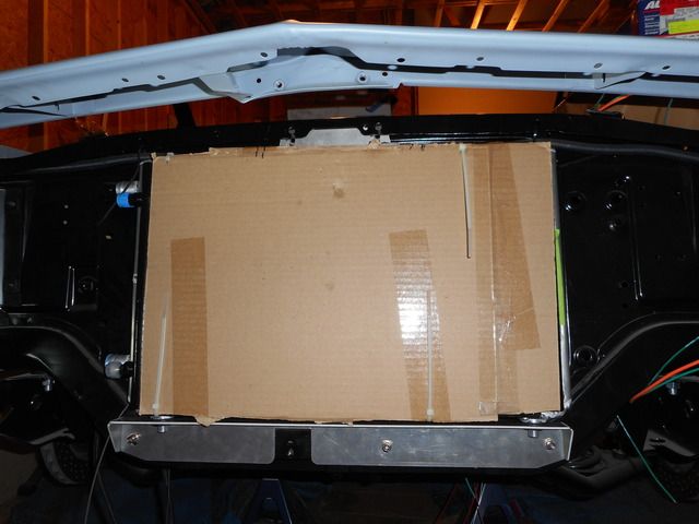

I always gave kudos to the builders of these amazing cars we see on here and after this week it got re enforced while trying to mount my hood latch with the Heat exchanger and A/C condenser.
I started fitting up my Heat Exchanger and condenser this week. I'm leaning mine back behind the latch mount on the radiator support by spacing the top bracket rearward to give a little extra room for the latch. I may need to make a taller aluminum bracket for the top of the HX. The top of the condenser has been notched already and the hood latch is being trimmed. I made a cardboard template of the bracket that mounts to the Rad support, hood latch, upper and lower valances to see how much I need to trim the bracket, and trimmed it to fit.
http://i172.photobucket.com/albums/w...pspzybm4ia.jpg
http://i172.photobucket.com/albums/w...pstzyyqaxy.jpg
http://i172.photobucket.com/albums/w...psetoljpur.jpg
http://i172.photobucket.com/albums/w...psv7zvwrl5.jpg
So after many curse words and dinged up finger I have to say, This is kicking my butt, I say uncle! I'm going to put a cable operated hood latch and be done with it.
I'm using a thread posted by 1967ls2 located here. http://www.pro-touring.com/threads/1...cable+operated one good thing, this forced me to finish my compressor hook up. Nothing fancy just a filter and regulator but now its usable. More to follow!
