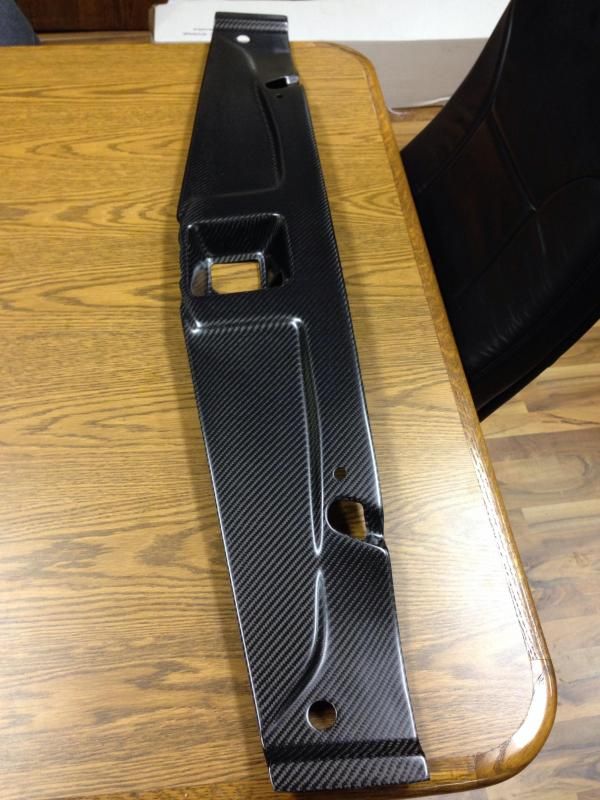

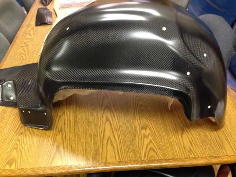

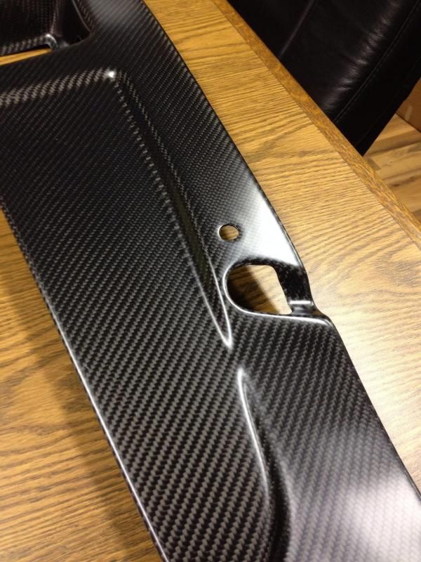

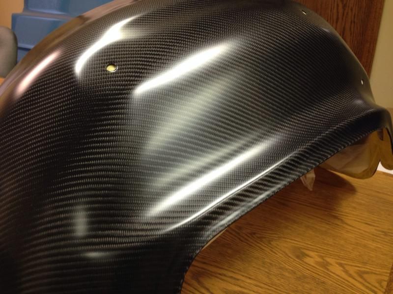

Flat cleared carbon parts.
A few pictures of the flat cleared carbon parts for the engine compartment we finished up.
The bottom of the hood is also flat cleared carbon.
Looking forward to seeing them on the car!
http://i119.photobucket.com/albums/o...ps805c2eb6.jpg
http://i119.photobucket.com/albums/o...psa440a5bb.jpg
http://i119.photobucket.com/albums/o...psa29ab9c5.jpg
http://i119.photobucket.com/albums/o...ps69d398f3.jpg

That satin clear carbon is pure awesome. It is going to look killer as the backdrop for Marks pseudo-OEM appearance underhood
