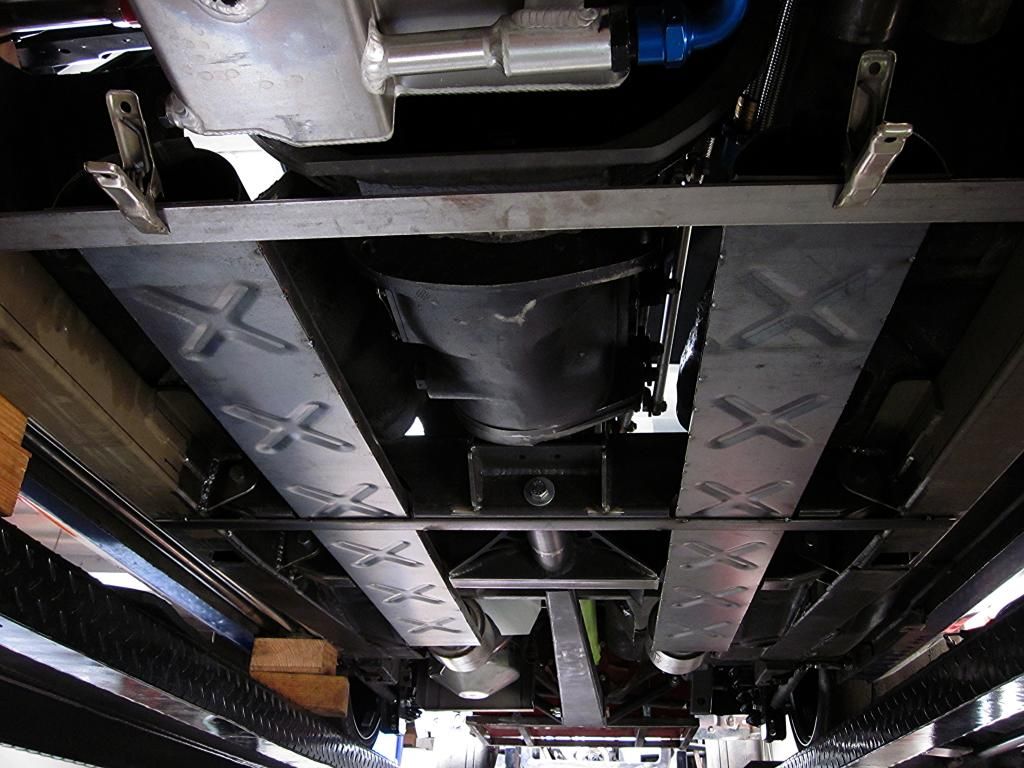

Vince@Meanstreets 04-23-2014 10:57 PM
Awesome stuff Brett.
How did you do the X pattern in the base plate so uniform? Im assuming its 16g and I've met you and can confirm you are not a robot.

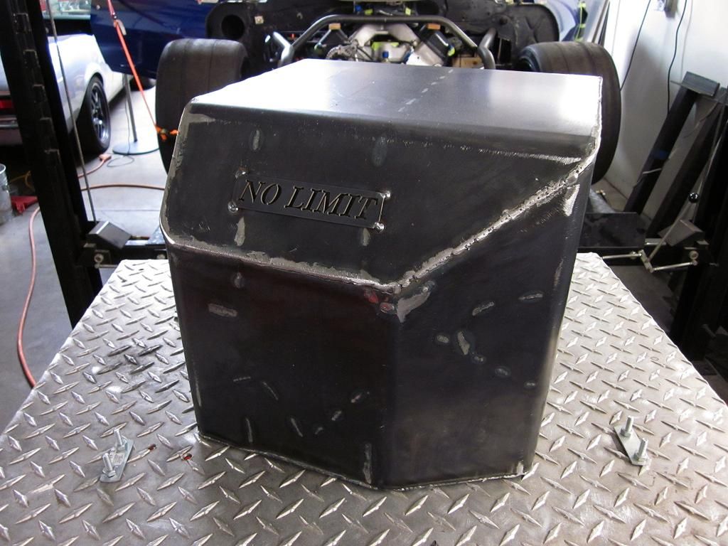

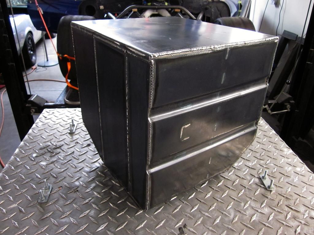

Custom muffler by Rob @ No Limit Engineering. Don't think it will be Laguna quiet (what the he!! is?) but thinking it should be fine everywhere else.
http://i236.photobucket.com/albums/f...psf88f6d18.jpg
http://i236.photobucket.com/albums/f...ps20addb87.jpg

Is there any issue with exhaust flow in using a pipe like this or a full rectangle vs oval or round? I like the idea, especially after trying to run my exhaust this week. It's almost impossible to get that stuff tucked up.
As far as shape with the transition from collectors (round) into a sort of "D" section, all I can find on the subject, technically, says to have the "D" section at least larger than the round section, in an ideal world of course.
My math shows this:
3.5" round = an area of 9.62 sq inches
2.25" x 5" "D" = approx 9.06 sq inches (it's not a perfect semi-circle D shape as you can see in the pics)
So, essentially, it's close enough by my estimation. :)
If anyone sees my math wrong, please share your thoughts.

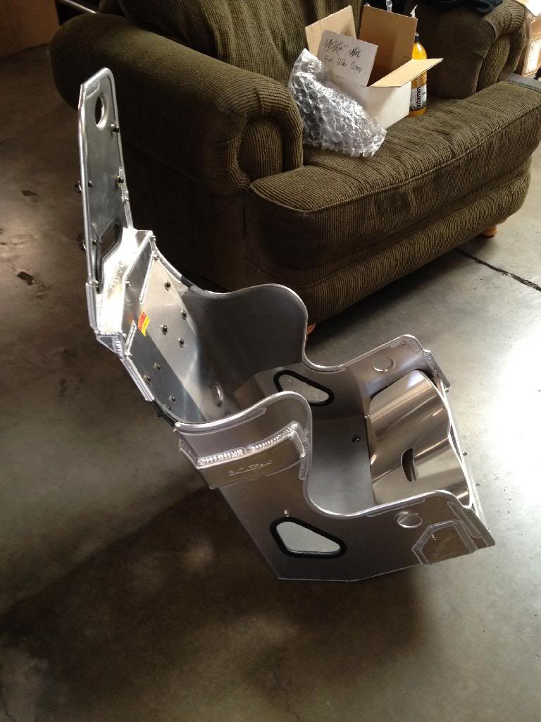

Got to sit in my new Butler seat. She's nice and snug and fits me well. Because I have been on the Payton bench press and lat pulldown program since I left North Carolina, we need to stretch out the rib tabs a bit. Otherwise it's all right where it needs to be.
We threw the head and shoulder pieces on as well while we were fitting the pedals and column, and they were much less intrusive with respect to the cage bars than we were anticipating. So that was good.

57hemicuda 05-02-2014 03:05 AM
I like the over stuffed green one in the picture way better. Looks like you could drive all day in that one.

GregWeld 05-02-2014 05:05 AM
Last one of those I saw was in....................... a race car.
LOL
Man that thing is awesome! It'll be perfect in traffic on the Bay Bridge!
Vegas69 05-02-2014 07:35 AM
It will be perfect for reaching back to put the pacifier back in the babies mouth.
Track Junky 05-02-2014 07:38 AM
Thats the most comfortable looking street car seat I have eve seen. Are you going with electric adjustable tilt and front to back :mock:
Car looks wicked Dave!! :thumbsup:
