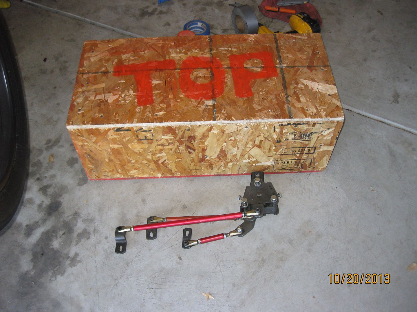

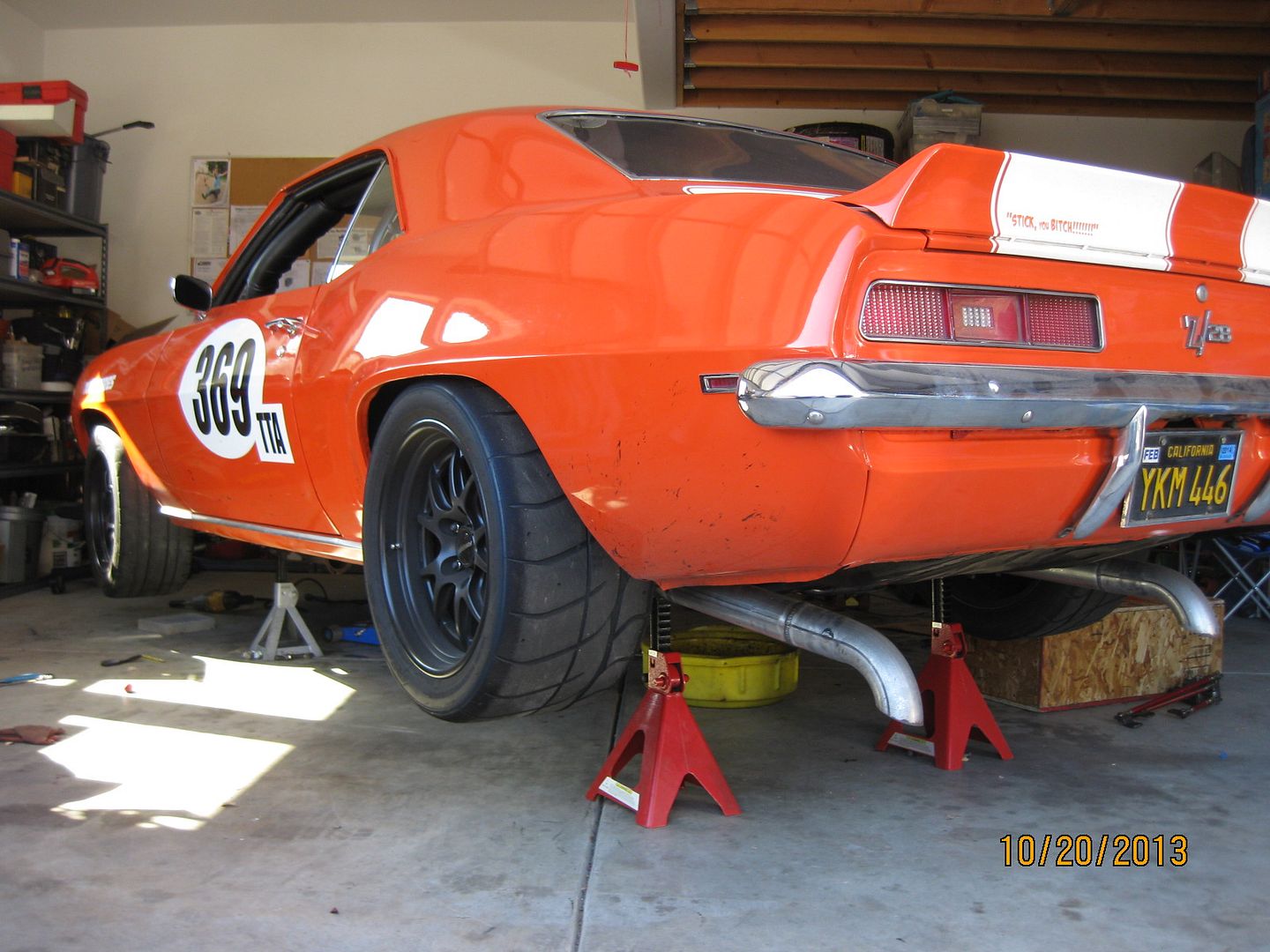

As far as the car goes, after my last event at T-Hill I noticed a vibration in the drive line my last two laps of the 5th session. Turns out it was the trans. The car has been up on jack stands for the past month and I finally got time this morning to box the trans up for shipping. Going to take some time off on Tuesday to shipp'er out for refreshing.
http://i851.photobucket.com/albums/a...ans2013299.jpg
http://i851.photobucket.com/albums/a...ans2013300.jpg

Who built that crate for you???
I woke up early this morning, busted out the skill saw and tape measure, then chopped and cut some 1x1 and 1/2" plywood I had laying around. Worked out perfect. Tranny fits like a glove.
Had to get it done before taking my boys to the go kart place.

I'm sure GW appreciates the less technical term plywood but I'd call it OSB.:lmao:
