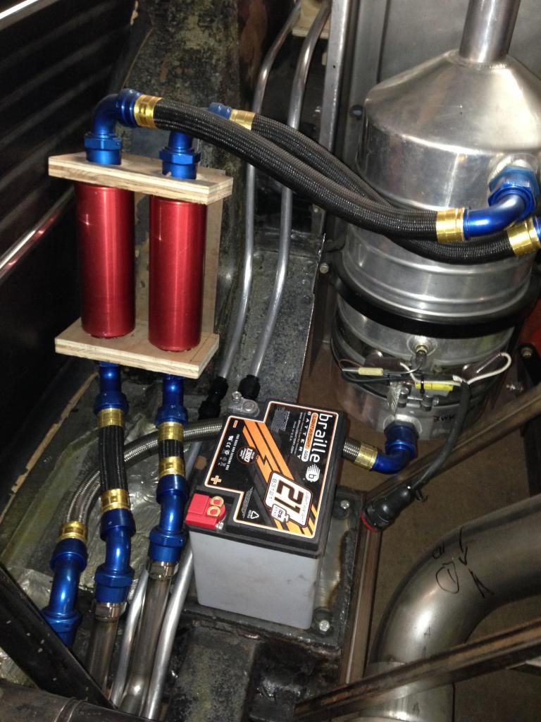

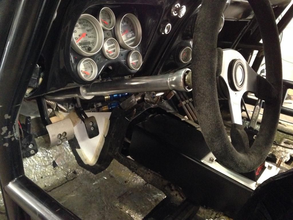

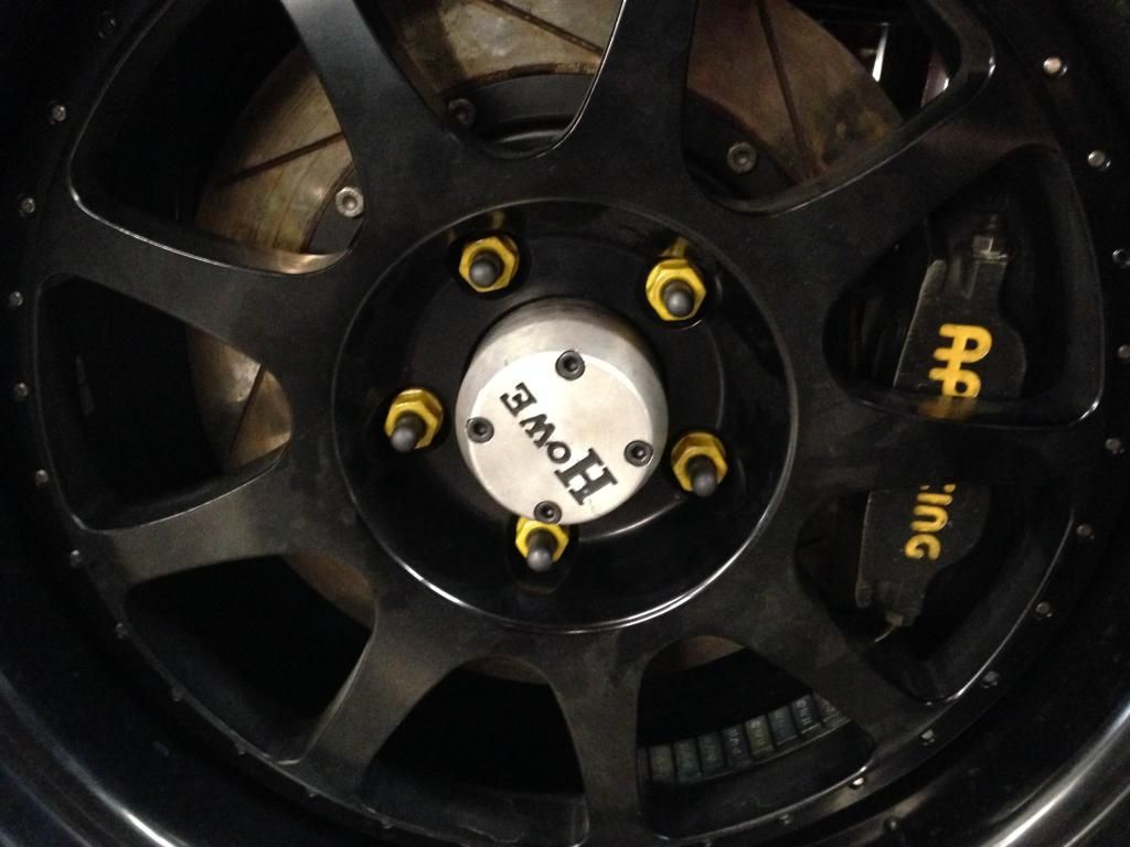

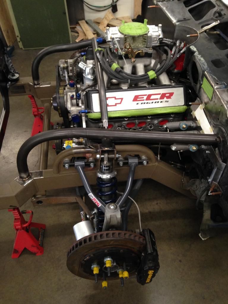

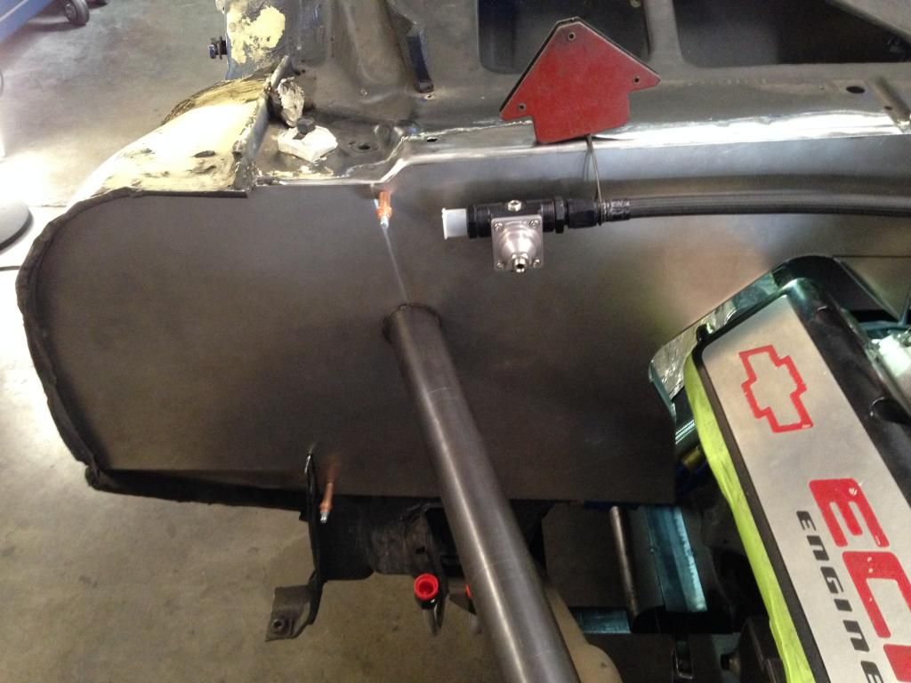

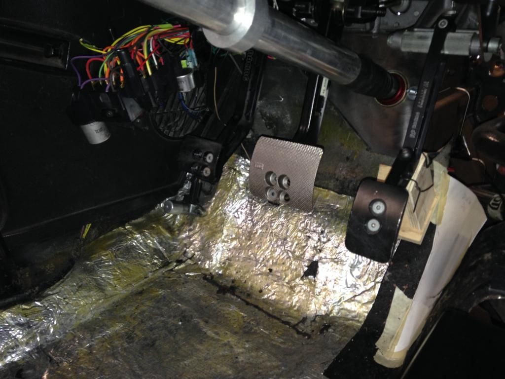

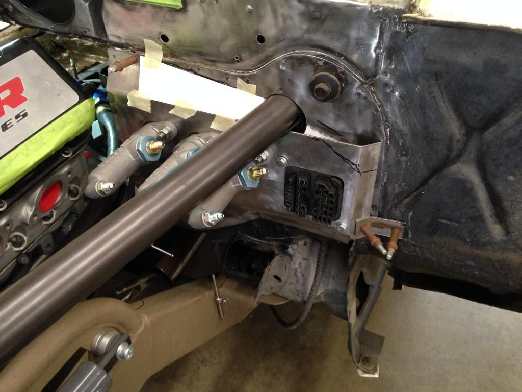

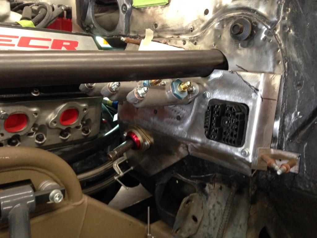

Ron Sutton 07-15-2014 09:15 AM
Cool Updates.
I have questions & comments ...
1. Nice big fire bottle. Smart move.
2. What size & thread are your wheel studs?
3. Are the lugs nuts & wheels a 45° or 60° conical seat?
4. Steering column looks to be collapsible ... Correct? What brand ?
5. Love the Braille Battery. Don't see them much here, but we used their super lightweight carbon fiber version in road racing.
6. Nice cage work & brace in the Engine Bay.
:cheers:
Flash68 07-16-2014 12:58 AM
Originally Posted by Track Junky (Post 560465)
Just let me know when I'm scheduled to be fitted for that custom booster seat that I'm going to need to reach the pedals :lol:
Really cool to see some update pics Dave. Keep Truckin' Budddy :thumbsup:
You should see what I just added to our baby shower registry. :whistling:
Originally Posted by Ron Sutton (Post 560564)
Cool Updates.
:cheers:
Thanks Ron.
Studs & lugs are by MSI (same place Rob got his) and are 1/2-20, 19mm
60* lugs
Column is Woodward collapsible
Don't know why the Braille isn't used more often either. Their 21 lb is a nice bang for the buck.

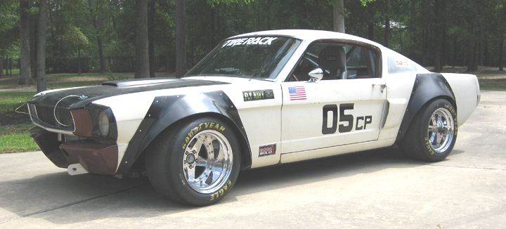

Flash68 07-16-2014 05:17 PM
So even though I had this rendering done and already put the kibosh on the idea, I thought I'd still share.
I loved how these boxed/squared flares looked on this Mustang.
http://i236.photobucket.com/albums/f...psf0004352.jpg
But then not so much on mine. :lol: Renderings do serve a purpose.

Chad-1stGen 07-16-2014 07:35 PM
[snip]
[snip]
I could see it working with rounded edges that flowed better with the body lines but still being black with a rivet look.
