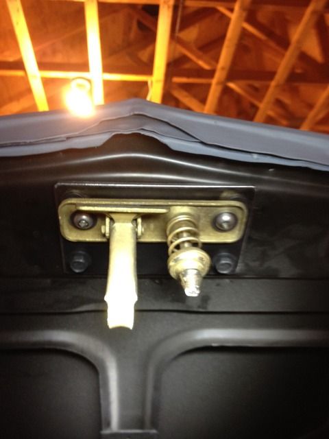

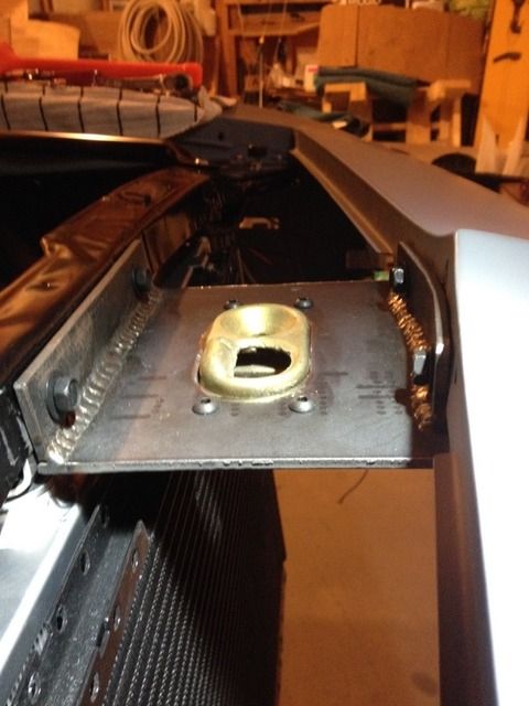

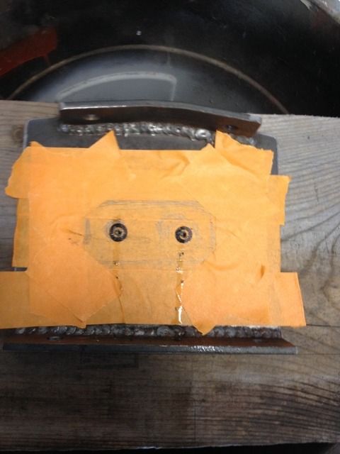

We got the top part of the latch in place and are lining the bottom up to find the final location. We'll set and mount it.
Here's the starting location.
http://i172.photobucket.com/albums/w...psiglnlioo.jpg
http://i172.photobucket.com/albums/w...psu9onqvtj.jpg
http://i172.photobucket.com/albums/w...psugokodw8.jpg
I tried to clearance the top holes on the radiator side to move the plate to the drivers side but it threw off the front piece that bolts to the header panel. Thank god for finish washers.

Wayne, weld a flat piece of 1/2 inch wide 1/8 inch strap to the bottom for your hood support. Cut the horizontal tab off the center support and drill a hole throught the top of the support then through the tab welded to the bottom of your lower hood bracket you built. Looking good. Progress,, that 's all we need is a little progress..

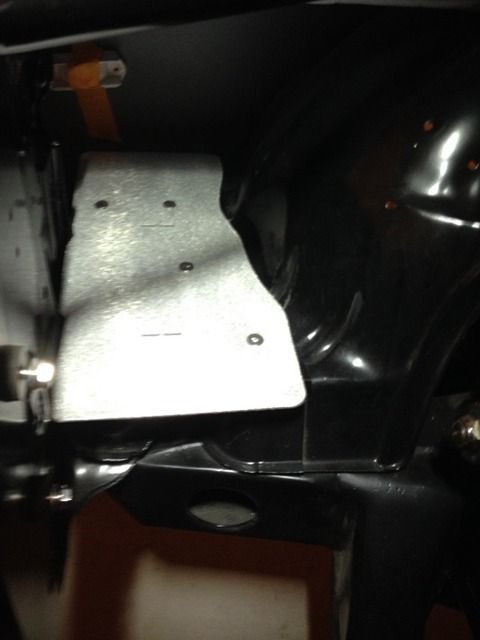

We've been working on the car a few hours a day we installed the RS doors to figure if it would interfere with the intercooler reservoir. I'm going to put it right behind the passenger headlight in the same place Travis (Snappytravis) put his. I had been thinking about putting it there and seeing how nice his is, it was definitely a go.
We made a platform to mount the tank out of aluminum and bolted it in.It will have a piece in the back for a tab to slide into and be bolted 2 or 3 places in the front and be covered with some type of rubber to prevent chafing the tank.
Here's a quick shot of the platform test fit.

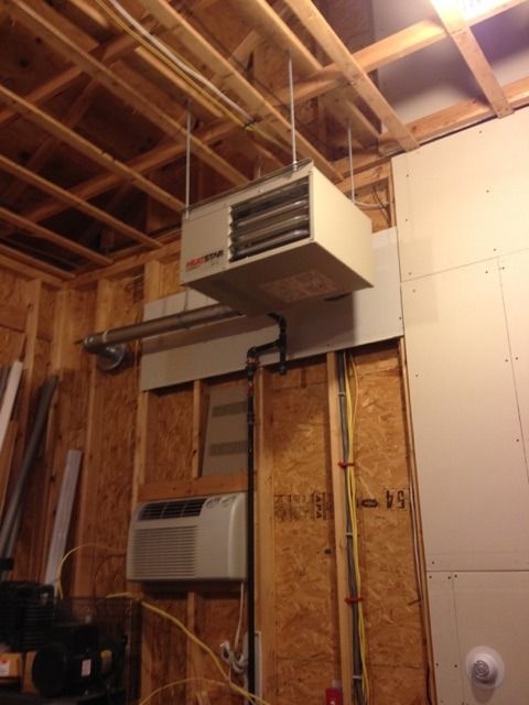

HEAT!
No more frost bite on the bootie!
http://i172.photobucket.com/albums/w...pscwu6mfly.jpg
http://i172.photobucket.com/albums/w...ps6frzouue.jpg
Of course its been in the 70's, the heater must have scared the cold away!

When we tried to fire the heat up I had just finished wiring the breaker in the box and tested the GFCI on it. We turned it on and nothing OH CRAP! the heater was in my cellar for 3 years I figured something went wrong, but luckily it was just flip the breaker.
