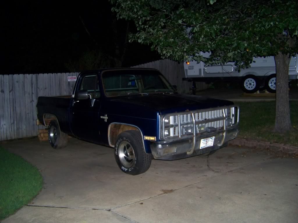

We started on the blue one and gave it a wash before brining it home for a full inspection. We decided to take it completly apart and redo everything. From a distance it did not look to bad.
http://i266.photobucket.com/albums/i...s/100_1724.jpg

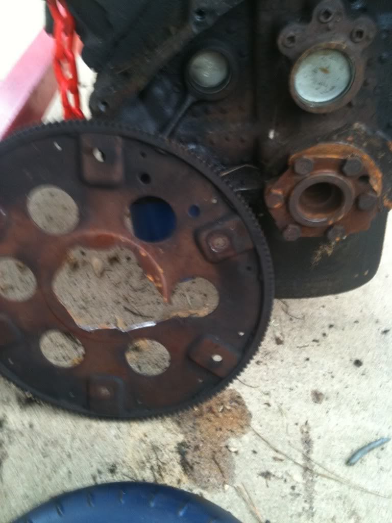

Did not run so we pulled the motor out to find out what was wrong. We found a broken flex plate, damaged harmonic balancer and a locked up bottom end. It was a 305 so off to the scrapper it went.

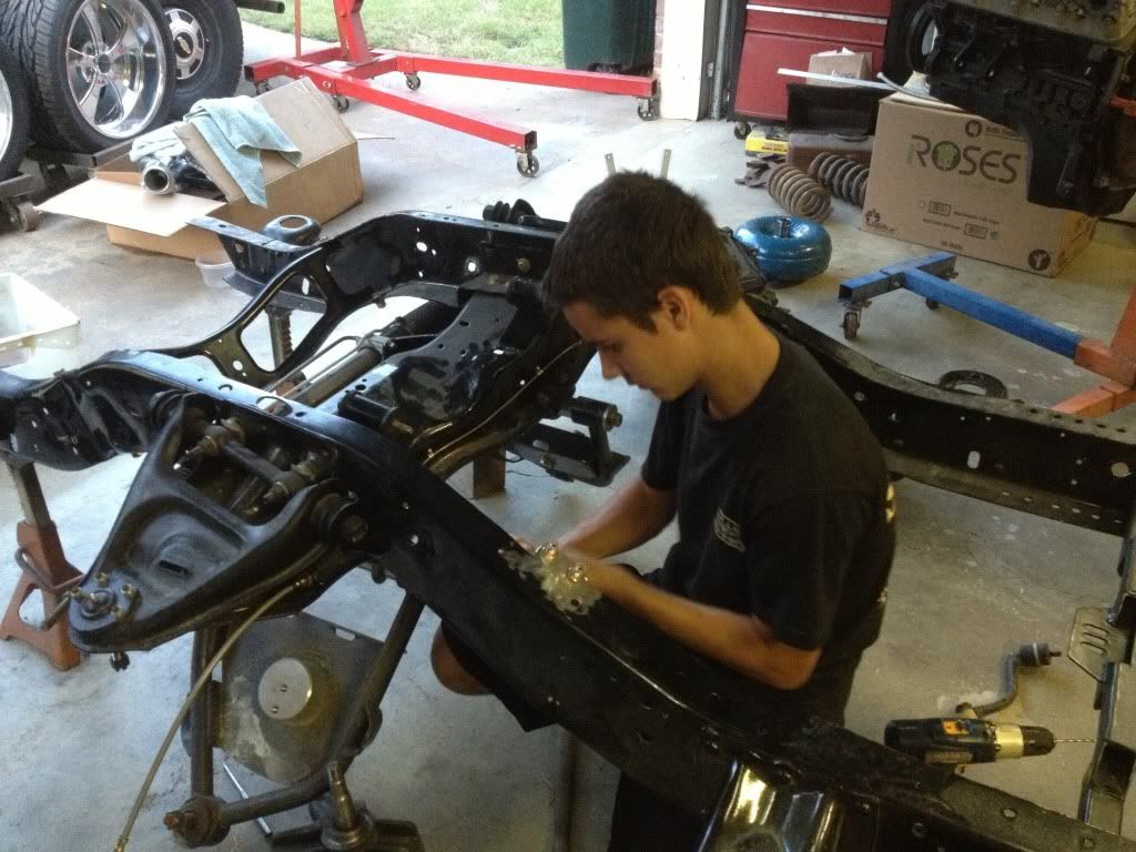

C5 rear brakes with in hat E-brake adapted to a 12 bolt rear end:
http://i266.photobucket.com/albums/i...psa0e9ab7c.jpg
Korbin is tapping a hole for the brake line clamps:
http://i266.photobucket.com/albums/i...psc0eb519e.jpg
