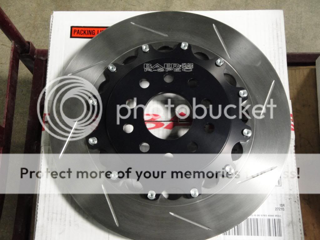

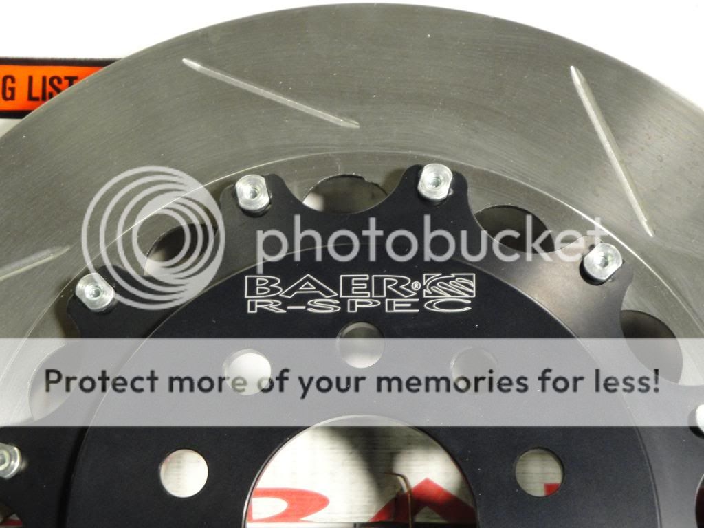

I just bought Baer's new R-spec floating rotor

Bryce 02-12-2014 05:17 AM
I like the floating radial mount

No! The rotor and mounting hat pictured are what is referred to as " radial mount " in that the rotor to hat mounting system allows for radial movement that will be caused by operating in high heat conditions. Because the mounting points are not captured but in a radial slot the mounts can actually move outboard to a bigger diameter when they expand due to being extremely heated. Conventional rotors and hats with fixed bolt circles can crack and fail at the mounting points due to the forces of extreme heating.
