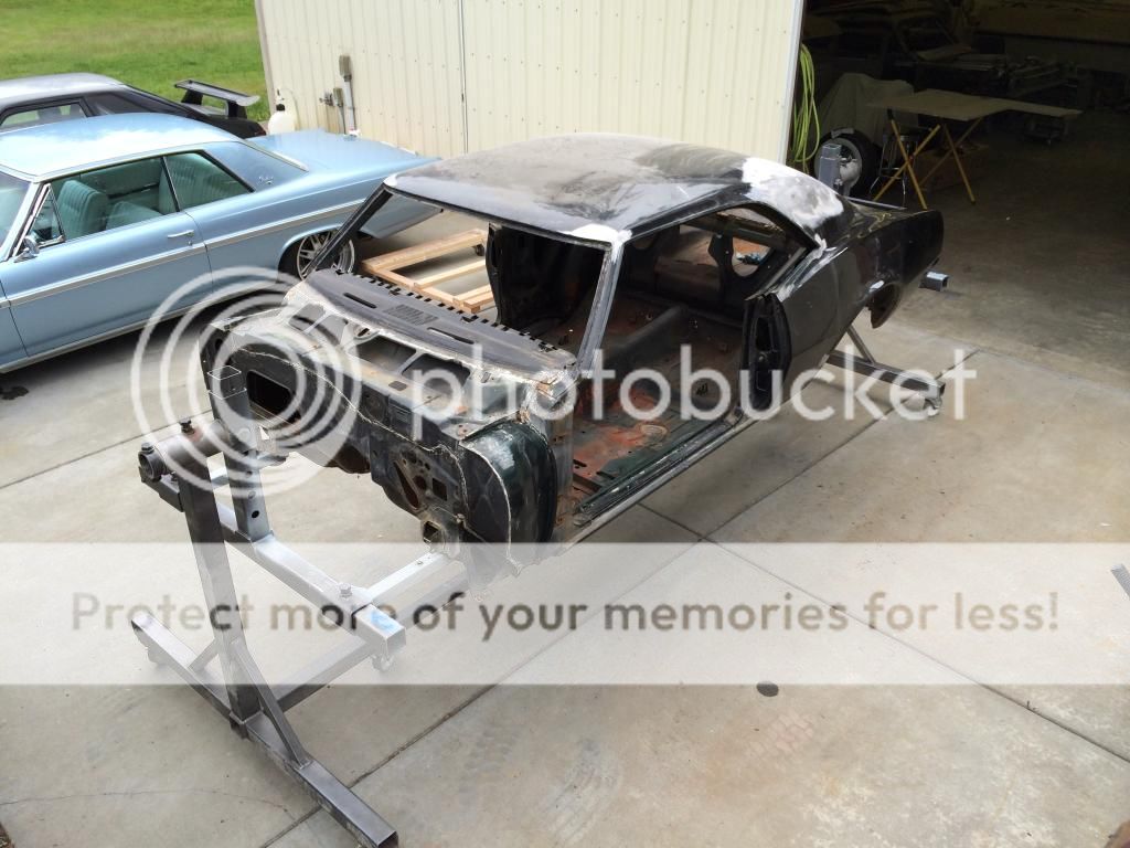

Heres where we started:
http://i461.photobucket.com/albums/q...B339C9BB40.jpg
http://i461.photobucket.com/albums/q...E3364E1C5B.jpg

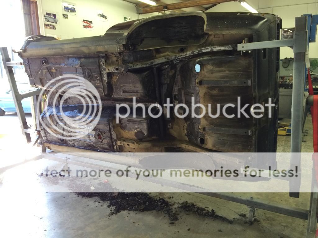

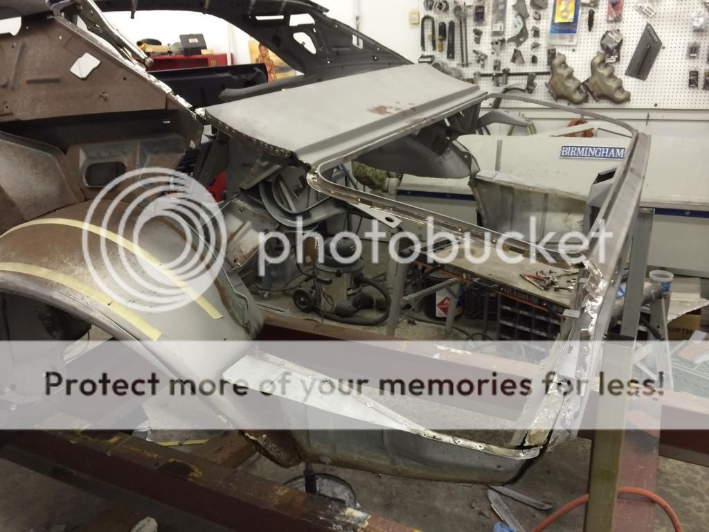

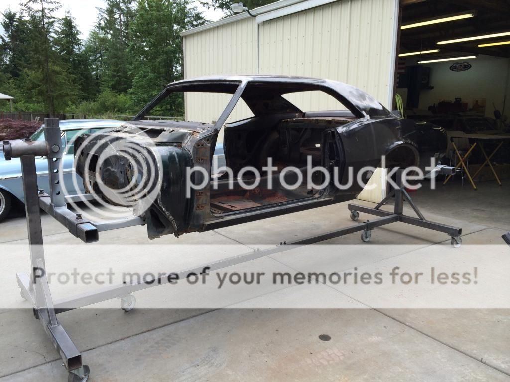

The body was very clean! The worst part of the car was the colony of mice that lived in it throughout the years... We found rust in very unusual places.
http://i461.photobucket.com/albums/q...E196FE32B0.jpg

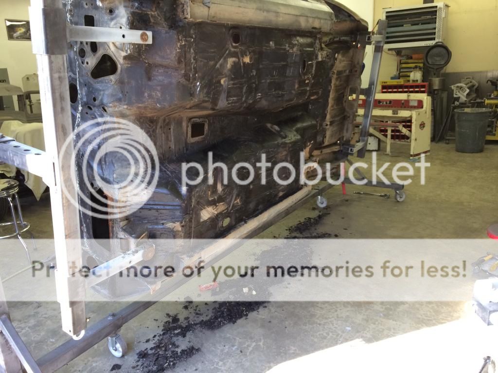

The glamorous part of building cars... Scraping undercoat for a day... Thank God for the rotisserie!

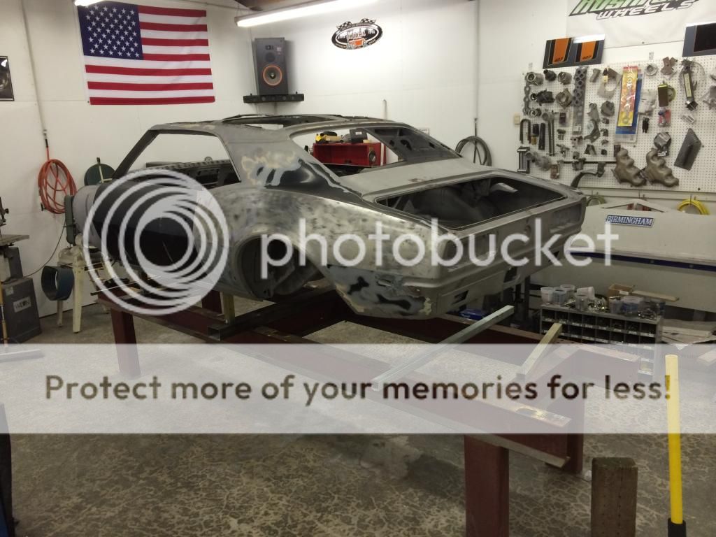

http://i461.photobucket.com/albums/q...A21C1A9FE9.jpg
We got the main areas of the car blasted, and mounted it to the frame table. I was pretty surprised to see that the body was twisted about 1/2"! An easy fix now, but could have been a nightmare!

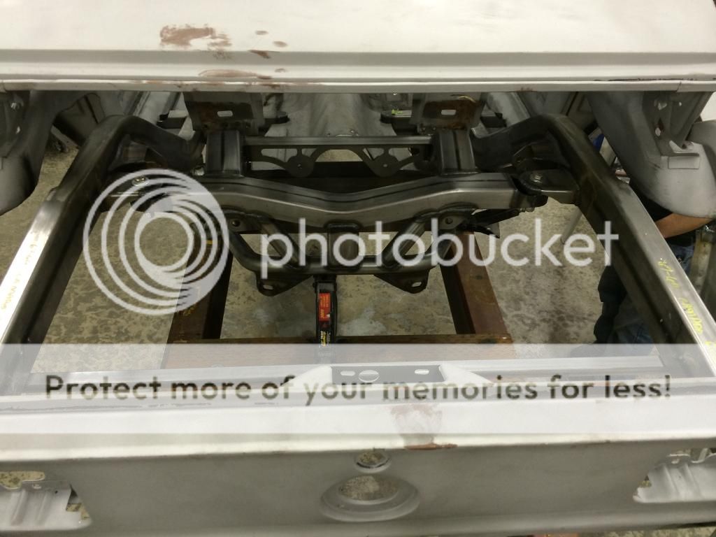

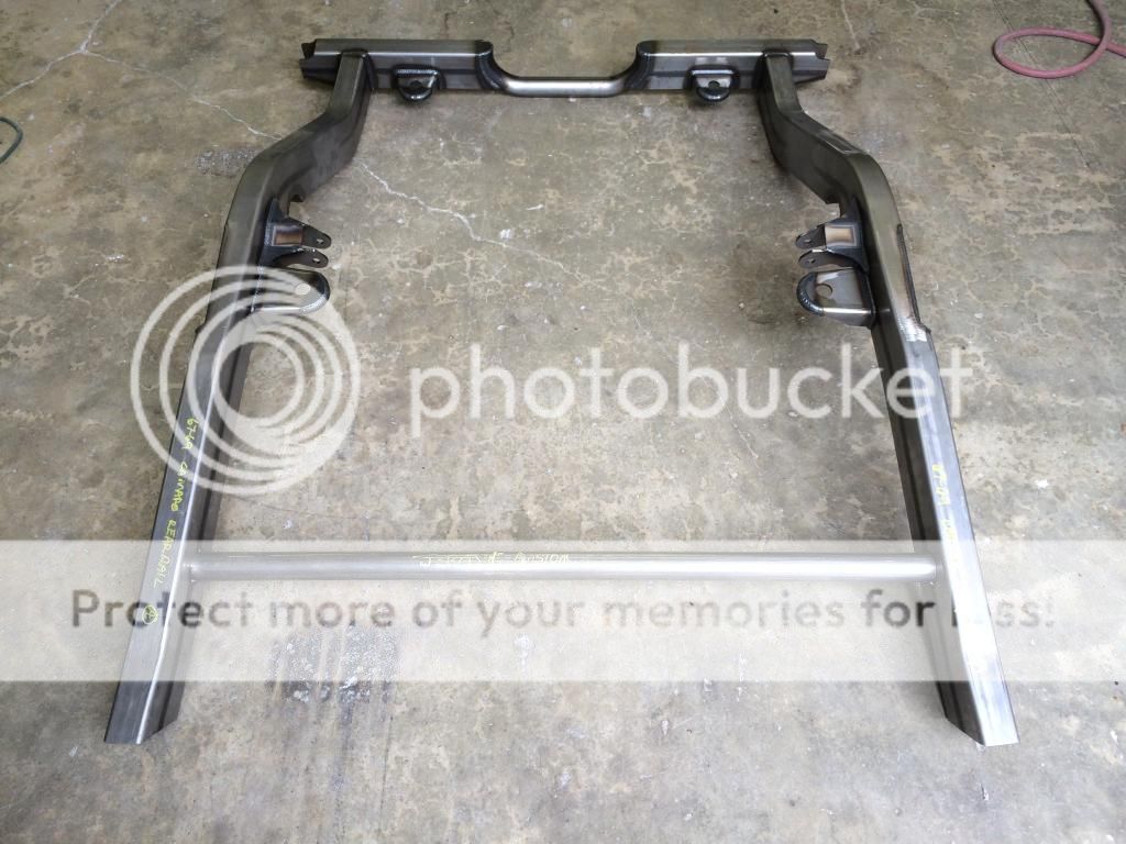

Heres the morrison Rail that welds into the car.http://i461.photobucket.com/albums/q...4DCBC7C2A5.jpg

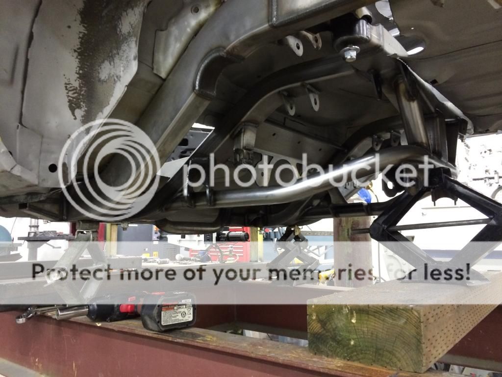

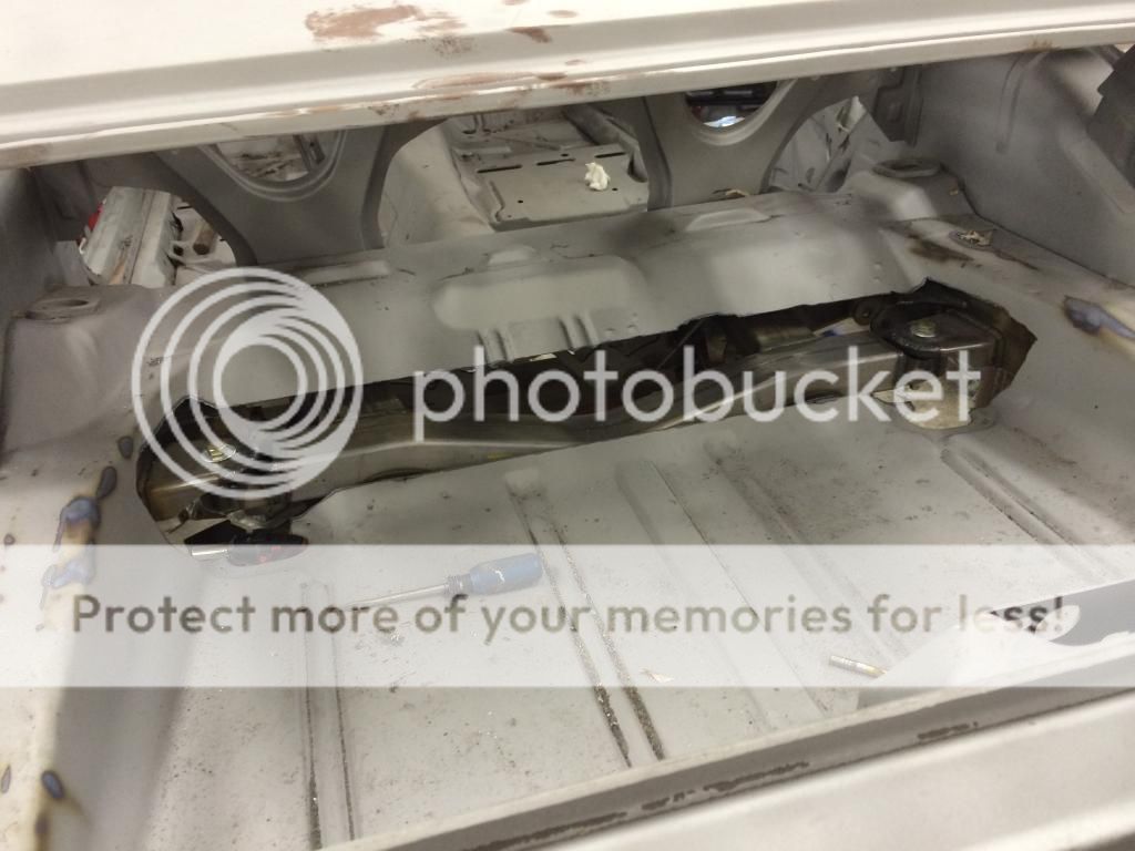

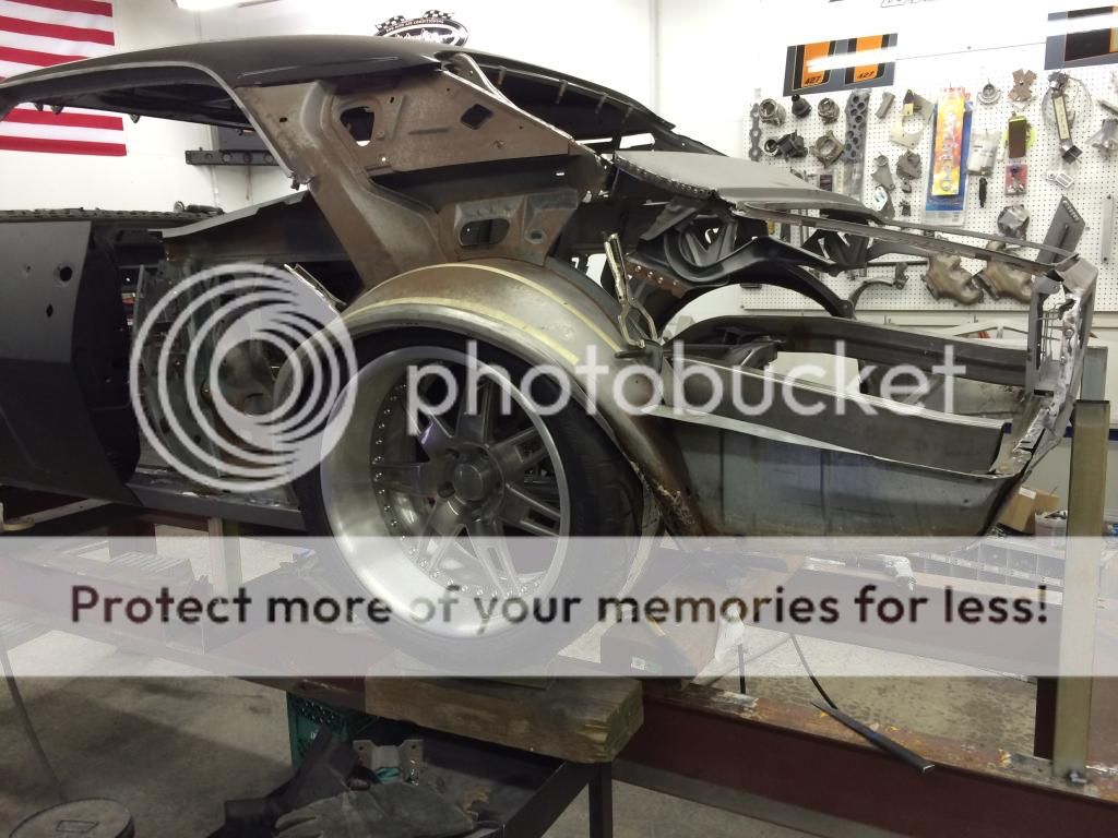

We started getting the rear rail mocked up where they want it to go... It really requires minimal cutting to get it installed. But... we are after a lower ride height... We decided to raise the rear floor and rear rail up 2". That would give a a 5 3/4" ride height.http://i461.photobucket.com/albums/q...D14F10AE4E.jpg
http://i461.photobucket.com/albums/q...44F17C59C6.jpg
http://i461.photobucket.com/albums/q...E04A4C97B2.jpg
The rail is in, at its final height.http://i461.photobucket.com/albums/q...C56FEE1CF5.jpg
http://i461.photobucket.com/albums/q...61E58E7412.jpg

It will be close, we may need to modify the outer wheel well. The factory outer well almost immediately starts curving in... making it hard to tuck any tire.
