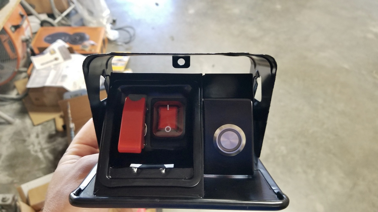

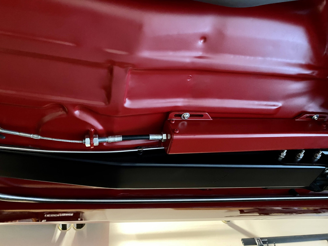

No real drawback except space availability on where to mount it. There are various solutions that have been completed. Here is mine:
https://i.postimg.cc/tgb8ffbS/0E072A...9628FCBD8C.jpg
https://i.postimg.cc/xTSPdDJk/IMG_6720.jpg
https://i.postimg.cc/Zqg8t1z5/IMG_6719.jpg

CJ, I went through all 41 pages of your build, I must have missed it but, I need more info on those subframe brackets. How you did the bolt through and such.
cjfirstgen 02-25-2021 06:26 AM
I thought the larger bracket (2 to 1)came with the kit. The smaller bracket we made. The Estopp unit we used rivnuts and spot welded on the inside when we had the seat pan removed for the subframe connectors as I recall. Hope that answers your questions.
