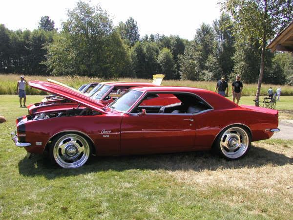

Sandro's 1969 502 Camaro 05-22-2005 11:44 PM
2 Attachment(s)
With the 68 camaro the biggest tire Lui could go with was 225/30R20 the rim is 20x8 5" back space. In the rear he went with 285/30R20 20x9.5 5 3/4" b/s. With the rear he had some problems with rubbing but the front no problems what so ever. If you notice in the pictures his car is is low as you can possibly go and the front works just fine, unless you hit a pot hole or some thing, then your going to have some problems.
Sandro's 1969 502 Camaro 05-22-2005 11:48 PM
1 Attachment(s)
you can't really make out the front tire profile on lui's car so here's a better picture with Lui's front wheel on my car there's not much tire....

You can run the 20's it's just the with of the rim you have to play with. On my 69 I ran a 20x 8.5 in the rear and squeezed on a 285/30 20 tire and it workled fine with lots of room. But if you put that same tire on a 20x9.5" rim then your going to have some problems especially on a 68, when your running the car that low. Even if you decided to run a 275/40 18 in the rear its basically the same hieght and width as the 285/30 20. It all depends on how low you want your ride hieght and how wide of a rim your going to run. Wile the 20's might look cool to some people the 18's are definatly better preformance wise.
