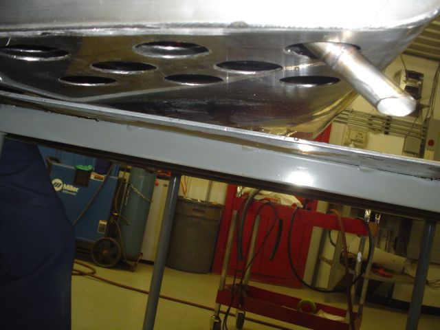

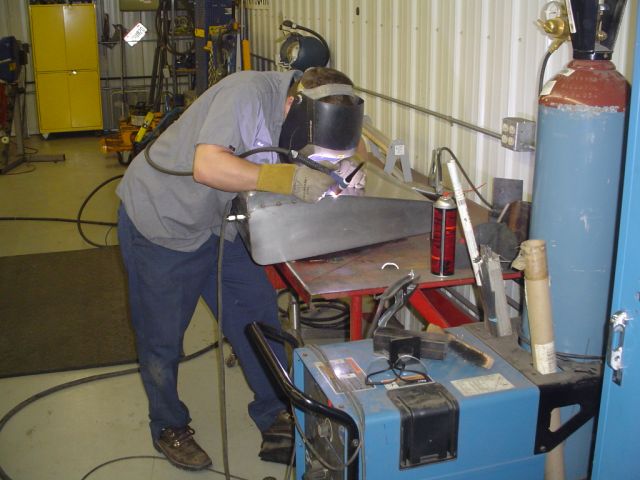

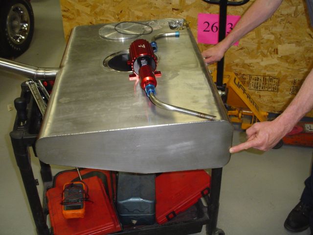

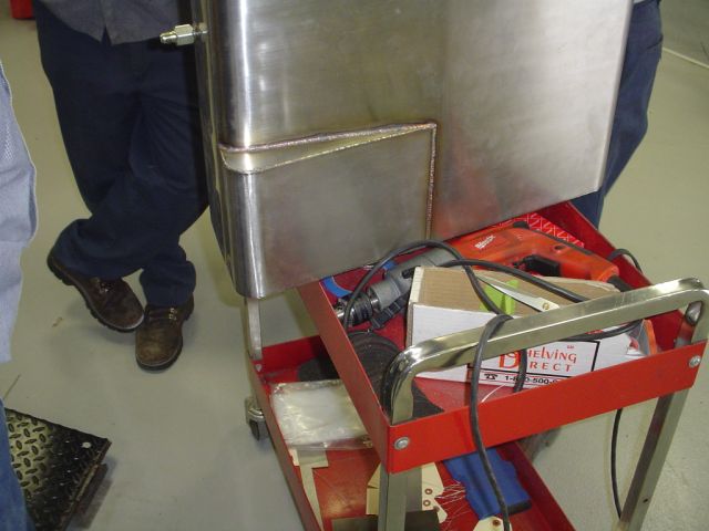

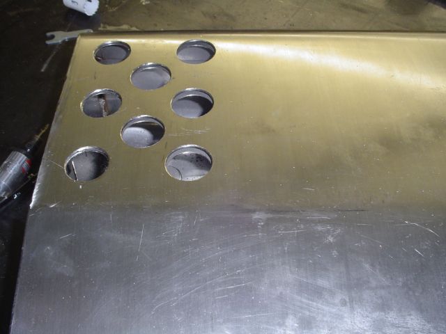

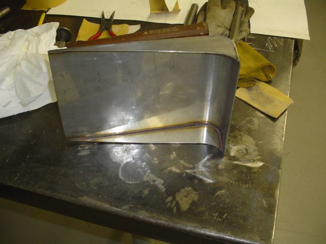

Looks like we're finally good to go. We ran the engine yesterday morning inside the shop and everything seemed fine. Then, during the test drive, we noticed sudden/periodic loss of fuel pressure during cornering or accelerating maneuvers. Upon further inspection we discovered a leaky weld in the polished stainless steel tank, but nothing outwardly causing the fluxuation in fuel pressure. We need to maintain constant 60# fuel pressure, but without warning the pressure would sometimes drop to 35# then slowly [about a 10-count] rebuild pressure to 60#. After much debate [and even some arguing], we decided to remove and inspect the in-tank A-1000 fuel pump check valve. After opening the fuel tank inspection plate to remove the pump, we noticed the suck end of the fuel pickup tube had snuggled tightly against the bottom corner of the tank that appeared to inhibit unfettered fuel sump. The pump and check valve checked out fine, so we cut the fuel tank open and welded in a containment sump and rerouted the pickup tube accordingly. Just an hour ago we test ran the motor, then took it outside and rodeo'd the crap out of the Velle from idle to WOT and it held 60# pressure throughout all phases of operation...whew. It's now on it's way to Colin's Pre-HRPT party/BBQ in Milwaukee to be handed off to Jody and Scott for the long haul tour. I have a few pictures that better portray the above fuel tank problem and fix, so I'll email them to Scott to post this afternoon [I hope he's still around his PC at home]. I hate the 5-6 days before Power Tour when a new build car is coming out for the first time! :willy:

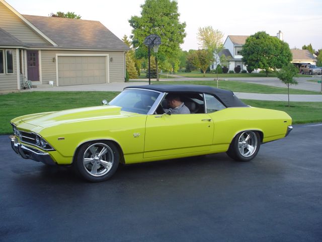

XcYZ 06-03-2005 07:04 PM
Here's the pics. Can you say stance? :thumbsup:

RussMS 06-03-2005 07:49 PM
Wow that is one sweet car! :thumbsup:
LVCamaro 06-03-2005 07:53 PM
Thanks to Andrew White at Aloha Automotive for beating the odds to have this car ready for HRPT. :hail: Are these guys good, or what! :thumbsup:
