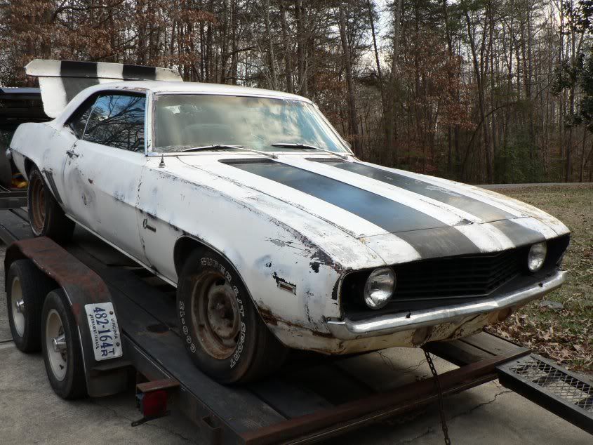

I know this takes a lot of the fun out of it, but I have my own fish to fry: My 1969 Camaro:
http://i198.photobucket.com/albums/a...1010684_sm.jpg
Question for the crowd: How hard will adapting the 2004-2007 GTO IRS be, and how well will it work? Between DDY RCKT and myself, we'll figure out the mounting. My Camaro is nothing special, just a base Camaro with V8, deluxe interior, and 12-bolt. The GTO and Camaro are be similar weights; the Camaro will eventually get LS2/4L60E power too.
The first piece of information is that my quicky measurement on widths is that the 12-bolt that's in my Camaro is about 58" wide flange to flange, and that's similar to the width of the IRS from the GTO.
