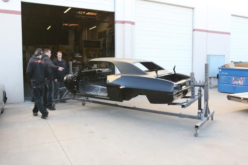

fesler 03-08-2008 11:15 AM
5 Attachment(s)
Here is the engine and all suspension ready to go in now, all suspension is powder coated 50% black to just disapear and not take from the gloss paint
this is a mild build so we are staying with the stock sub-frame and using Air Ride Technologies upper/lower control arms with Shock waves,
The GM performance 572 engine is painted and ready to drop in
For the rear we went with a Currie 9-inch to handle that 572 power
