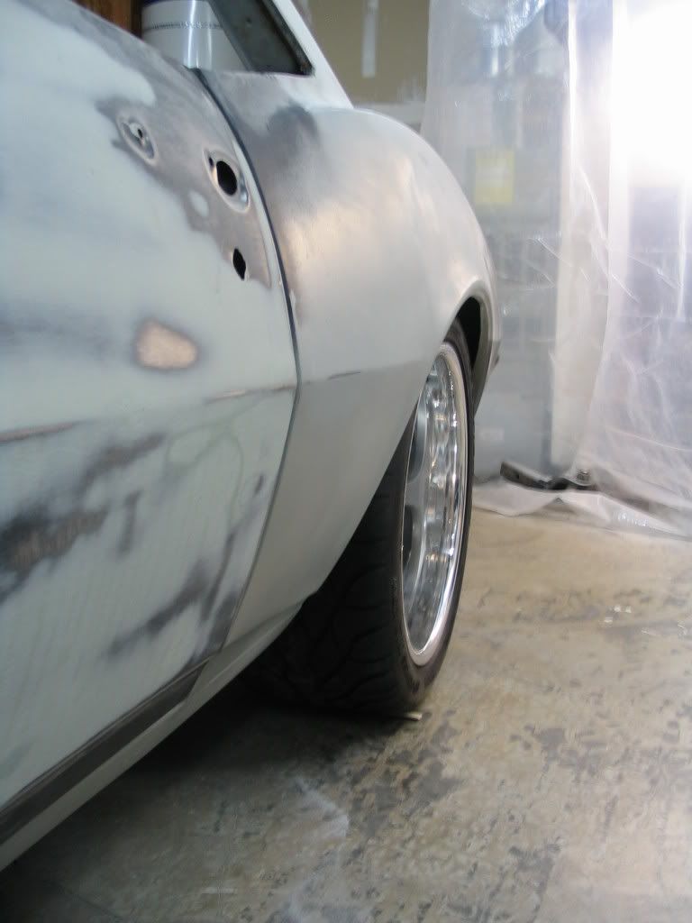

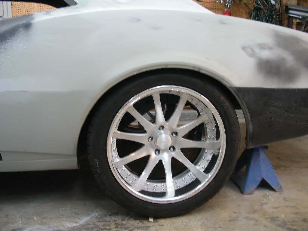

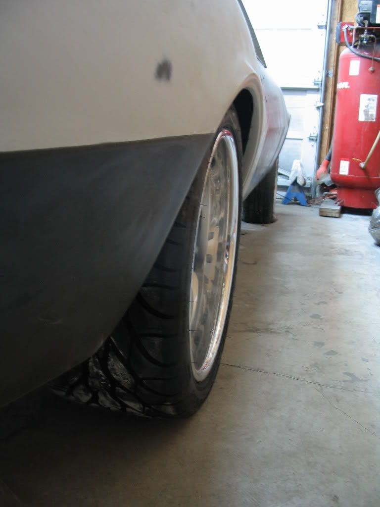

hey guys I am sending the rear-end out to get narrowed and need your opinion on wheel placement. 67-8 camaro rear quarters are hard to get clearance. here's what I came up with- does it look ok or are the wheels under too far?
http://i250.photobucket.com/albums/g...d/e9b6149b.jpg
http://i250.photobucket.com/albums/g...d/f4688795.jpg
http://i250.photobucket.com/albums/g...d/d302bf10.jpg
i came up with 54.5 inches on the width with 19x10 inch rims with 4.25 backspacing- yes the car is mini-tubbed- just couldn't justify the extra cash for wider rims- my 295's almost have a 12 inches of footprint- thanks for your input- Chris:lateral:
Vegas69 01-31-2008 10:37 PM
Looks way off to me. I am thinking .75-1 inch spacer or different rear end. Basically your rear is off by 1.5-2 inches.
