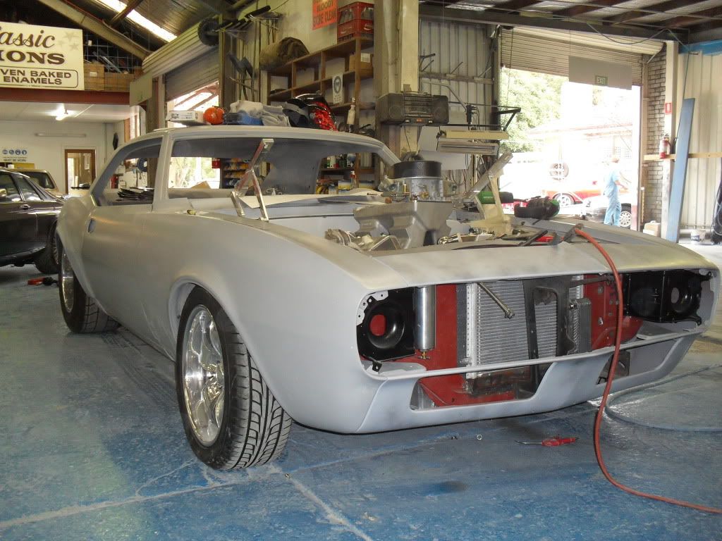

Am in Australia so lots of stuff to get over from the states and has been slow progress (have had the car over 1 year already)
Put in the AME front clip 2 weeks ago, looks amazing and everyone who has seen it agrees the thing is a work of Art....

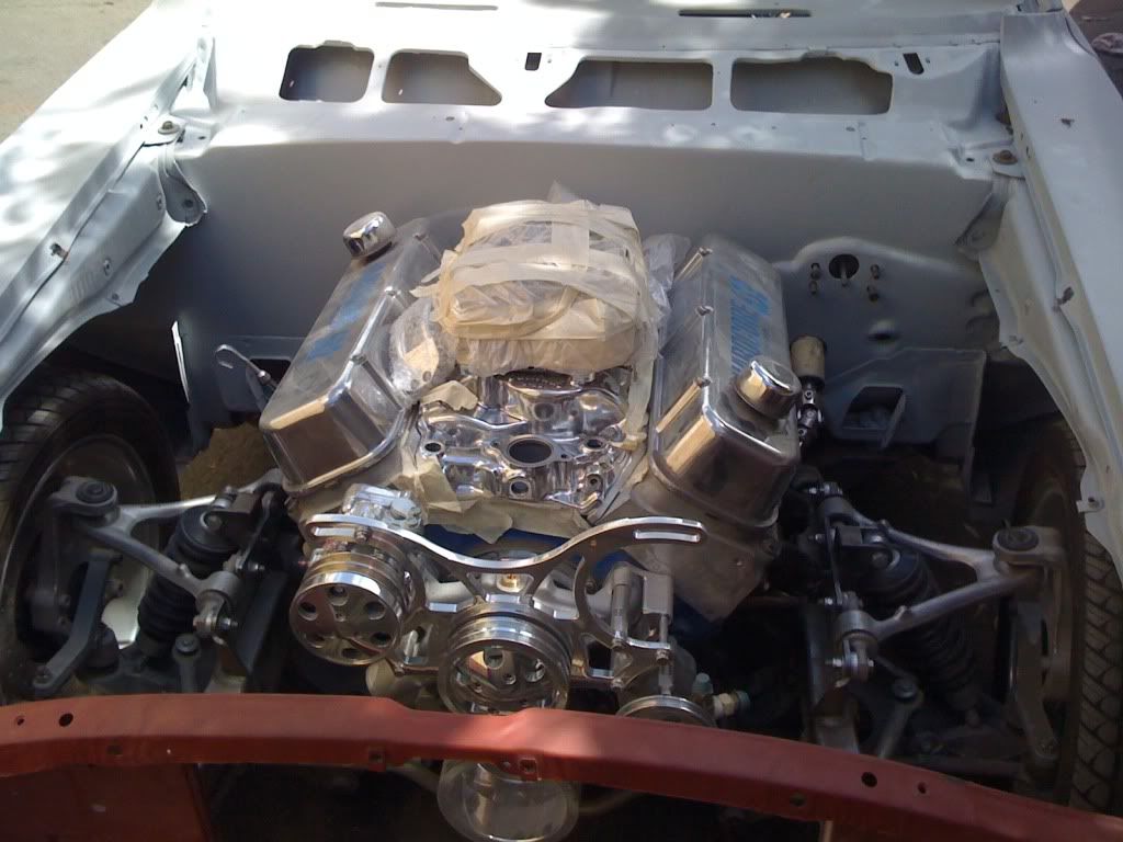

Mocked up the engine and trans to get ride heights this week.
632 BBC looks awesome in the front and only have 2 issues (oil pan sits on power rack and dizzy hits firewall), both easily overcome without too much effort (smoothing the firewall anyway and will notch the pan or replace the pan if I can find one).
Car is running 17" rims and 330mm discs all round.
325 x 50 on rear and 245 x 45 front. Front wheel is a bit of an issue as it is damn close to fender edge...so will need to work there.
All in all very pleased with look though, will run 4 inch ground clearance all round without airbags.

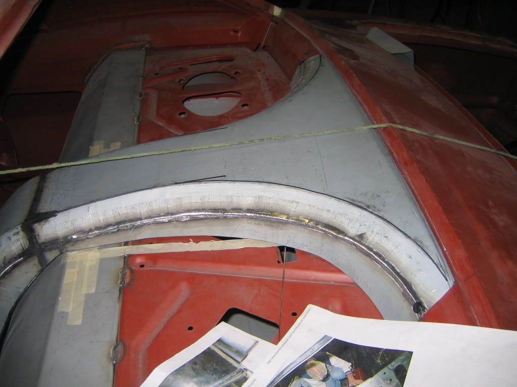

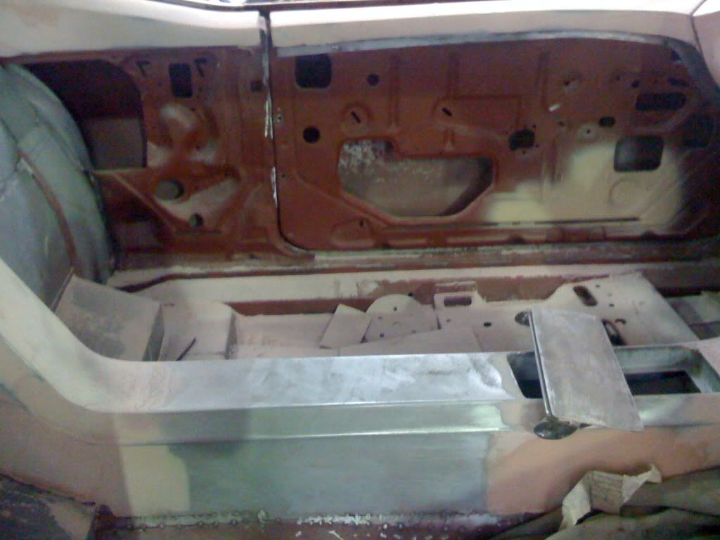

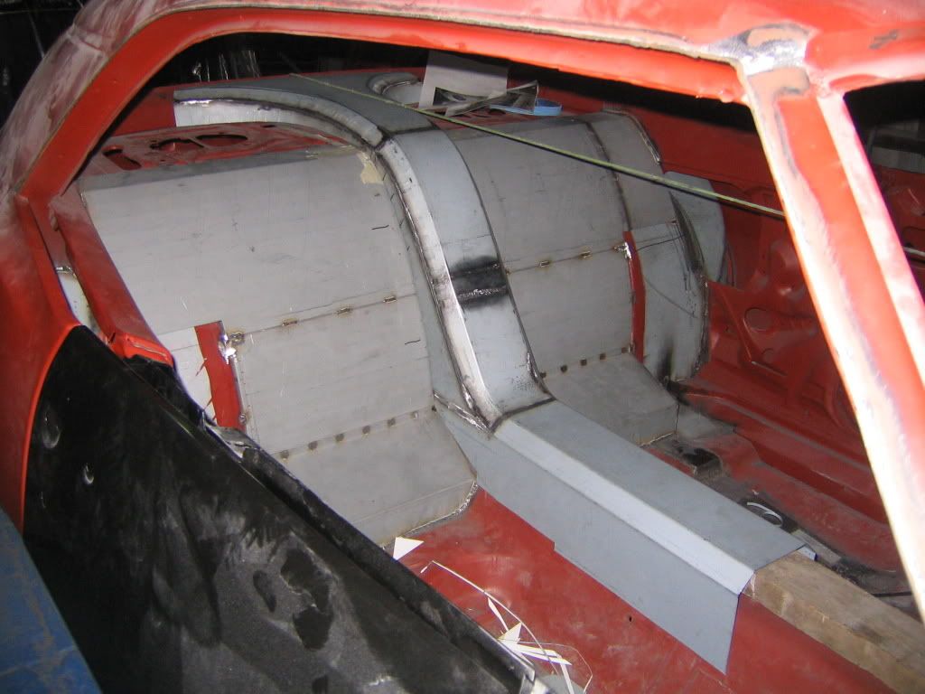

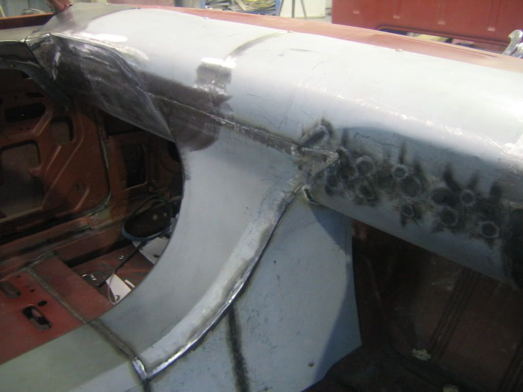

May 08 update....
Rear tubs in and trunk sheet metal in, and starting to sculpture the full length centre console
http://i156.photobucket.com/albums/t.../IMAGE_028.jpg
http://i156.photobucket.com/albums/t...d/IMG_3281.jpg
http://i156.photobucket.com/albums/t...d/IMG_3285.jpg
http://i156.photobucket.com/albums/t...d/IMG_3283.jpg

cluxford 06-01-2008 08:26 PM
Interior will be all smoothed and painted...leather seats and carpet only in the foot wells

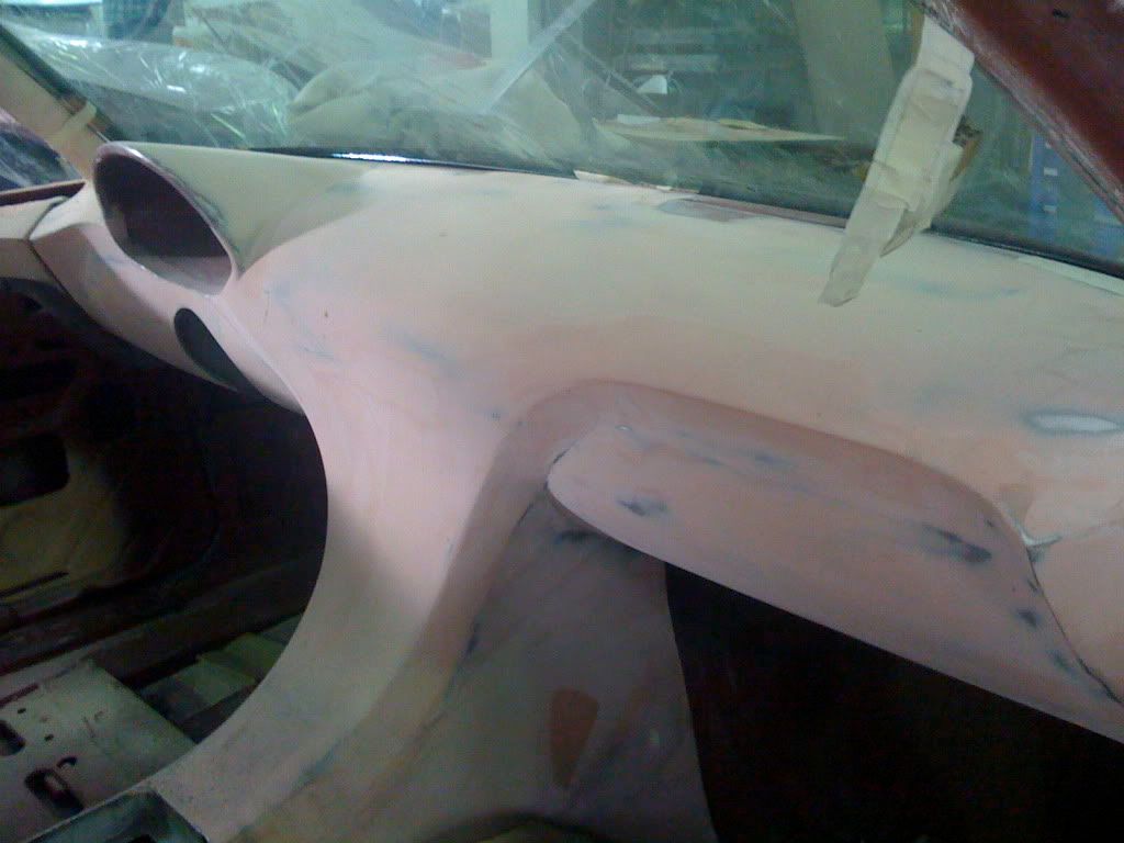

cluxford 08-01-2008 04:07 AM
July update.....lots more work done on dash and console and started to put in flush mount door handles...coming along nicely

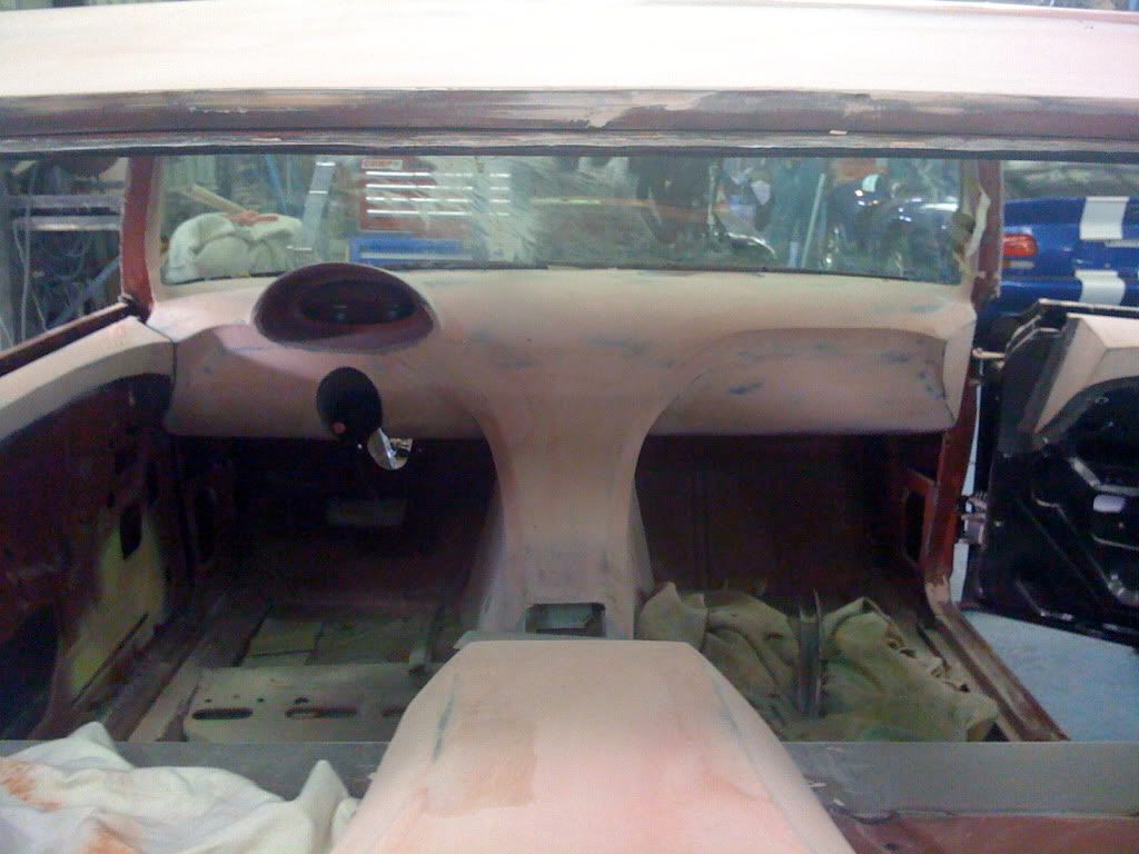

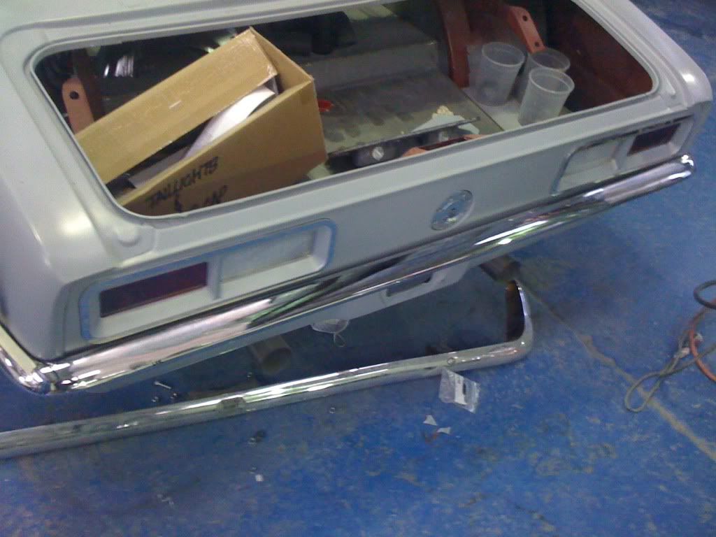

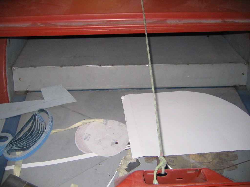

cluxford 05-26-2009 06:31 PM

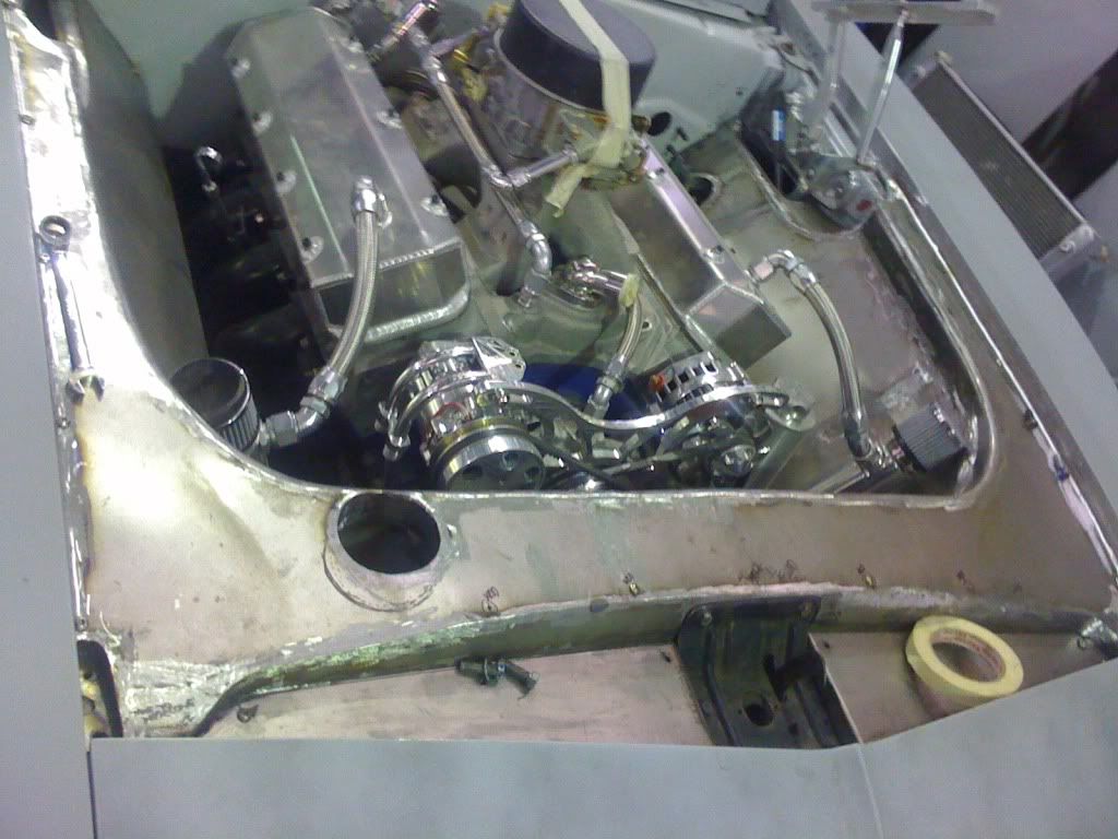

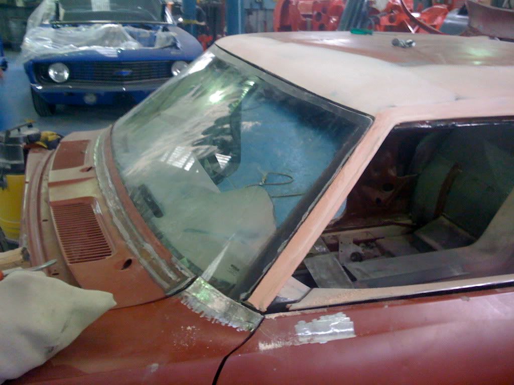

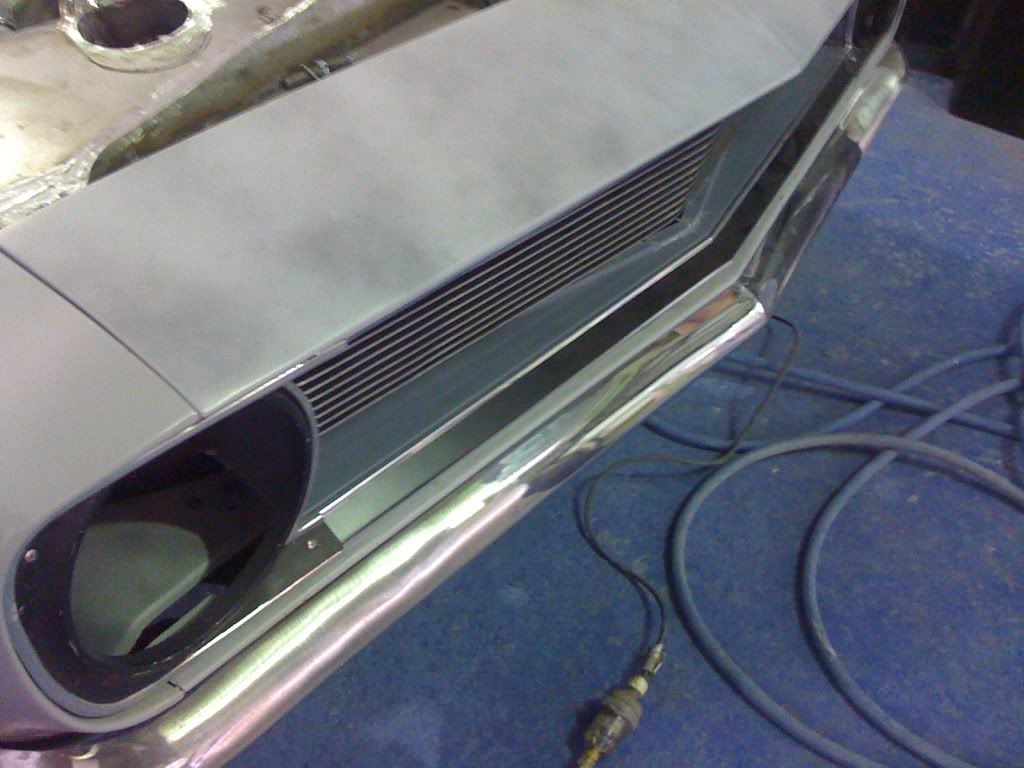

Latest update. Long update quite a few pics below

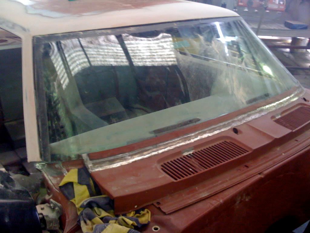

Guys working on the Camaro have been flat out. Paint Prep has started.
Front glass is set up for flush fitting. Check out what we have done with the cowl and front guards.
Car will be in high fill next week and flipped over for underside treatment.
http://i156.photobucket.com/albums/t...d/IMG_0564.jpg
http://i156.photobucket.com/albums/t...d/IMG_0565.jpg
http://i156.photobucket.com/albums/t...d/IMG_0566.jpg
http://i156.photobucket.com/albums/t...d/IMG_0567.jpg
http://i156.photobucket.com/albums/t...d/IMG_0568.jpg
http://i156.photobucket.com/albums/t...d/IMG_0569.jpg
http://i156.photobucket.com/albums/t...IMG_0570-1.jpg

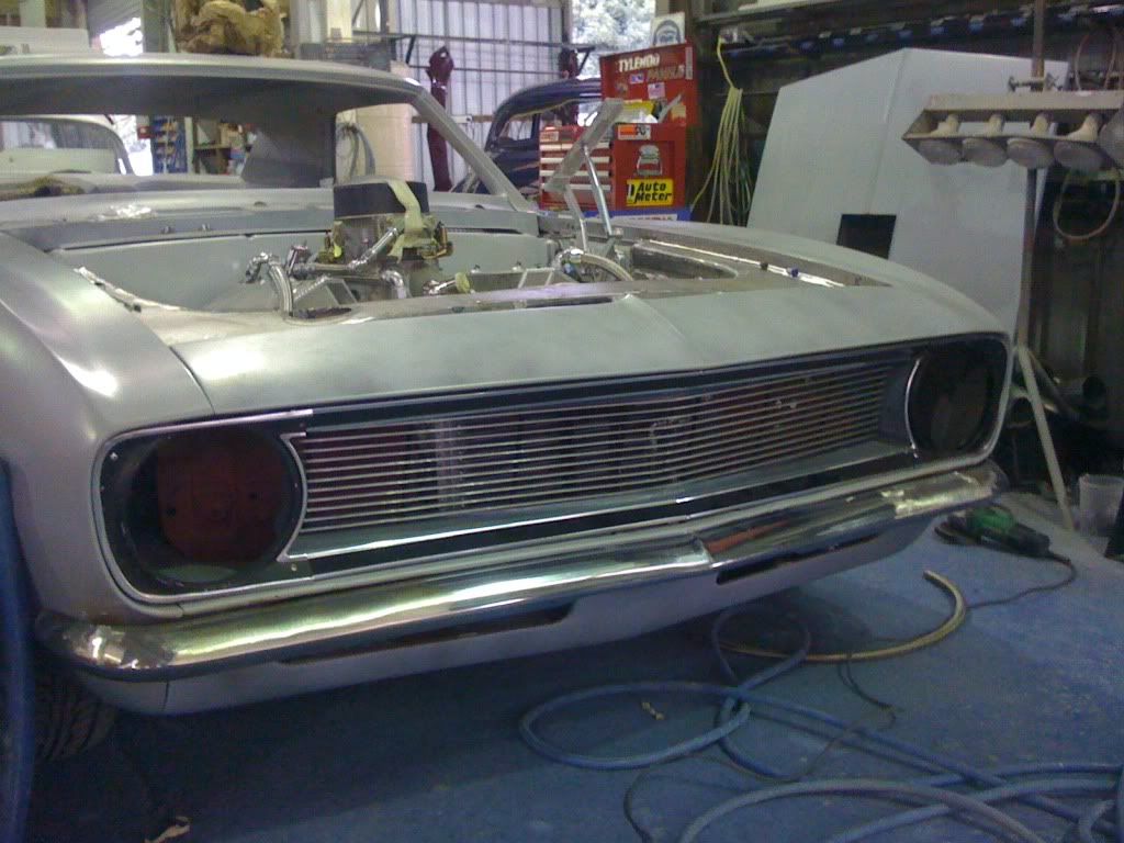

Metal hood liner as well.....
http://i156.photobucket.com/albums/t...d/IMG_3897.jpg
Gauges in (Dakota Digitals)
http://i156.photobucket.com/albums/t...d/IMG_3889.jpg

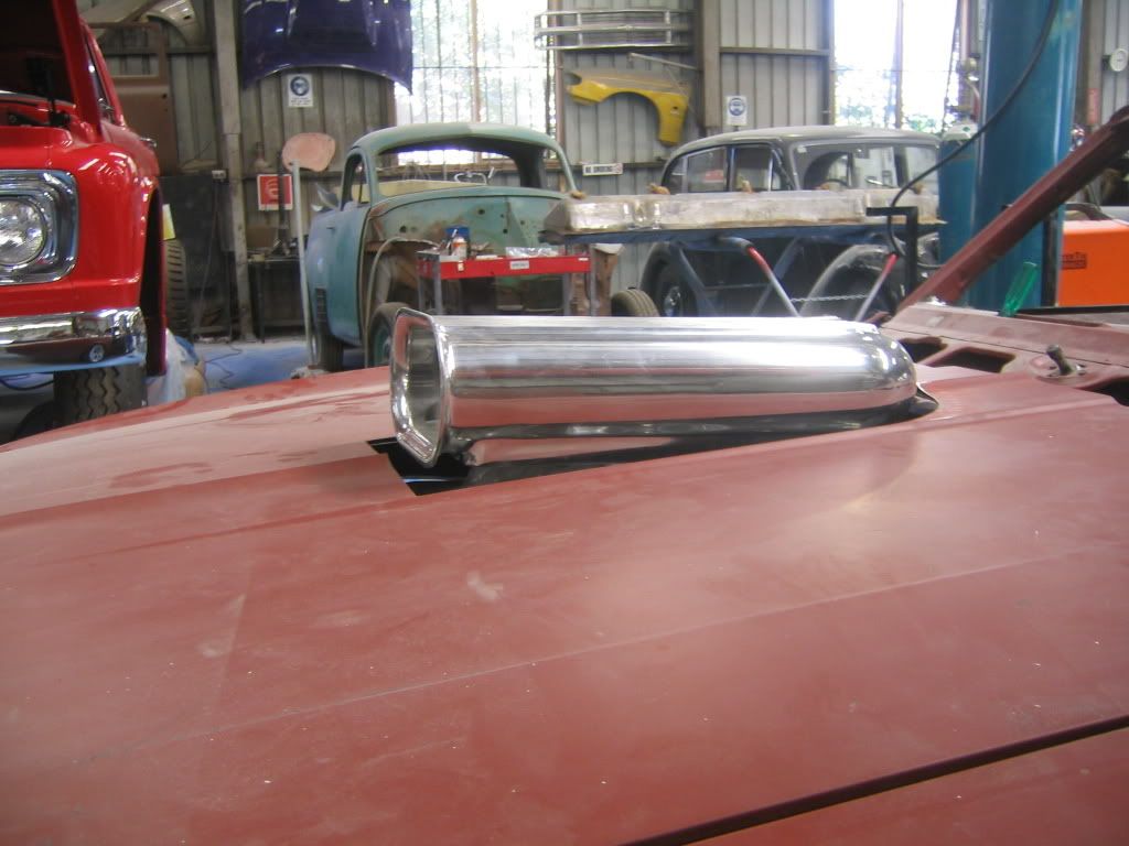

Scoop sitting proudly through the hood
http://i156.photobucket.com/albums/t...d/IMG_3891.jpg
mexMan 05-26-2009 07:19 PM
scoop
are you sure about the scoop coming out from the hood? in my opinion, it looks a bit ricey, at least if it's not using supercharger, is it? overall I like it, and I can't wait to see it finished, I bet the finished product will kick ass
cluxford 05-26-2009 07:28 PM
Hard to register it in Oz with a blower. Protrusions out the bonnet cannot be more than 16mm (even this is stretching it), so for now it is running dual quad intake with twin 600 edelbrocks.
Once registered, then I will most likely supercharge and fuel inject it.
I still like the look of a dual quad scoop out the bonnet, like it way way better than a 4" cowl.

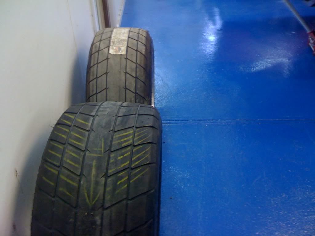

cluxford 08-12-2009 02:57 PM
Couple of updated pics.
Car in primer now.
Off to Trimmer, Auto Electrician and Exhaust for pre-fitting and other pre-paint work.
Paint is now selected PPG Liquid Crystal Vibrance Series. Yellow Pearl
As it sits is it's ride height. 4" clearance. It's damn low.
May put wider meats on the rear, currently 325 x 17 x 45. M&H make a 390 x 40 x 17.
http://i156.photobucket.com/albums/t...d/IMG_0969.jpg
http://i156.photobucket.com/albums/t...d/IMG_0970.jpg
http://i156.photobucket.com/albums/t...d/IMG_0971.jpg
http://i156.photobucket.com/albums/t...d/IMG_0972.jpg

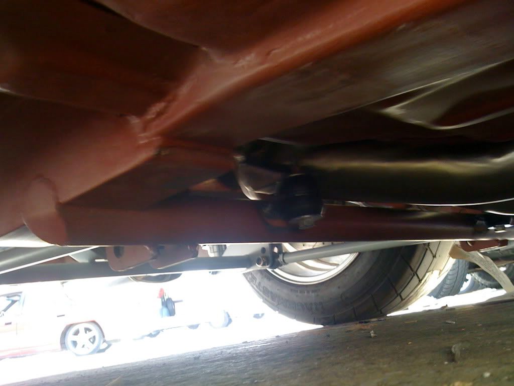

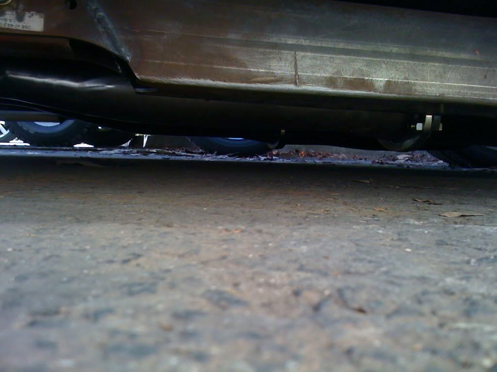

cluxford 12-15-2009 11:04 PM

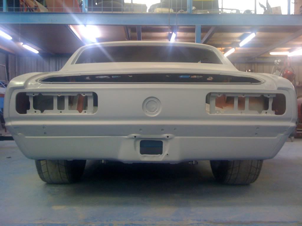

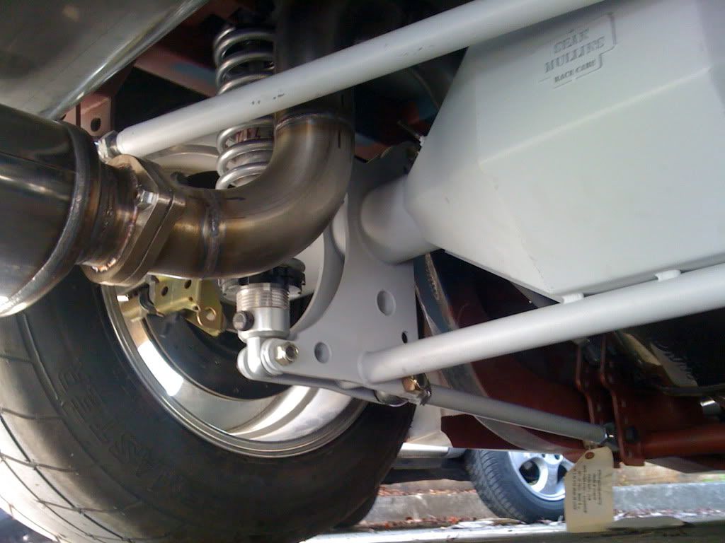

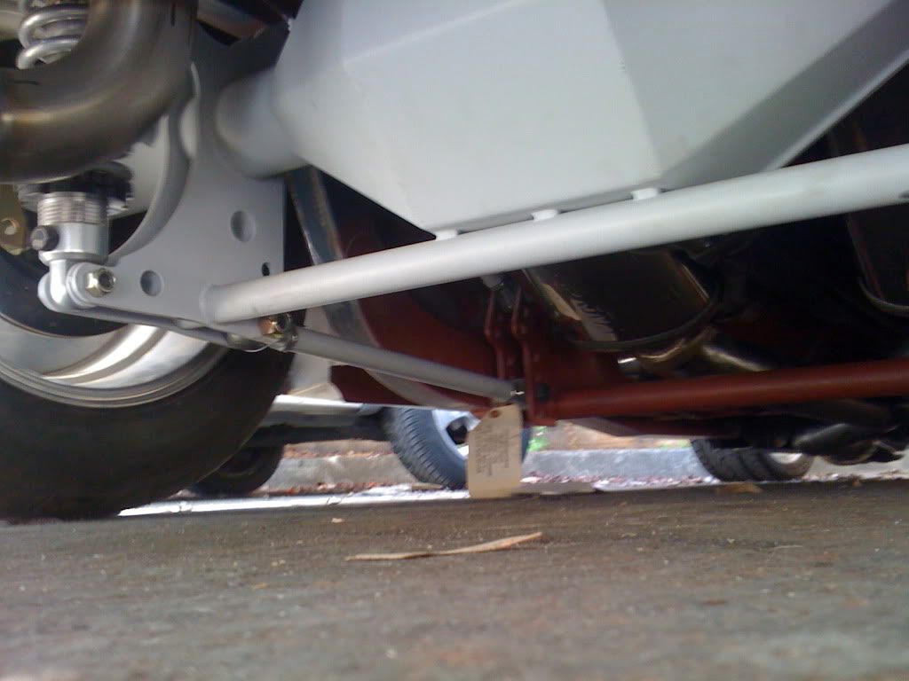

OK some visual updates....
Car was sitting out in the sun today, first time I've seen it outside.
Ride height is too low, chassis is a bee's dick off the ground at about 2 inches, so it will obviously have to come up 2 inches for rego, but I think I will take it back down to 3 inches post rego, cause damn it looks tough that low...question is whether it will clear the shiity road hazards at that height, I strongly suspect it will not !!

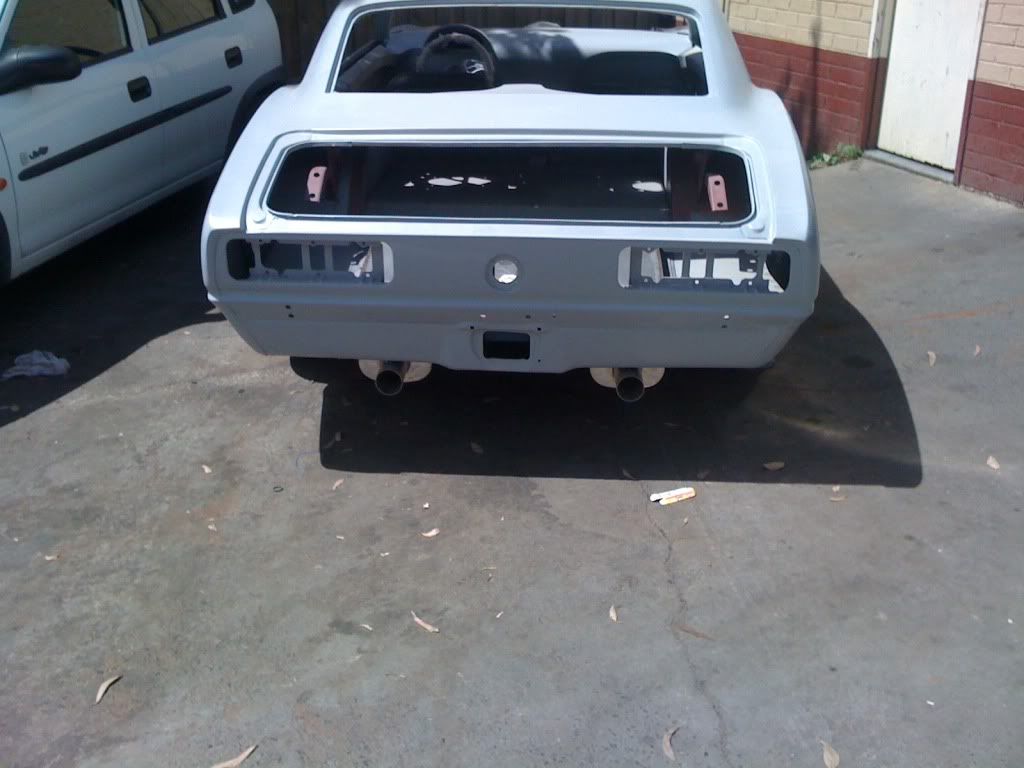

No real good shots of the new exhaust as I had trouble even getting my iPhone under the car to snap pics
The rear mufflers will not stay, as mentioned before there are 2 mufflers either side to get it quiet enough for rego, post rego off come the rear 2 and it will be just pipes out the rear
Best pics I could take with iphone under the car
http://i156.photobucket.com/albums/t...d/IMG_1353.jpg
http://i156.photobucket.com/albums/t...d/IMG_1354.jpg
http://i156.photobucket.com/albums/t...d/IMG_1355.jpg
http://i156.photobucket.com/albums/t...d/IMG_1356.jpg

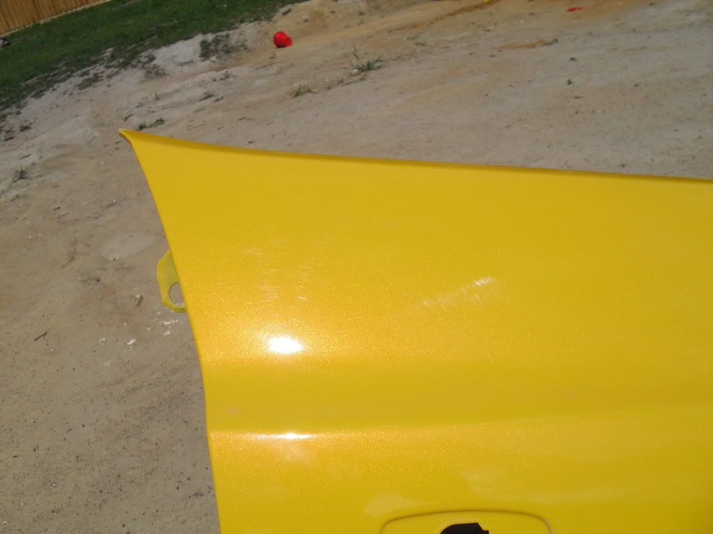

cluxford 12-15-2009 11:08 PM

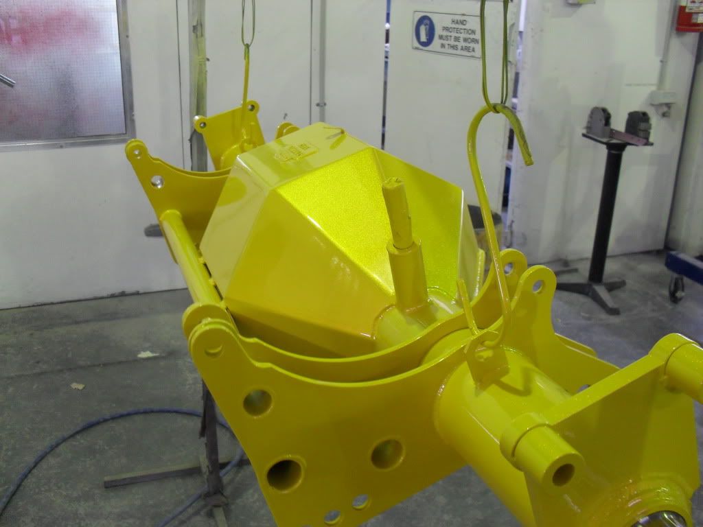

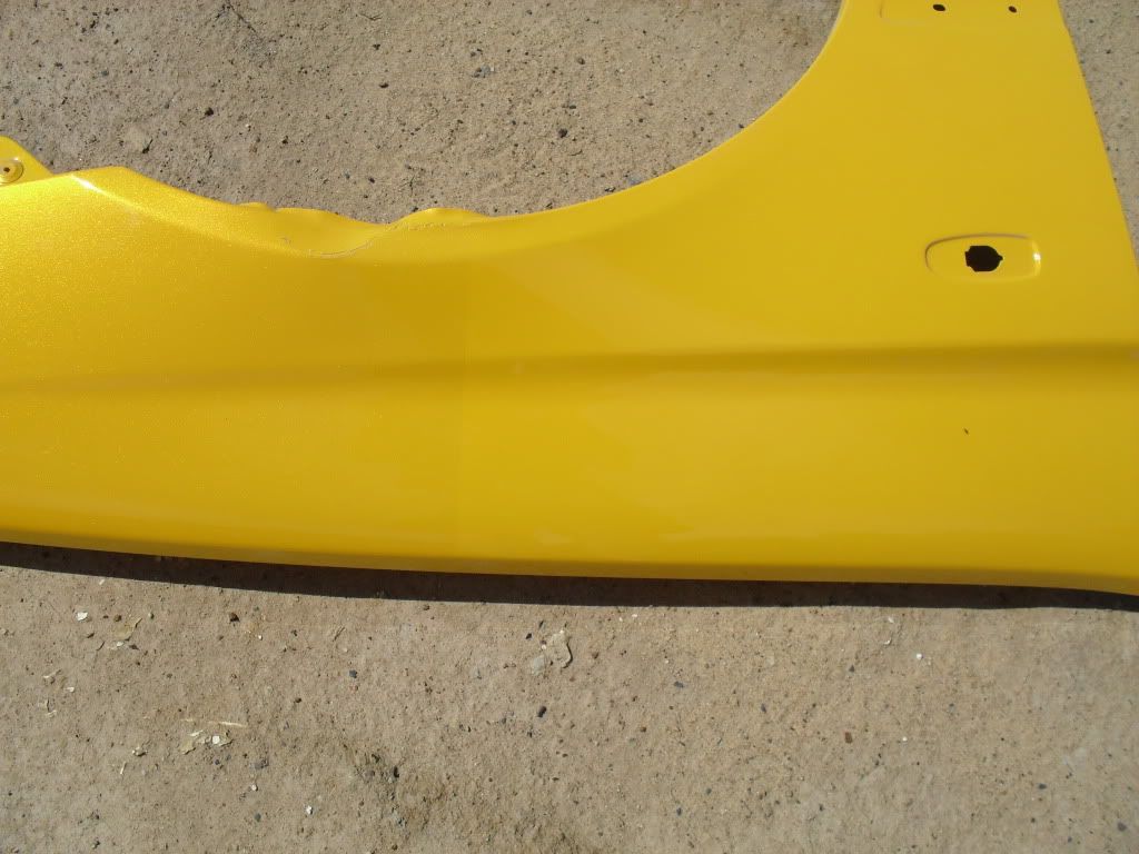

Now the really exciting pics.....

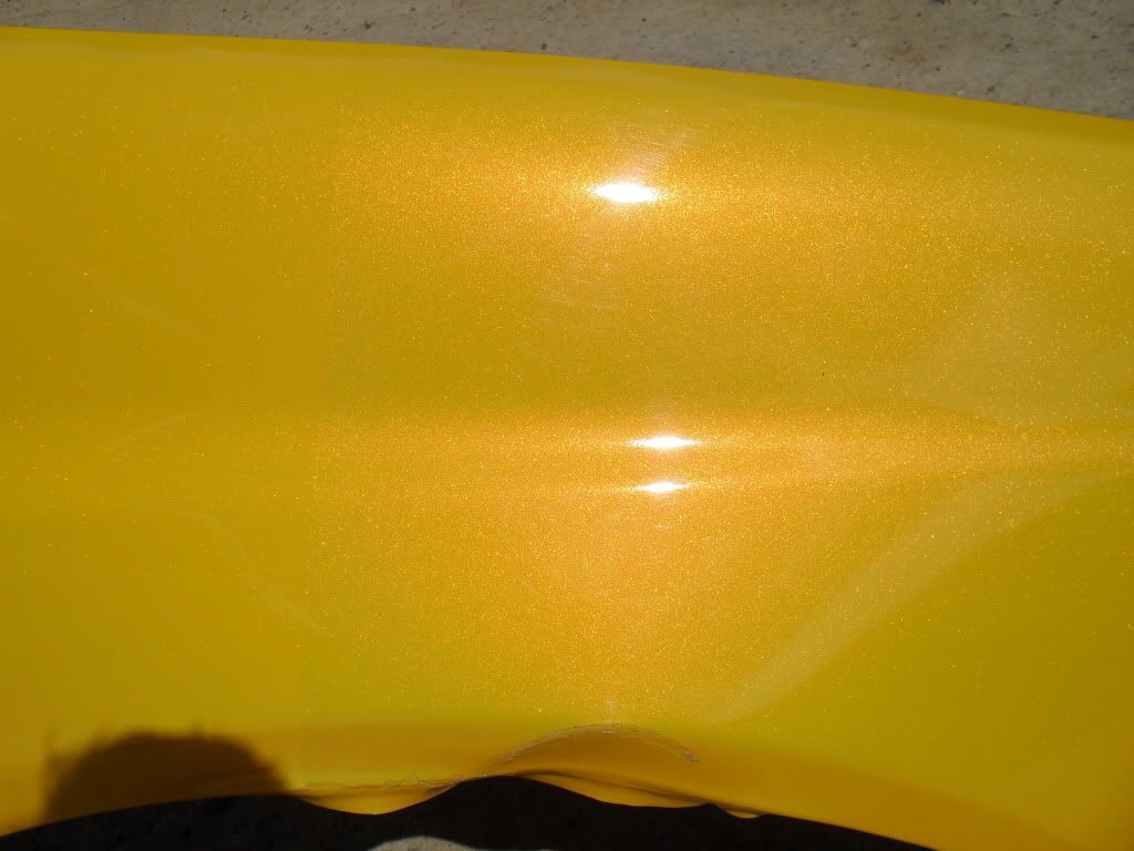

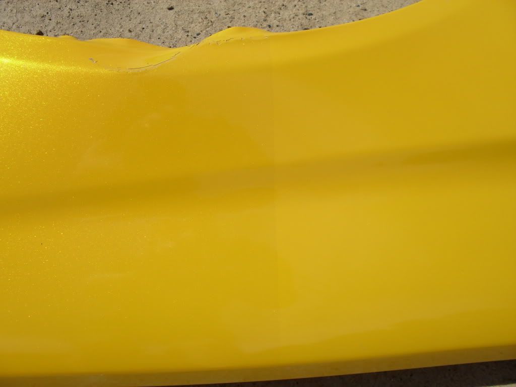

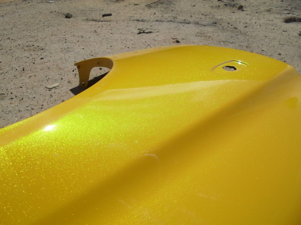

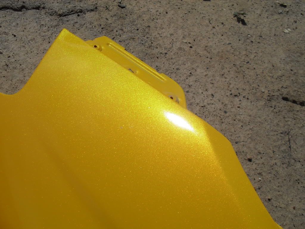

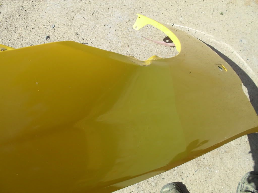

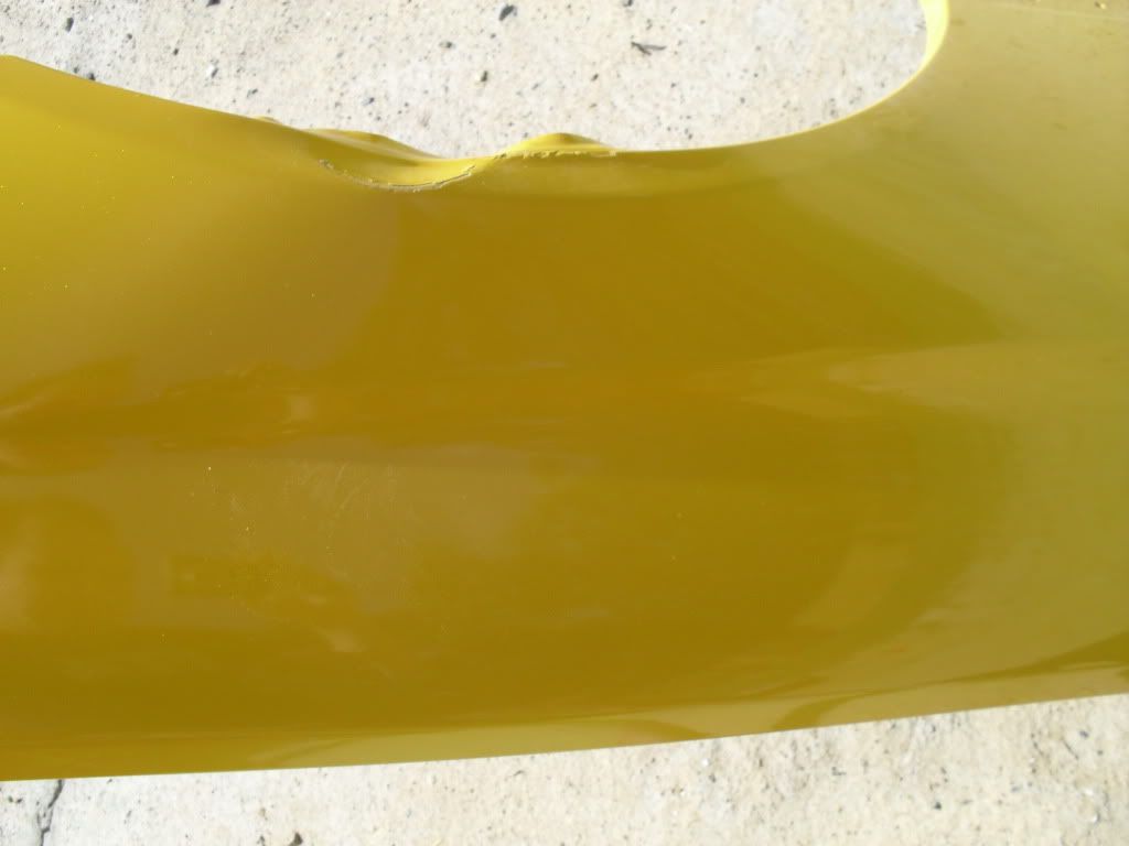

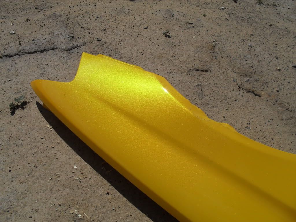

The shop painted up an old falcon guard in the pain we will be painting her...
PPG Vibrance
Oh man I can't tell ya how fricken excited I am, this colour is exactly what I was looking for....
OK to set it up.
The guard has 5 coats of yellow base coat
the rear of the guard has 2 coats of pearl
The front of the guard has 3 coast of pearl
then 2 coats of clear
We will likely run 5 base, 3 pearl, 4 clear, block it, run another 1 or 2 coats of pearl for the "ghost" flames, then more clear
All in all I like it, i love the green and red tinges when the light hits it at different angles, I love the metal flake, and I love the fact that the number of coats actually becomes lighter or darker depending on angle of light. Check out the pics, the front which has 3 coast, is darker than the rear in some shots , and then lighter in other shots at different angles.
Dissapointed we will miss paint before Xmas, just awaiting wheels now before we go to paint...they haven't left the US still being polished as we speak...hopefully they will go out this week
Enjoy...
http://i156.photobucket.com/albums/t...d/SDC10347.jpg
http://i156.photobucket.com/albums/t...d/SDC10348.jpg
http://i156.photobucket.com/albums/t...d/SDC10349.jpg
http://i156.photobucket.com/albums/t...d/SDC10350.jpg
http://i156.photobucket.com/albums/t...d/SDC10351.jpg
http://i156.photobucket.com/albums/t...d/SDC10352.jpg
http://i156.photobucket.com/albums/t...d/SDC10353.jpg
http://i156.photobucket.com/albums/t...d/SDC10354.jpg
http://i156.photobucket.com/albums/t...d/SDC10355.jpg
http://i156.photobucket.com/albums/t...d/SDC10356.jpg
http://i156.photobucket.com/albums/t...d/SDC10357.jpg
http://i156.photobucket.com/albums/t...d/SDC10358.jpg

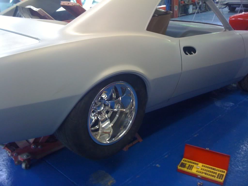

cluxford 01-11-2010 11:37 PM

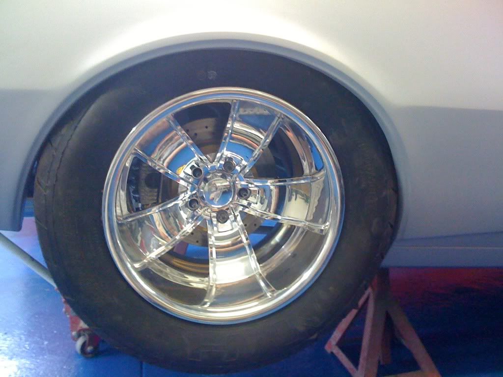

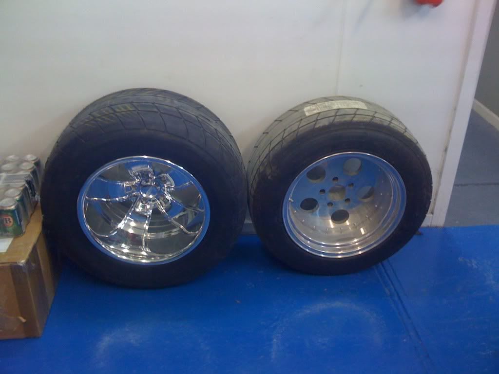

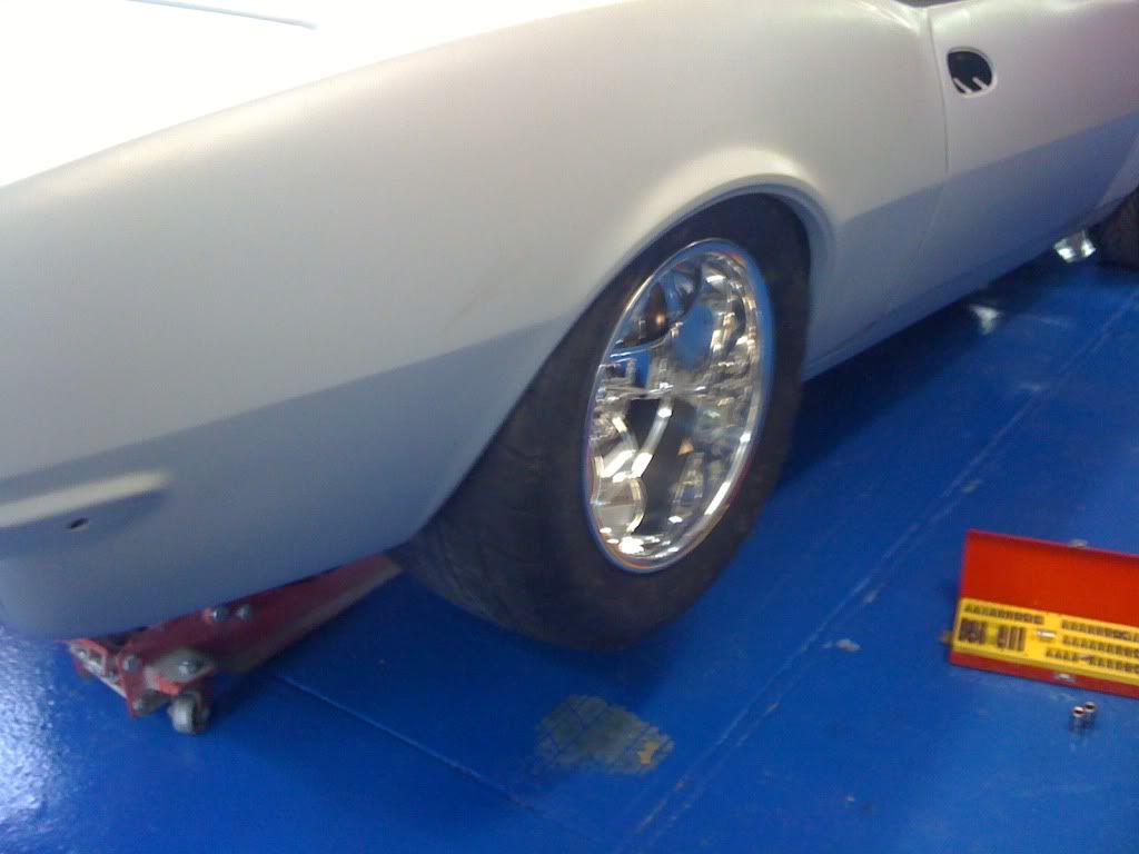

OK, so the new Rushforth wheels arrived last week. Wasn't quite happy that the old one filled up the guards enough.
Got down to the shop today, they were open (after the Xmas / New year holidays).
Got down there late, but had a chance to fit up one rear rim before they closed.
Remember key goals:
1. Fill up the guards better than the existing 17x12 325's
2. More modern billet wheel
So remove the old. Oh sh1t can't get the new one on, wont squeeze in, hits the wheel arch
Deflate the tyre. Now we can squeeze it in.
Wow, fits perfect, but rubs on the rear of the wheel arch, front of the arch clears by about a quarter inch, rear rubs, and the top clears but by millimetres.
Now we will have to roll the lip front and top. rear will need to cut the wheel arch and shift it back half to three quarters of an inch. But this is exactly the look I am after, a big fat tyre stuff in filling up the whole wheel arch with the guard over the tyre (ala pro-street - but i keep my ability to have back seats)
Either way, I am loving these, damn they are huge even against the old 17x11 325's.
These pics are with it about where it will sit (diff jacked it , its not sitting on stands)
http://i156.photobucket.com/albums/t...d/IMG_1400.jpg
http://i156.photobucket.com/albums/t...d/IMG_1402.jpg
http://i156.photobucket.com/albums/t...d/IMG_1401.jpg

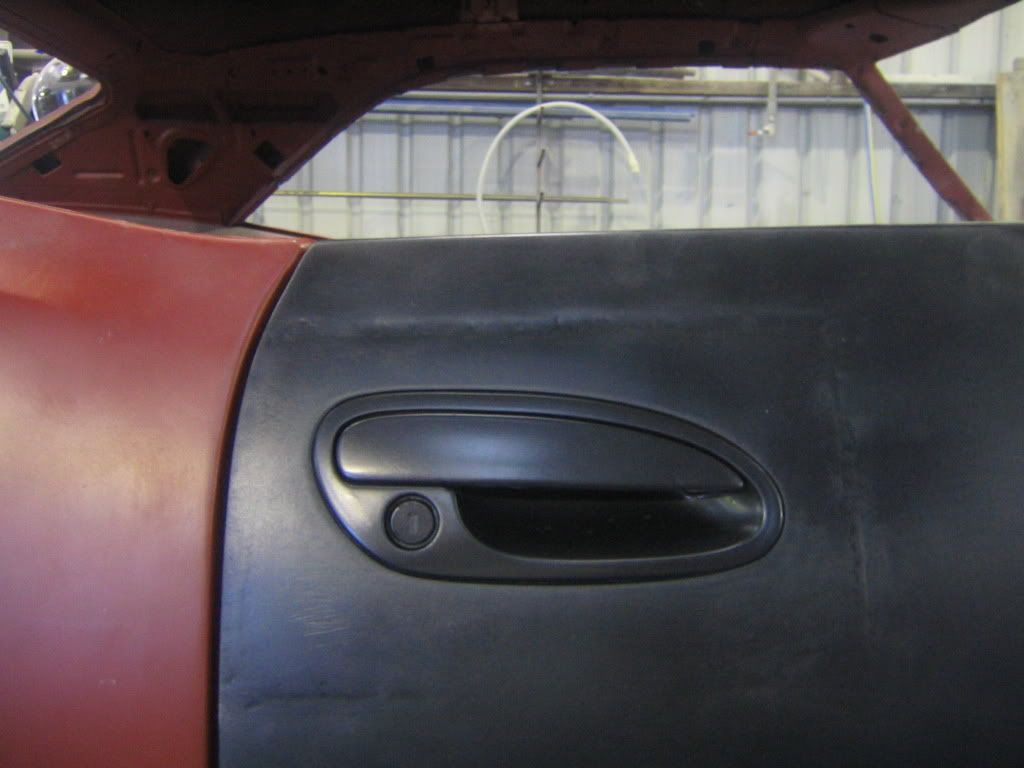

Old versus new....
http://i156.photobucket.com/albums/t...d/IMG_1404.jpg
http://i156.photobucket.com/albums/t...d/IMG_1405.jpg
70rs 01-12-2010 12:19 PM
I'd say it has pretty much filled in the wheel opening.:wow:
cluxford 04-29-2010 05:38 AM

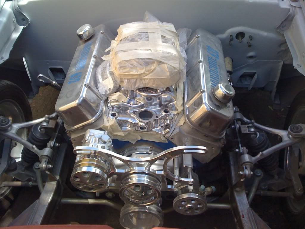

Engine bay almost done. Closeout panel now complete. Moved the oil catch cans due to change in closeout panel
Bumpers now smoothed (bolts welded and shaved) also pulled right into the body
Billet grille now on and in place
Only minor things now like filling holes, smoothing engine bay, etc etc before we go to paint.
Also got a 4" Cowl hood for it so will be registered with the single 1050 Dominator and the 4" Cowl. Then that will come off and the tunnel rammed twin 1000 Race Demons will go on. Blower will follow later
Loving the bars, grille and engine bay

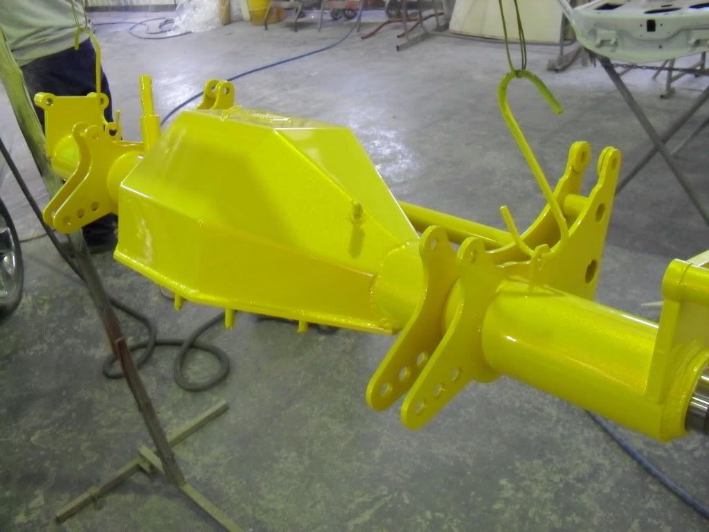

cluxford 06-22-2010 09:21 PM
We have PAINT !!!!!
Underside stoneguarded on Mon, and painted last night
Interior painting (ie roof liner, dash, console etc) will be later this week
3 coats of base yellow and 4 of pearl, 3 clear
Interior fluro lights don't do a good job of showing the pearl, it looks fricken awesome, oh and way way brighter and much more yellow than I was expecting, she'll be damn bright when in full yellow...but I am stoked, exactly the colour I wanted...
http://i156.photobucket.com/albums/t...d/SDC10595.jpg
http://i156.photobucket.com/albums/t...d/SDC10596.jpg
http://i156.photobucket.com/albums/t...d/SDC10597.jpg
http://i156.photobucket.com/albums/t...d/SDC10598.jpg
http://i156.photobucket.com/albums/t...d/SDC10599.jpg
waynieZ 06-23-2010 02:28 PM
Wow nice work, it looks great I like the color. You can see some of the pearl on the firewall.
awr68 06-23-2010 03:28 PM
Looking good! I like the yellow!!

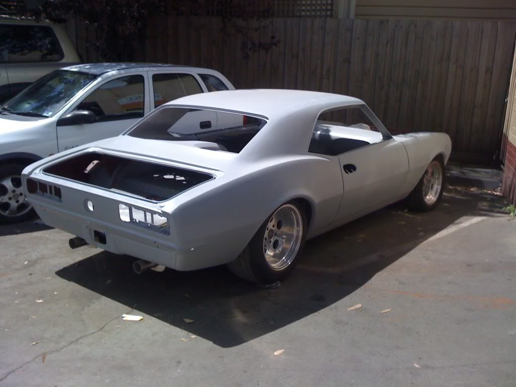

cluxford 07-06-2010 07:54 PM
This looks way way too good to be 4" off the ground and rarely seen......
Interior fluro lights don't do the colour any justice at all, I seriously can't wait to see it in the pure bright sunshine
