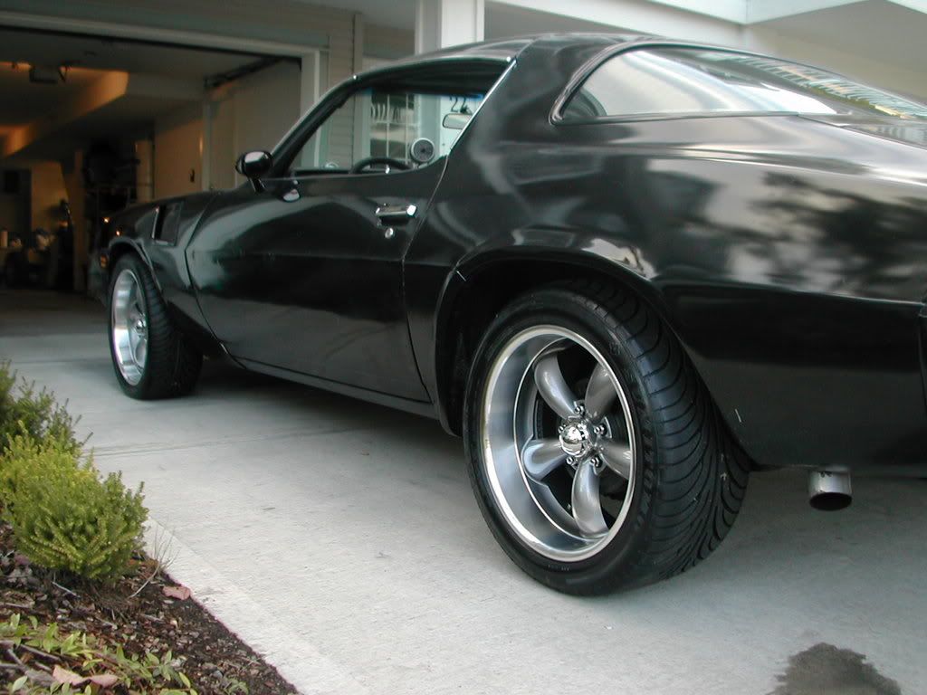

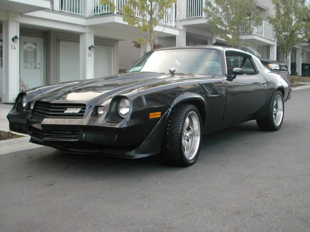

I could post a pic or two of my 81 camaro with 18x8 4.5 bs front and 18x9.5 5.5 bs rears if you'd like. It's not a 70-73 but you may still get an idea of how those sizes look.

Zedzag 10-08-2009 10:03 PM
245/45/18 front
275/40/18 rear
http://i231.photobucket.com/albums/e...g/DSCN3977.jpg
http://i231.photobucket.com/albums/e...g/DSCN3974.jpg

Zedzag 10-13-2009 05:19 PM
Originally Posted by The T-man (Post 239961)
what's the rim width on those?
8" and 10" or?
Front 8" , rear 9.5 "
