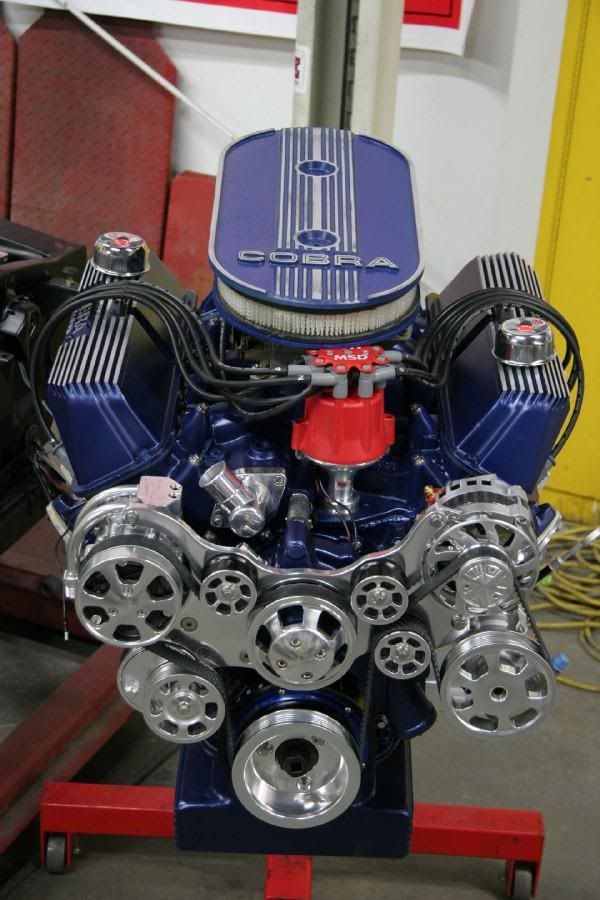

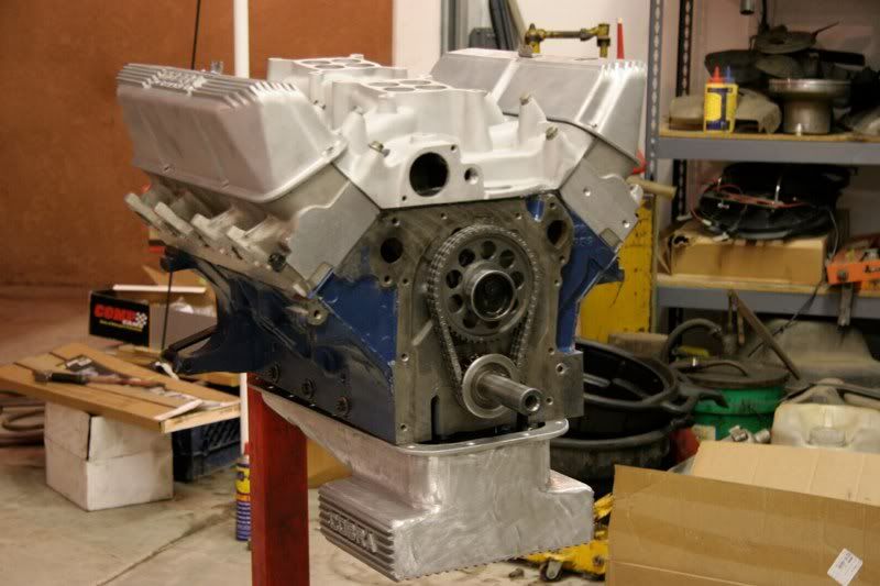

The pictures all you Ford guys have been waiting for!!!
http://i298.photobucket.com/albums/m...187_detail.jpg
These were our options Boss 429 / Boss 302 / Tunnelport 427
http://i298.photobucket.com/albums/m...227_detail.jpg
This one is actually going in a 23 T bucket. If anyone has a good memory, think back to Popular Hotrodding March of 71 on the cover, This is the motor to that T bucket, and we have the T bucket too, doing a restoration on it to the way it was in 71

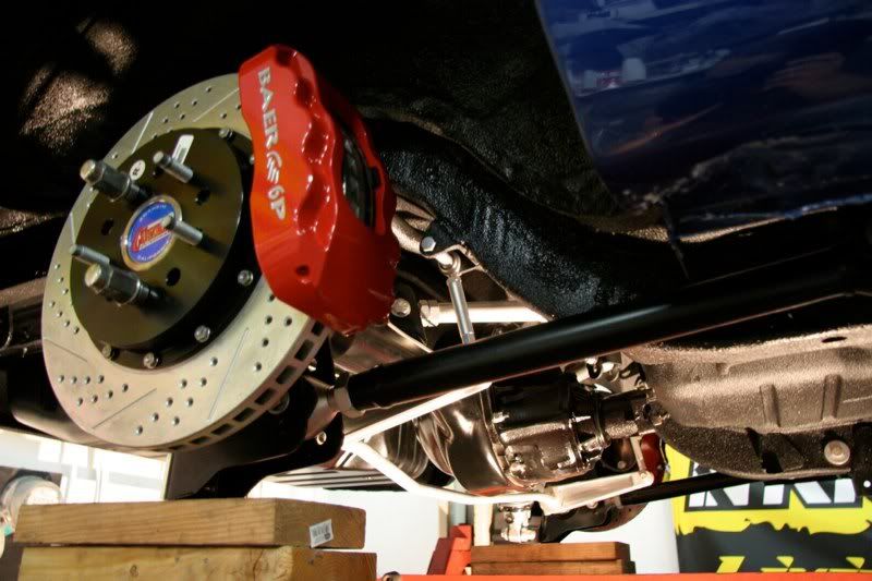

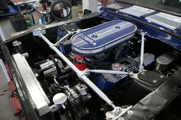

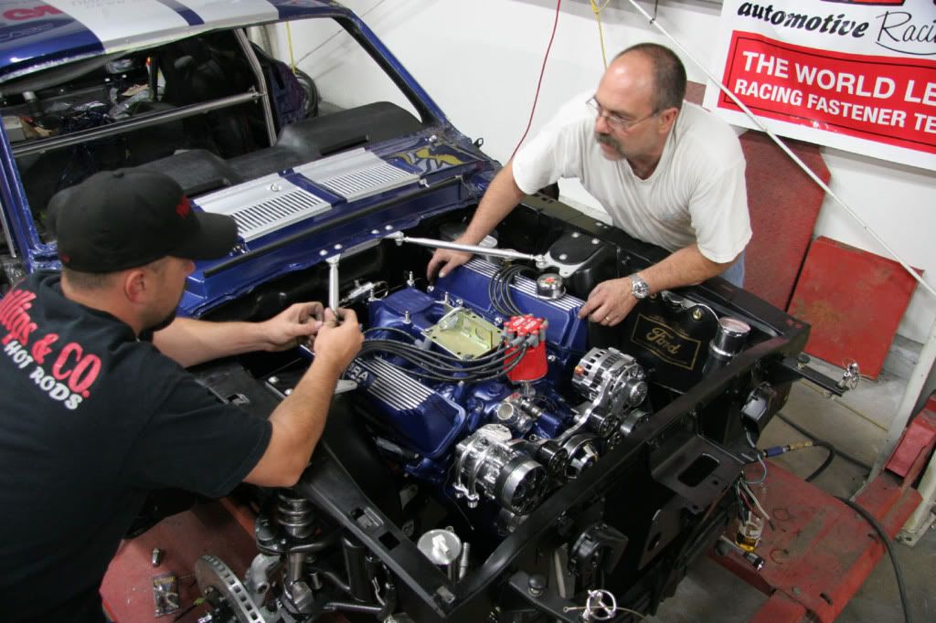

PCHRODS 10-30-2008 12:58 PM
SEMA's Almost here and we're almost done
well it's been awhile since I was last on here but the car is almost done and it turned out a lot better than anticipated. The motor was a huge head ache. After sending it out for machine work we found that the heads were no good so we found an original set of 67 aluminum tunnel port heads, and then we ended up stroking the motor. Now we are pushing approx. 780 H.P. !!! The car will be in Gear Vendors Booth @ Sema next week be sure to stop by and check it out
