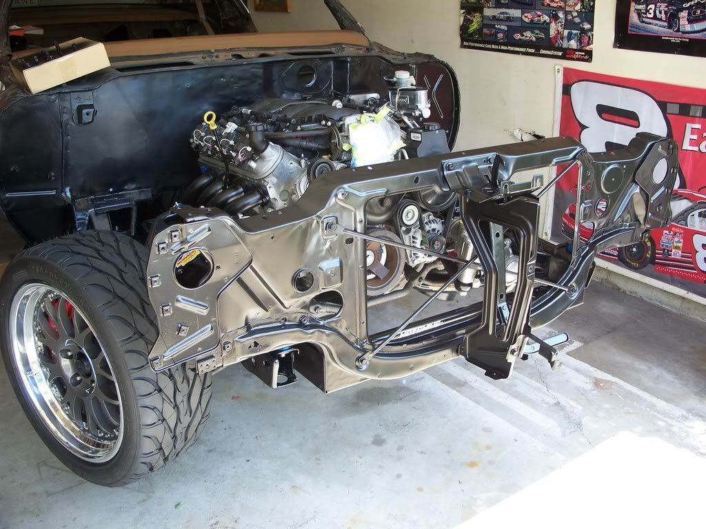

Iam 23 years and have had the car since i was 15 years old. well its a 79 Z28 and iam trying to rebuild it. so I have a 2002 ls1-t56, with a torquer v-3 cam kit, ported ls6 oil pump, pushrods and pacesetter long tubes, and a moser 12 bolt rear. all the other stuff you can make out for yourself as its not much yet. so here are some pics.

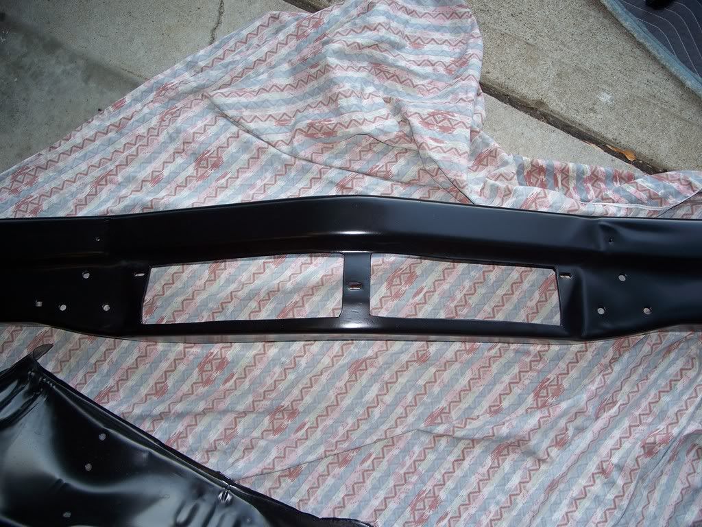

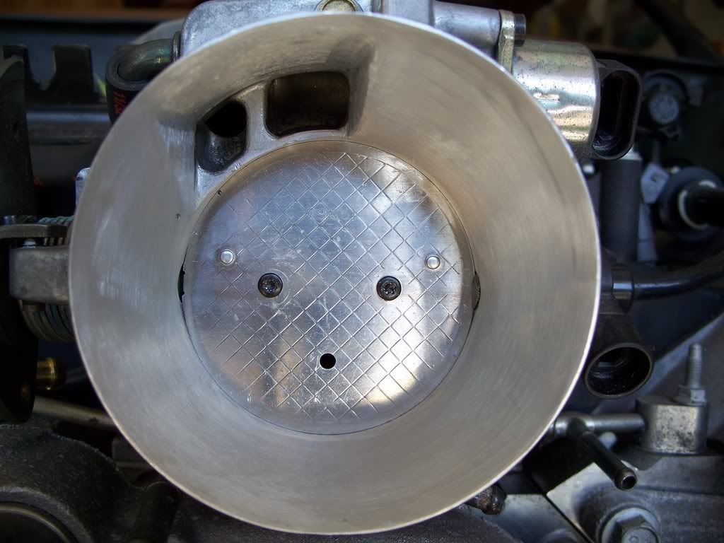

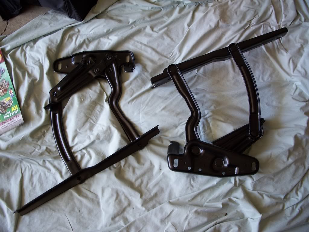

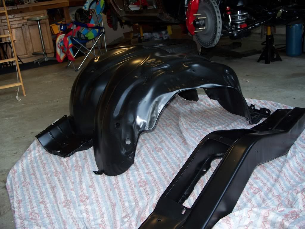

Have not done much as I cut a tendon in my left hand and have not been able to use it for the past three weeks and still have about two more to go but I still get around and work on the car just dont tell my Doc got the core/support back from powder coating and you can see were the blasting broke threw were the battery had been leaking, but not much i can do about that now. at least you wont see it, along with the hood hinges.I also had sent out my LS1 T/B to be ported, and to have the cross shaft and bump stop mod done to it and I think that it came out real nice, for those that know about the rear brake situation iam having to get a machine shop make the rear t-bolts that i need for the KORE3 e-brake kit to work with the big ford bearing on my moser 12 bolt but i should have it together next week but hear are a few pics of the parts on the car and still need some clips and stuff but i cant get those free from work will post up more whn it happens.
Brandon

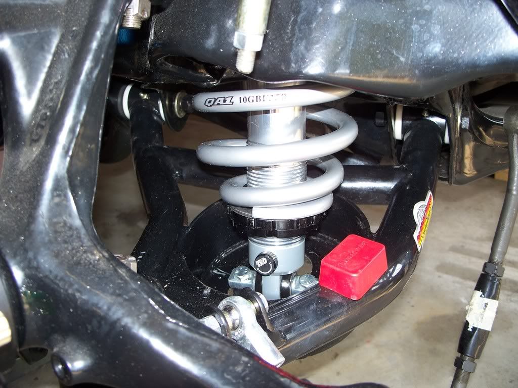

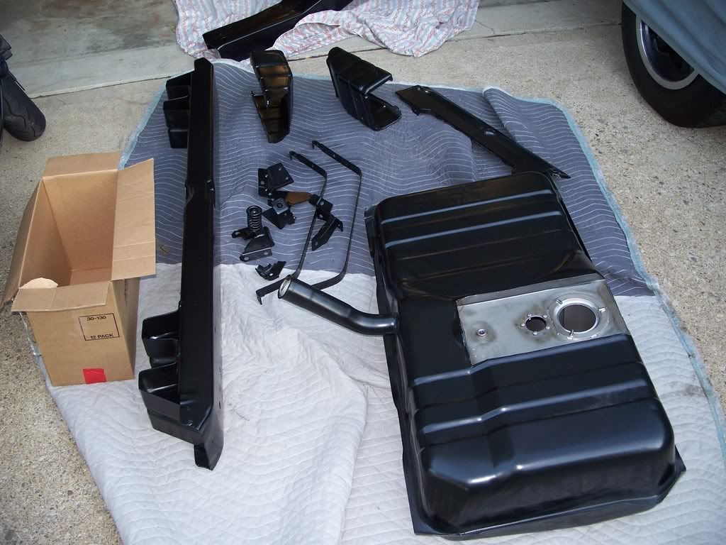

just a small up date i have ben working on getting ,my rear brake setup to work with the moser rear and finalyy got the bolts made that worked great. so with that said the Qa1 that i installed and some more parts that i got powder coated and he hooked me up and blaster and coated them for 350$ i dont think thats bad?? and i also got my tank back from rockvalley.com and they do great work i didn coat all of it as its stainless so it wont rust anyway and didnt want to mess with a good seal on the sender thay made for me.
http://i224.photobucket.com/albums/d...z/100_0316.jpg
http://i224.photobucket.com/albums/d...z/100_0318.jpg
http://i224.photobucket.com/albums/d...z/100_0319.jpg

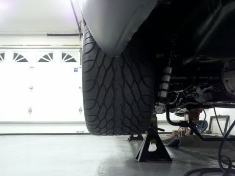

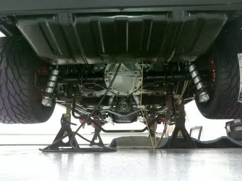

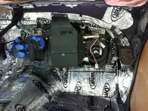

Just a little update, I have the mini tubs in and done most of the vintage air installed and just got all the four link stuff finished and put back under the car. Still need to run back over it all and install the rear sway bar but for the most part its done, Kinda a lot of work lol...

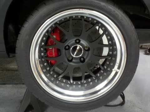

The spec on the rear wheels and tires are 18*12 with 5.5bs and 335/30 tire
I figure someone will ask haha, Its a ride tech four link with weld on brackets and a rear end width of 56.25 axle flange to flange, ( but measure yours if you afe doing this).
If you have any questions just ask and I will do my best to answer them, after all thats what this is all about.
Now on to the stuff that matters
http://i224.photobucket.com/albums/d...wn383z/ab1.jpg
http://i224.photobucket.com/albums/d...wn383z/ab3.jpg
http://i224.photobucket.com/albums/d...wn383z/ab2.jpg
http://i224.photobucket.com/albums/d...wn383z/ab5.jpg

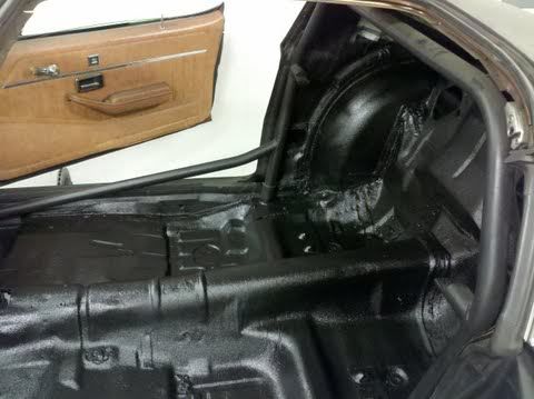

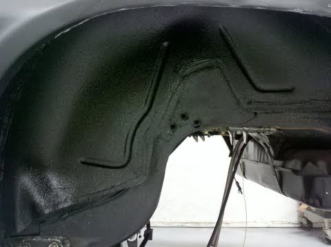

I used UPOL spray in liner on the wheel tubs, trunk and floors this stuff is very easy to apply and I think it looks great.
http://i224.photobucket.com/albums/d...wn383z/ab4.jpg
http://i224.photobucket.com/albums/d...wn383z/ab8.jpg
I have the lines real close to where I want them and will do a finall ajustment when I put the fenders on,
http://i224.photobucket.com/albums/d...wn383z/ab6.jpg

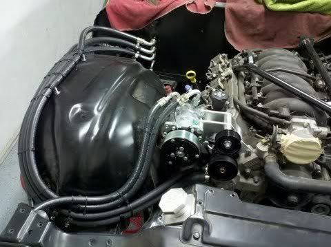

This was a pain not much room to get to the bulk head but it can be done, I mounted the heater hose valve on the back on the unit so you cant see it and also mounted the dryer on the fire wall behind the inner fender
http://i224.photobucket.com/albums/d...wn383z/ab7.jpg
syborg tt 01-06-2012 07:06 PM
Glad to see it your still working on the car. Itlooks great.
Got any close ups of how you did the rear brackets.
Did you move from the front spring pockets in-board ?

brownz 01-06-2012 08:26 PM
with the ride tech kit they are now making all the bars offset to clear a bigger tire so i did not have to move the front pocket.

syborg tt 01-08-2012 07:22 AM
Originally Posted by brownz (Post 388315)
So you have the new offset lower link from Ride Tech. So you have enough room to tuck the 335. I placed one of my tires under the car and I would need to move the lower arms in about an 1.5".
Can you take a couple more pictures ???
brownz 01-08-2012 08:25 AM
Sure just let me know what you need!
I have the weld on brackets not the bolt on that originaly come with the kit. I think they give you a little more room aswell, not between the bar and tire but the bracket and the tire
Will you need the pics with the wheel/tire back on? if so I will need to put them back on. I keep them in the office LOL
