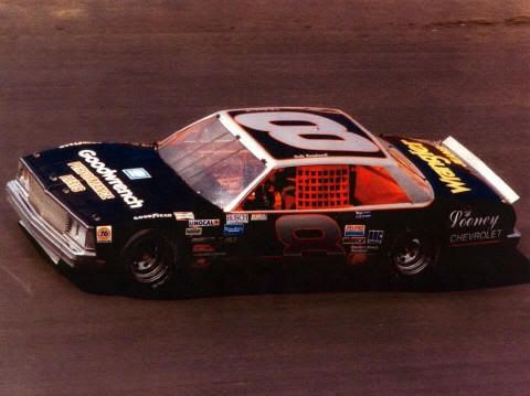

deuce_454 07-17-2008 01:39 PM
Originally Posted by Stuart Adams (Post 157305)
Bring a stewardess b/c if will probably take flight!
like i said, small aero aids will propably be needed.. but it isnt impossible to go fast in a malibu
http://i155.photobucket.com/albums/s...-01E00167-.jpg
Stuart Adams 07-17-2008 02:12 PM
I was just being a smart ass. I'm sure you can do it with the right downforce issues addressed. I definately want to see the video, that would be cool.
deuce_454 07-17-2008 02:39 PM
nobody likes a smart ass :D :D .... LOL I actually got the joke, and posted the pic to get the thread back on track.. not to school you...
