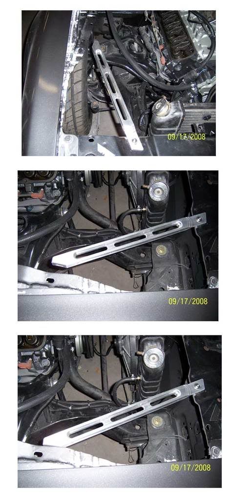

fatboyzkustoms 09-17-2008 04:17 PM
okay so i measured them they are the right size. maybe my brain stopped working but still don't know where to bolt them? this is what they look like in my car. are they both supposed to have a flat end to bolt them? i know on the first gen they bolt sideways to the fender but not on the 2nd gen.
alicia
http://i256.photobucket.com/albums/h...stoms/bars.jpg
skatinjay27 09-17-2008 05:23 PM
you know come to think of it... steve did you ever try on 2nd firebirds???
cause aafter see here pics i remeber a guy in my club made some for his 79 and they mounted flat on the fender and not on the side like the camaros.
alicia my 1970 camaro mounts on the side just like the first gens...
heres a pic of how the stock bars mount in firebirds steve.http://images.highperformancepontiac...ngine_View.jpg
lil427z 09-17-2008 05:58 PM
the 2nd gen camaro is different than the 2nd :cheers: :cheers: firebird.
rick k
fatboyzkustoms 09-17-2008 06:02 PM
i ordered them for a firebird from classic industries and that is what they sent me
alicia
Steve Chryssos 09-17-2008 06:12 PM
Alicia,
You will need to send them back to Classic Industries since they have your money. We'll get to work on some second gen Firebird and T/A bars ASAP and get you out a set at no charge when they are ready to make up for your troubles. Please email or PM me with your contact info.
Sorry for the inconvenience
/Steve
