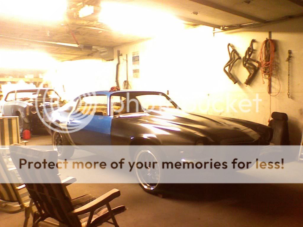

Every Detail 09-17-2008 09:04 PM
thanx guys this is a real help.how much is the g-bar and should i run a sway bar.http://i458.photobucket.com/albums/q...28/cars052.jpg
