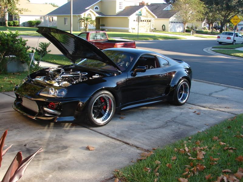

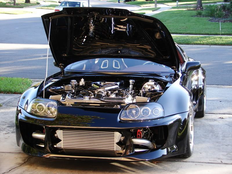

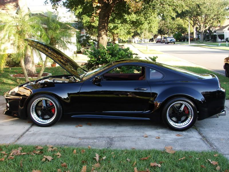

onto more pics
http://i274.photobucket.com/albums/j...upras004-1.jpg
http://i274.photobucket.com/albums/j...upras011-2.jpg
http://img.photobucket.com/albums/v7...ttSupra004.jpg
http://img.photobucket.com/albums/v7...v8supra011.jpg
http://img.photobucket.com/albums/v7...v8supra010.jpg
