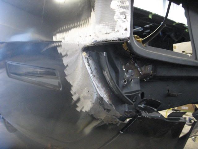

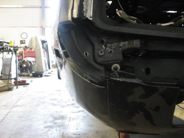

Here are some pix of the quarter Chris installed. It was a quarter skin rather than a ful quarter since most of the panel was in good shape.
Basically the body line of the car is too low and drops down near the bumper recess. The body line should go all the way to the very back of the car, ABOVE the bumper recess. With the way Chris did the install, the body line ends at the bumper recess "corner". I'm still baffled on how he did this. The quarter skin included the bumper recess and the body line in the right spot. From the pix he sent, it looks like he cut the body at the "right spot" to fit the skin, but then later cut the skin and moved the bumper recess to fit where he cut the body. It just makes no sense....
Race Rodz photos

Nice bumper fit :(
http://i229.photobucket.com/albums/e...-19-ned004.jpg
Tim really put alot of thought into trying to fix this, but it just isnt gonna work well. Put this issue together with the other problems with the panel.... the fit over the wheelwell is tweaked and warped, and there is a bulge too...plus the top part is lower than the pass side so the spoiler isnt symmetrical....... and the only choice is to cut it all off and start again. Plus the way Chris did the install, the panel isnt gonna come off easy. He did alot of hideous seam welds rather than plug welds etc. Its far from a decent OEM install. Tim is dreading having to do it, but it has to be done.
