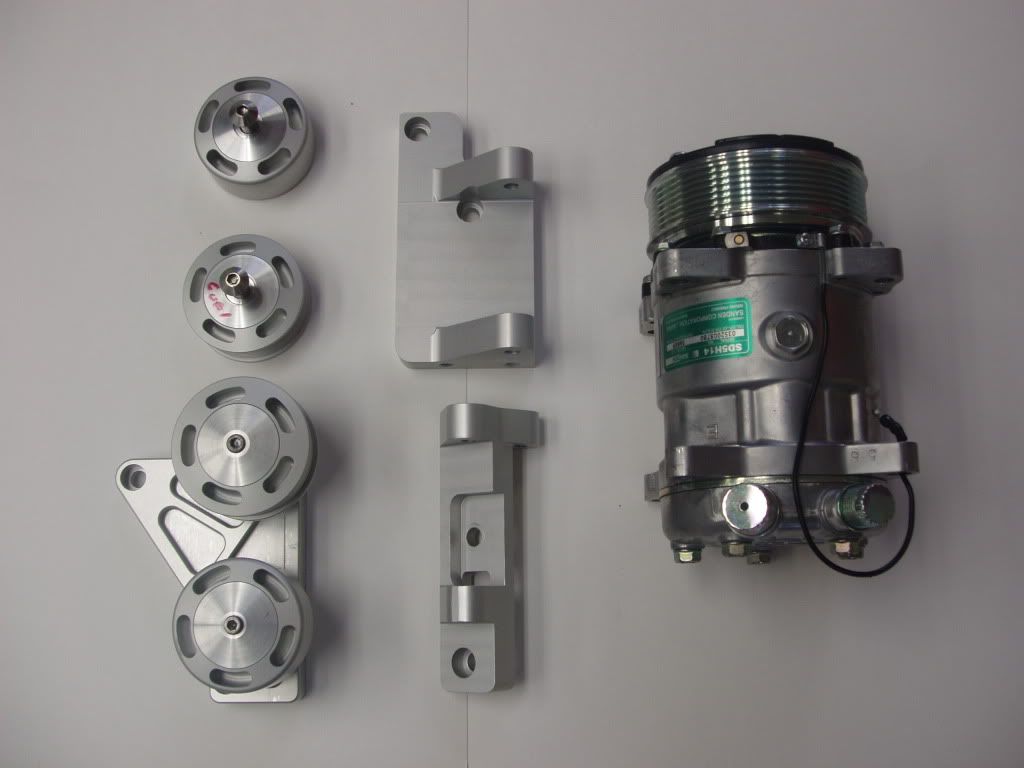

Cris@JCG 12-03-2009 07:47 AM
Saden 7 brackets for LS
We machined these brackets & pulleys for a Saden 7 AC compressor for a LS2tack system.. & dressed up the pulley on OE water pump.. I am ordering a LS1 track system next week for another build here @ the shop & will compare..
http://i1015.photobucket.com/albums/...irebird062.jpg
http://i1015.photobucket.com/albums/...n/P9200015.jpg
Sunkistcamaro 12-03-2009 12:47 PM
Originally Posted by Bow Tie 67 (Post 252210)
Look at the third pic closely, the bracket is only a 1/4" piece of flat stock with a spacer welded to it.
Oh and type in ZEXEL for a compressor search. Repeat after me " Google is my friend "
Your right, the bracket looks easy enough to make.

Sunkistcamaro 12-03-2009 09:31 PM
Wow thats really nice looking!!
Bowtieracing 12-04-2009 12:42 AM
Nice and tight oem package. Beats all 2500+ buck systems in my book:thumbsup:
