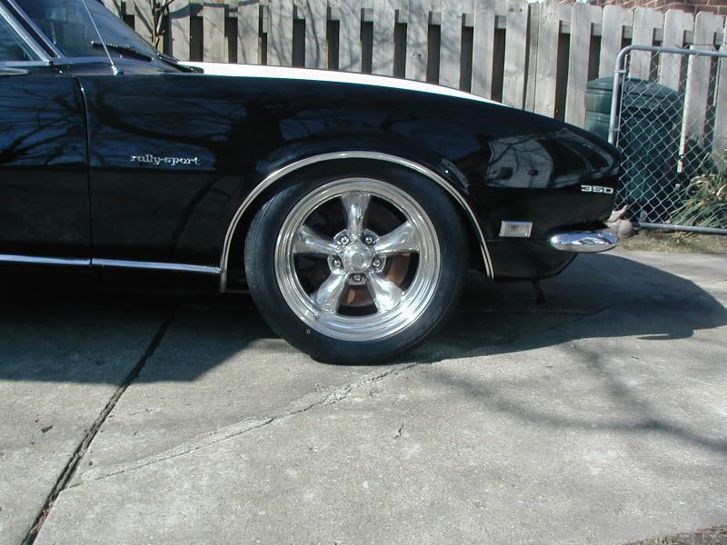

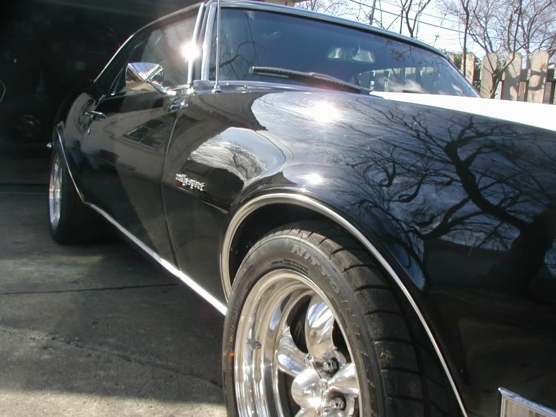

http://i25.photobucket.com/albums/c8...e/P1010001.jpg
http://i25.photobucket.com/albums/c8...P1010004-1.jpg
Fastbowtie 04-03-2009 09:34 PM
DSE Success!!!
OK OK, I was wrong I owe Kyle, Stacy, and Dan and appolgy for doubting them. The car is now sitting correct. The springs look like their dropping already after a quick ride with my 2 buddies and myself. I will post pics after the washing and the quick drive before I go to alignment shop. Thanks again for everybodys help!

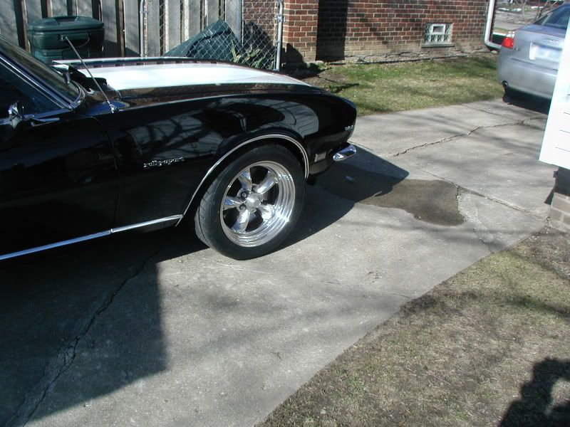

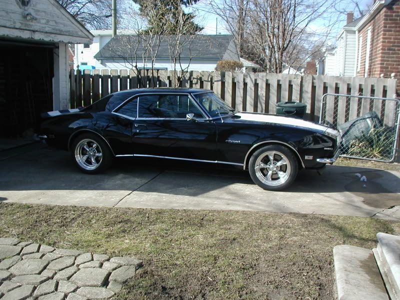

Fastbowtie 04-09-2009 04:45 AM
DSE Springs Installed
OK, I expect it to drop more. I have about 100 miles on them right now.
http://i25.photobucket.com/albums/c8...e/P1010002.jpg
http://i25.photobucket.com/albums/c8...e/P1010009.jpg
Before
http://i25.photobucket.com/albums/c8...e/P1010042.jpg
After
http://i25.photobucket.com/albums/c8...e/P1010010.jpg
