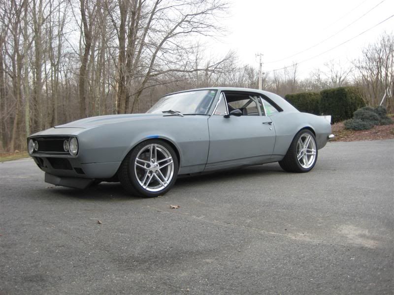

You are not going to need much spacer, on a stock subframe 1/2" spacer works with c6z06 wheels on a 67-68 camaro. Believe it or not. Reason? backspace/offset is different from c6 wheels, the hub to hub width on a c6 and c6z is the same, the wide body and wide stance of the z06 is done with wider fenders and wider rims offset to the outside.
68sixspeed 06-04-2009 05:22 PM
Here are pics of c6 z06 rims on Randy (ProBell)'s 67; stock subframe, 1/2" spacers f/r, rolled fender lips. The tires are really pushed out on his car, on a 69 you may not want as much spacer. In a shameless plug, they are my spare rims for the z06 (changed to chrome), these polished ones are for sale $1500 w/75-80% tread left. -Dan

randys(probell) front subframe may not be a "aftermarket" piece but its been altered... so thats not really a good example.
http://www.cardomain.com/ride/2565383
68sixspeed 06-05-2009 02:15 PM
as of taking that picture, the track width was stock, stock spindles with alum hubs (not the current big pin setup), stock subframe was not notched. I put them on my car to verify the tie rod and sway bar cleared and global west lower arms too. They are no different in width than the 285/17's CarlC runs.
