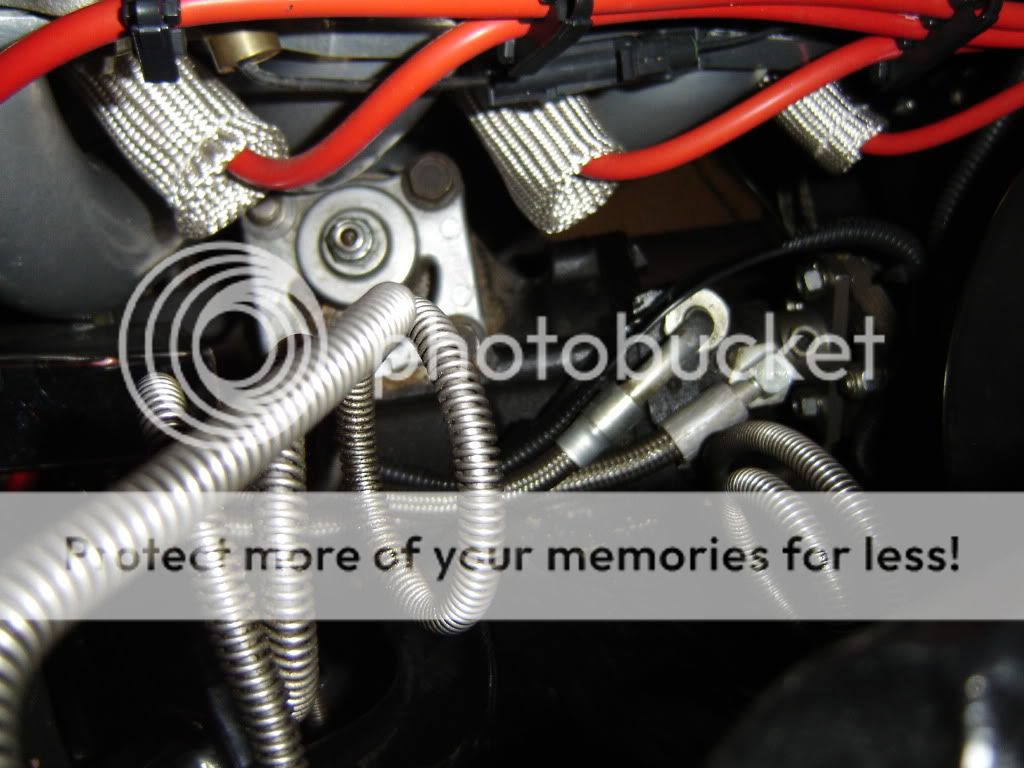

http://i1009.photobucket.com/albums/...headers003.jpg
http://i1009.photobucket.com/albums/...header2001.jpg
