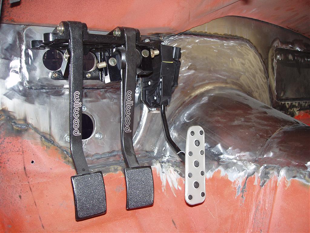

Tom Fuehrer 09-10-2009 09:46 AM

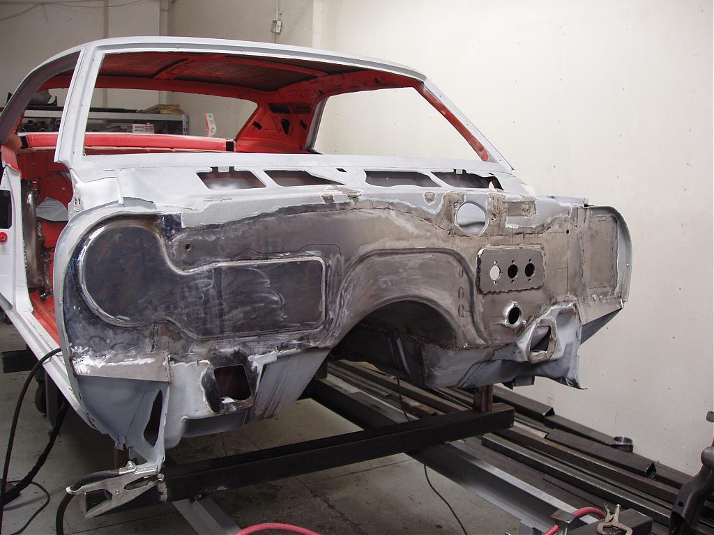

Outstanding start. I really like the firewall - not too flat.
Do you have any more pictures of the brake/clutch pedal mounting? Did you need to add metal to reinforce the firewall?

We machined a 1/4 inch thk plate to mount master cylinders on the firewall with a radius.. then we fabricated support bars that ties pedal assembly to underdash structure into steering column drop.. I will post pics later this week when I get the car back from plumbing

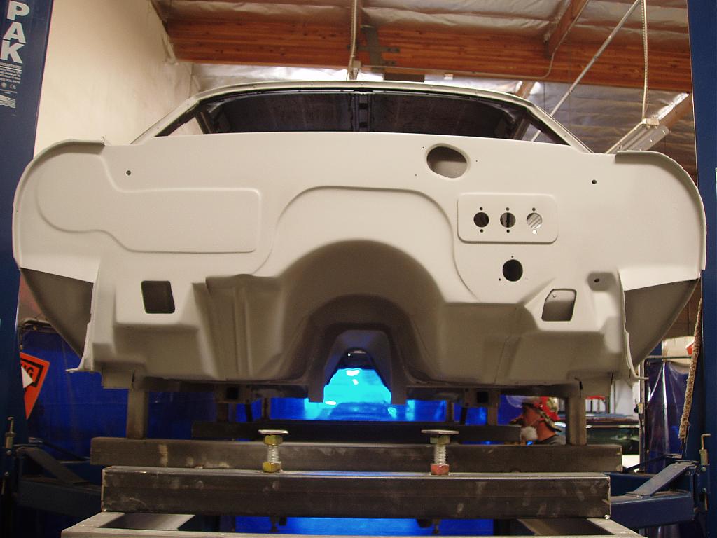

We wanted to try something different on this build with trying to keep away from a flat firewall.. The center recessed section was something that I got from the Kyle B car that Detroit Speed is currently building... The pass side of the firewall is a heater delete plate I got from Detroit Speed & worked it into the firewall.. Driver side master cylinder plate is machined in house.. I will get pics of the machined cage nut covers, steering column cover & coil pack reloction mounts this week!
