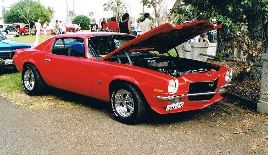

I know its not exactly what your after but my 71 in OZ has 295/50/15 on rear with no mods at all. 10inch rim .
http://i221.photobucket.com/albums/d...pper/001-3.jpg
donaz 09-19-2009 10:18 AM
nice look "back in the day" as they say. Nothing like Cragars and T/A's. If you were to lower that stance 2" in the back those tires would become shredded wheat in about 50 feet. Been there....done that! Maybe a 285/35/18 on a 9.5 will have to do
usa-69z 09-19-2009 03:54 PM
yea this car is 'old school' i since have sold it . It had a bit of rub on the big hits:rofl:
