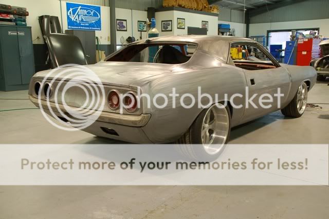

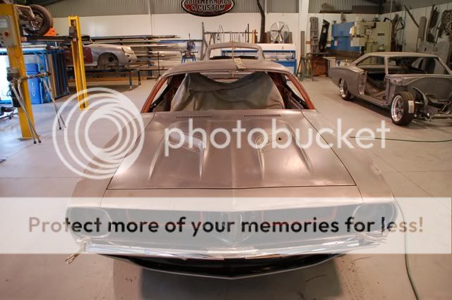

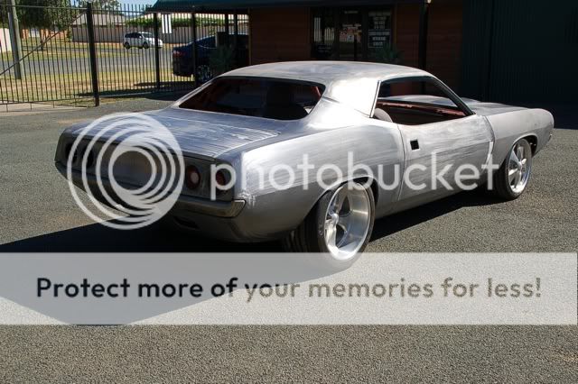

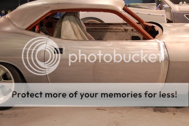

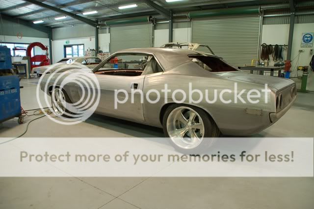

Here's a 72 cuda ,in the build at the moment,Xv motorsports front end,our own 4 bar and whats link,604 cube,kinsler injected Ray Barton built Hemi,19 inch Budniks, 345 rear tyres and on and on.
http://i492.photobucket.com/albums/r...cture021-2.jpg
http://i492.photobucket.com/albums/r...cture020-2.jpg
http://i492.photobucket.com/albums/r...cture016-2.jpg
http://i492.photobucket.com/albums/r...cture019-2.jpg
http://i492.photobucket.com/albums/r...cture031-2.jpg
Southrod 09-28-2009 02:48 PM
http://i492.photobucket.com/albums/r...cture032-1.jpg
http://i492.photobucket.com/albums/r...icturec029.jpg
http://i492.photobucket.com/albums/r...Picture046.jpg
http://i492.photobucket.com/albums/r...cture031-1.jpg
http://i492.photobucket.com/albums/r...Picture050.jpg

Nice build. Do you have any pictures of the wheel tub work to fit the 345s? Specifically did you notch the frame and did you have to do any "stretching" to the outer wheel well? No doubt a mini tub or tub job, but I know the e-body outer wheel wells pinch down quite a bit. I'm building a Challenger and have been looking at my options to get it low with a large tire also.
Thanks, Wes
Sorry I missed this question,we moved the tub against the rail and massaged the inner part of the outer tub half,which was easy to do while we had the quarter off,no problems with the 345 still has about 1.5 inchs of room on the inside.
Shane.
MoparCar 10-06-2009 04:53 PM
Shane.
Shane,
Thanks-so no notch and do you have any specifics on the "massaged" outer half. Big hammer work or an english wheel and nice curved sections?
Thanks! Wes

Southrod 10-20-2009 07:12 PM
Originally Posted by MoparCar (Post 239130)
Shane,
Thanks! Wes
No notch in the rails as it is going to be a real world driver,rather than a super low profiler,we just rewoked the wheel house on the english wheel and plannishing hammer till we were happy with the clearance.
Shane.

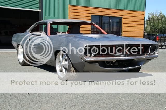

Southrod 12-26-2009 02:37 PM
update
Been a while since I posted a update on this,as weve so busy with other projects trying to get ready for our show season.

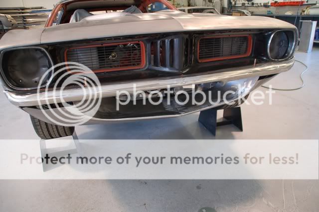

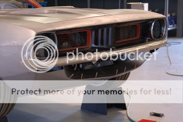

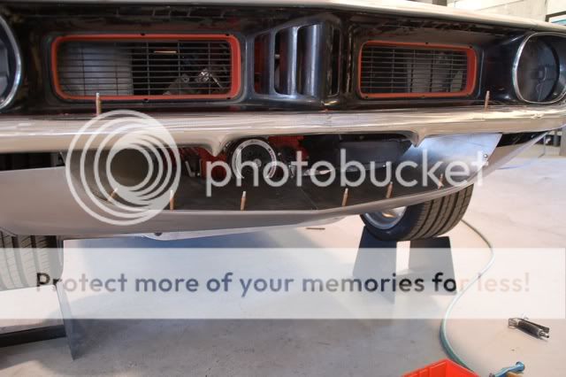

Weve tightened all teh gaps up to the point were we are happy,we,ve fabbed up a front "mouth" and modded a 69 camaro front bumper to fit (yes I know been done before) next up is to finish the engine bay,radiator etc and then the brake system steering etc.
http://i492.photobucket.com/albums/r...a/DSC_5203.jpg
http://i492.photobucket.com/albums/r...a/DSC_5209.jpg
http://i492.photobucket.com/albums/r...a/DSC_5265.jpg
http://i492.photobucket.com/albums/r...a/DSC_5273.jpg
http://i492.photobucket.com/albums/r...a/DSC_5278.jpg
Southrod 12-26-2009 02:40 PM
http://i492.photobucket.com/albums/r...a/DSC_5292.jpg
http://i492.photobucket.com/albums/r...a/DSC_5293.jpg
http://i492.photobucket.com/albums/r...a/DSC_5298.jpg
http://i492.photobucket.com/albums/r...a/DSC_5301.jpg
http://i492.photobucket.com/albums/r...a/DSC_5302.jpg
http://i492.photobucket.com/albums/r...a/DSC_5304.jpg
